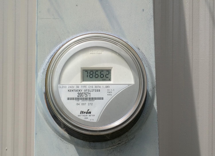

This is a typical rectangular electric meter provided by the electrical utility. It’s shape suggests a 200 amp service. It is properly secured to the electrical pole.

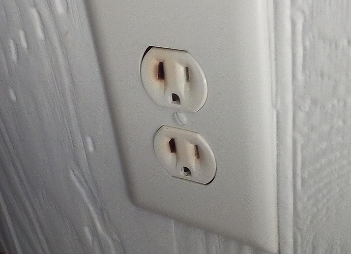

During this inspection I noted a receptacle with evidence of charring. A certified electrician should be consulted to replace this receptacle as it could now be faulty.

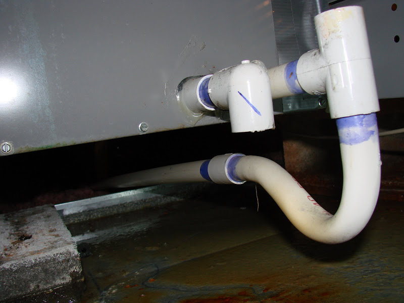

For full disclosure, this is not my picture but an identical situation as the one I am wanting to discuss. I was unable to take a picture myself but my hvac system failed yesterday due to water build up in the pan causing the SafeT switch to kill the system to prevent over flow. There is a good chance insulation or algae has clogged the drain line. As an inspector, I would note that the pan has been holding standing water and should be evaluated by a licensed hvac tech.

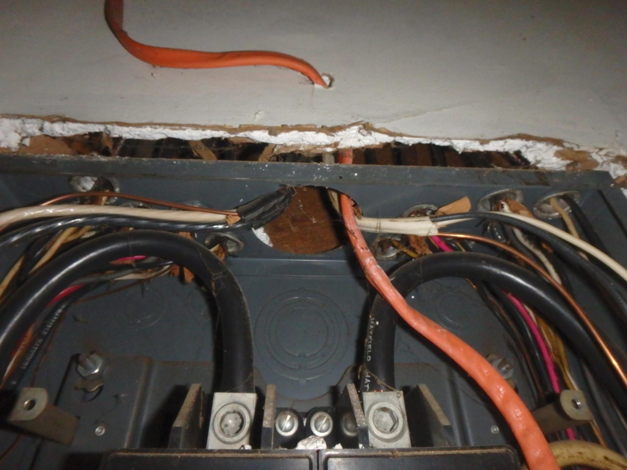

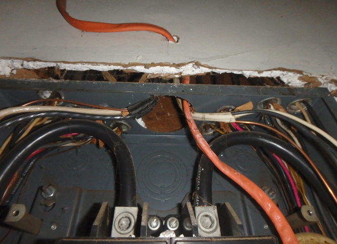

This is a Siemens combination distribution panel located on the east wall of a basement utility/storage room. The panel uses breakers & numerous 240-volt, 120-volt & multi-wire branch circuits can be seen. There is also an AFCI breaker. One obvious condition in this photo, which is a safety hazard, is the opening in the panel.
Visible conductors are non-metallic sheathed cable & the service entrance cables enter the building through the concrete foundation just above the panel. This home has apparent 200 amp service.

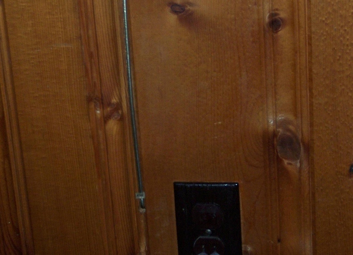

Speaker wire to switch controlling overhead light
https://www.nachi.org/forum/attachments/f25/141593d1466616211-perform-residential-electrical-inspections-main-service-old-part-house-003.jpg

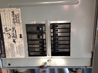

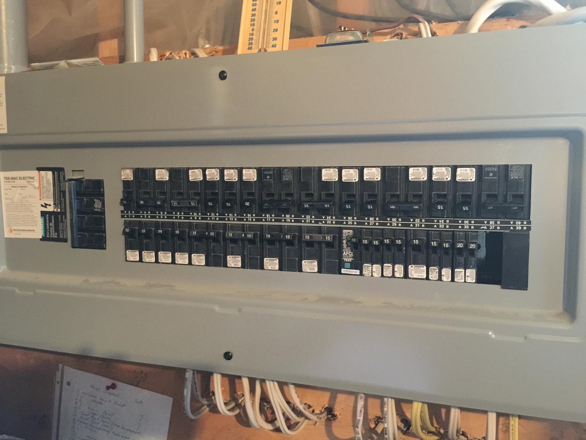

This panel seems to be OK overall, but a couple of minor issues. The screw is hardly screwed in, just seems to be more so of laziness rather than a problem. The labeling doesn’t seem to be great, it seems all breakers are not labeled on the ledger.

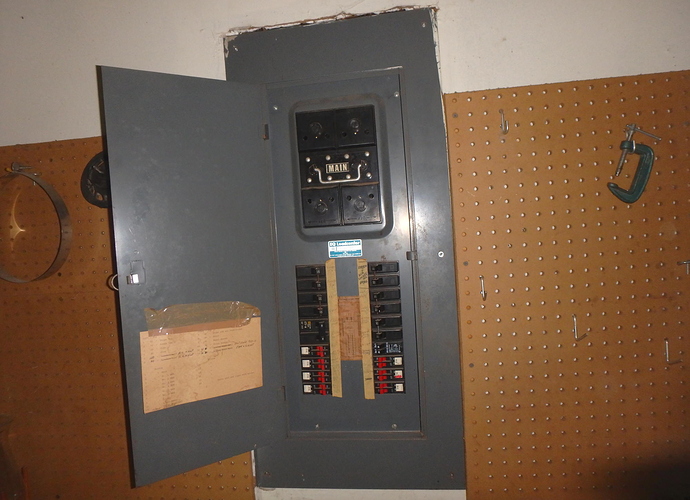

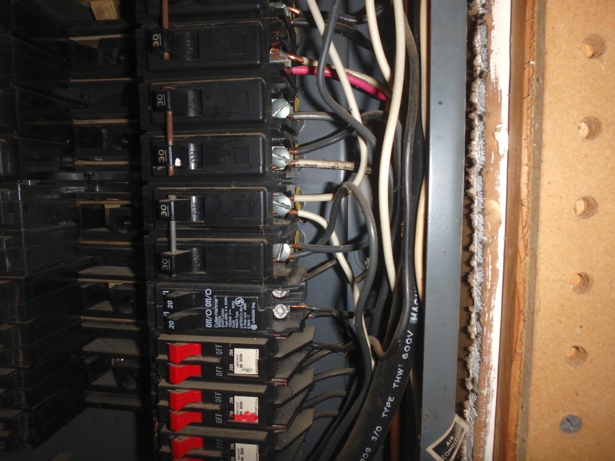

This panel is from an older home which my client was purchasing as an investment property. This panel has several issues.
There are nails holding the 220 breakers. This is not an acceptable breaker tie.
There are several breakers which have been double lugged.
There are missing bushings missing with wires run through the holes with exposed sharp edges.
The main disconnect is an older pull type.
Recommended further review by a licensed electrician for this panel.
