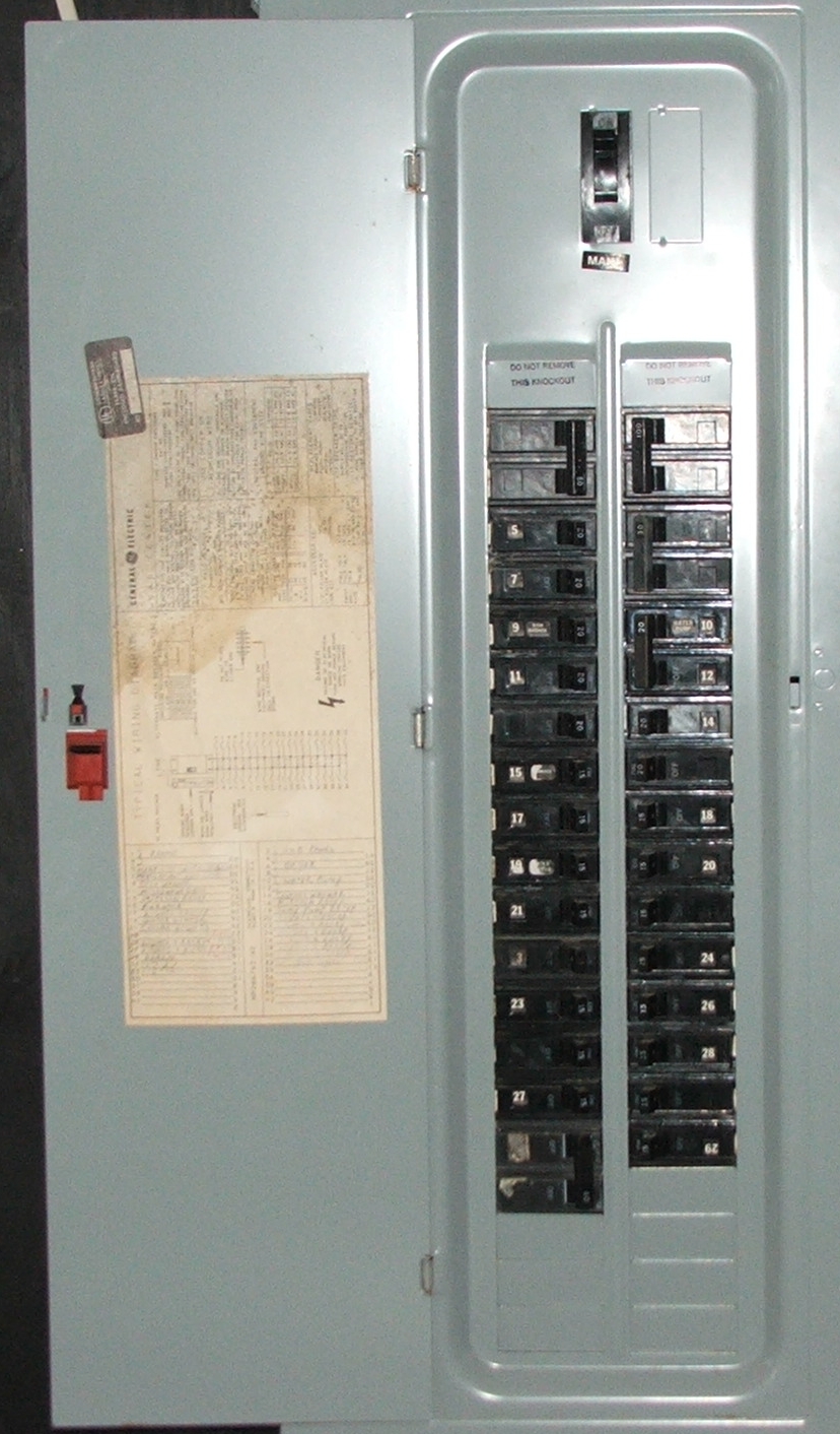

100 amp service #2 Al
30 amp 30 amp double 10 awg copper x2 40 amp 40 amp dble #8 awg
15 amp 15 amp double 12 awg copper x2 30 30 dble 10 awg
15 amp 15 amp dbl 12 awg x2 30 30 dble #10 awg copper
This panel continues with corresponding correct conductor sizes and accompanying breakers.
Loose connections can cause electrical wiring and devices to heat up and cause an electrical fire. Safe and secure electrical connections are important. Properly sized electrical wire and the properly sized circuit breakers connected to the wires are very important. A loose connection can lead to a fire and or electrocution. The panel that I inspected in my apartment was wired correctly. The service conductors and the corresponding conductors and circuit breakers were all wired with with appropriate conductors and breakers.
