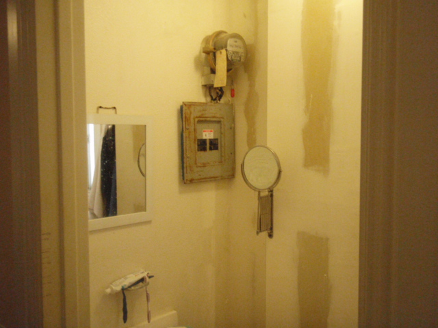

I have been a full time home inspector for 20+ years and an active general contractor before that.
Recently, I saw eight electrical services located in perhaps the most dangerous locations I have ever seen – the meters and service panels were located in bathrooms, within reach of the bathroom sinks. The main building electrical ground was only via cold water. There was no secondary ground. There was no bond wire between the hot-cold-gas line at the water heater.
So if one were to place one hand on the faucet and place the other on the service entrance panel, a dead short of stray voltages to ground could easily pass through the person’s heart potentially resulting in electrocution.
I noted the dangerous locations (8 units) in my report and recommend a complete electrical system evaluation by a licensed and bonded electrical contractor, noting also that the meter and service panels would need to be relocated to a safe and utility approved new location. The listing and selling agents had left the scene so I could only verbally report the facts to the buyer.
To make the condition even more dangerous, the conductors between the original 1920s meter base and the service panel were original, badly frayed, cloth-covered wire with no bond whatsoever between the meter base and the service panel.
To make matters even worse, phase A and phase B was doubled lugged with two different size wires connecting the two phases of the service panel so that it was a 120 volt only panel and there was no way a good electrical connection could be made between the two conductors and the panel connection, so that a potential fire hazard existed on top of the other things wrong. I did not insert a tester to check voltages between phase A and B, as Standards do not require it.
The individual meter bases were such that one would disconnect power to the apartment were one to remove the meter from the base. There was no way to bypass the meter to change it out.
The service entrance conductors were concealed within conduit from the outside of the building to the back of the meter base, preventing evaluation. There was a single set of service conductors attached to the building that (apparently) terminated at an (unmarked) (240 volt) service disconnect that apparently served all four units in an individual building of the complex. There was no way to trace down the path from the single building service disconnect to any one of the individual services located in each bathroom. In short, this whole scene was a real mess and quite dangerous.
I included multiple photographs of this/these conditions in my report so that there could be no equivocation on anyone’s part, claiming I was exaggerating.
This email is already too long. There are other issues, but I’ll leave it at that. I hope none of you ever come across a service this bad.
