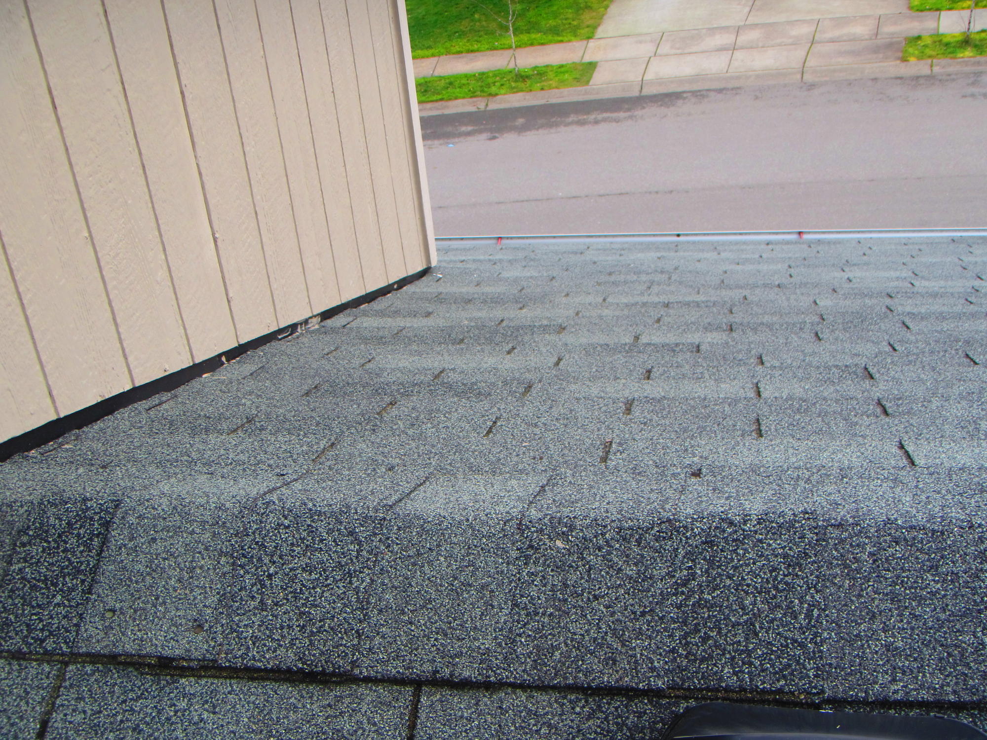

Attached is a picture of the roof over the garage and next to the second story bedrooms. The roofing looks to be in decent shape for a 9 year old roof. The flashing looks to be in good condition. The siding is cut back and does not touch the roof. There is a kick out at the lower edge, by the apron flashing, to ensure that water does not get back up under the siding.

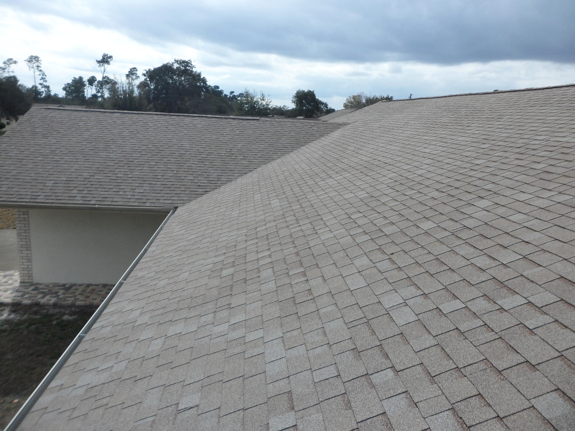

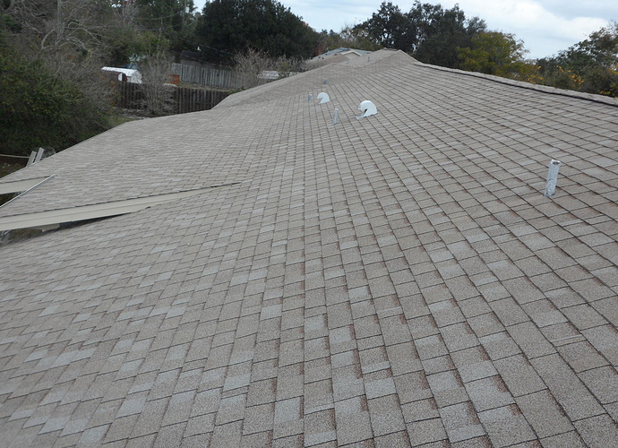

Here are two pictures of the roof covering of my house. These are architectural asphalt shingles, approximately 10 years old. By way of a framing square, torpedo level and tape measure, the house has a 5:12 pitch. The house is gable style, with ridge vents along the whole peak ridge and over the garage with breathable slotted eaves around the whole perimeter. The valleys are interwoven and I can see ends of the flashing emptying into the gutter. All lead boots are secure, as well as the exhaust vents from the kitchen and master bathroom. No problem with the drip edge. No signs of nails popping up and no other kind of defect noted.

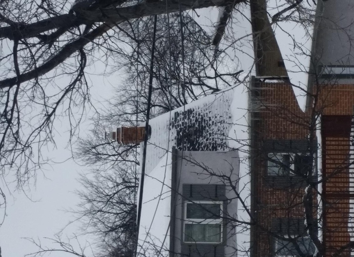

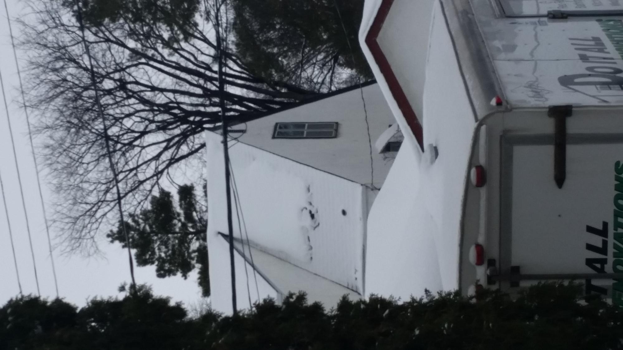

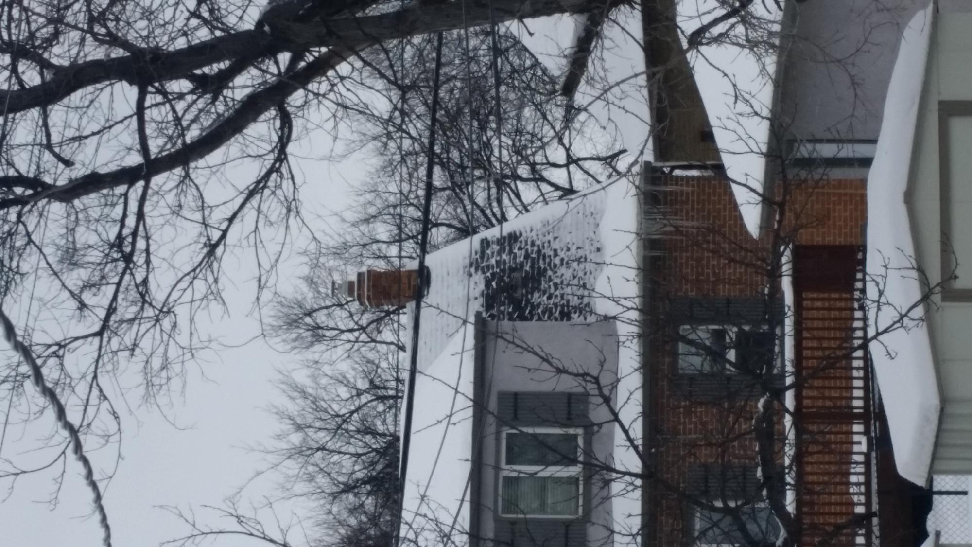

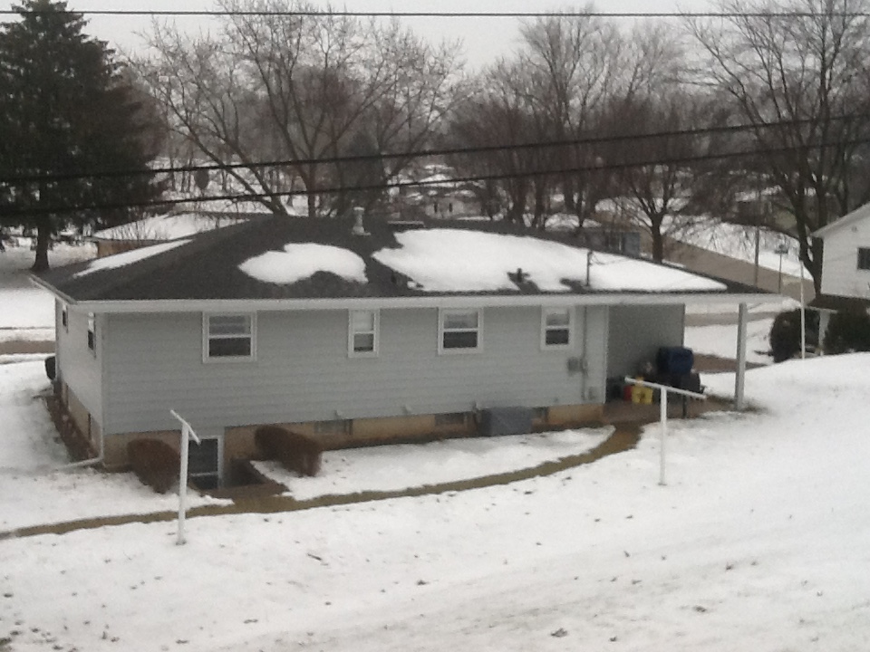

In these photos you can see the difference between these 2 roofs. They are side by side with the same design so it was a perfect way to do an exterior comparison between them. The roof with the layer of snow covering it completely has a total of 3 roof vents. The one with the snow melting has only 2 and on the other side of the roof. I believe this and improper insulation can cause the attic to have a warm spot which melts the snow on the roof.

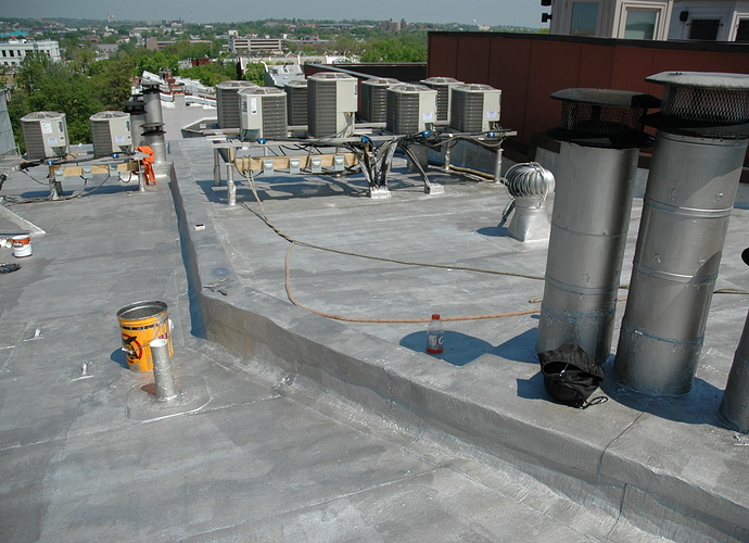

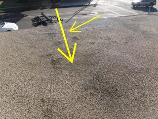

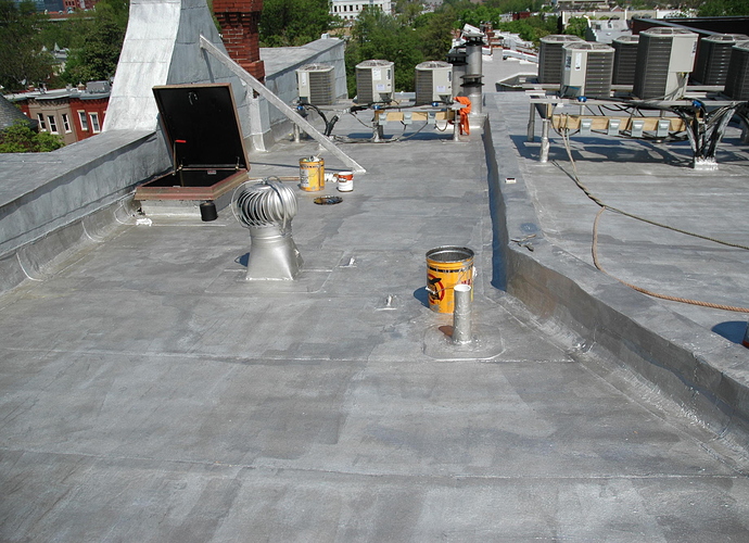

C595FEFE-B356-489B-8F0E-14BCF3C8D161.jpgStanding water was found on the flat roof. It should evaporate within 48 hours after it rains. If standing water remains after 48 hours, then the roof installation is likely substandard. This defect is a defect and conducive to water penetration of the roof and materials and could be very costly to repair. A qualified roofing contractor should evaluate and repair if necessary to prevent prolonged standing water.

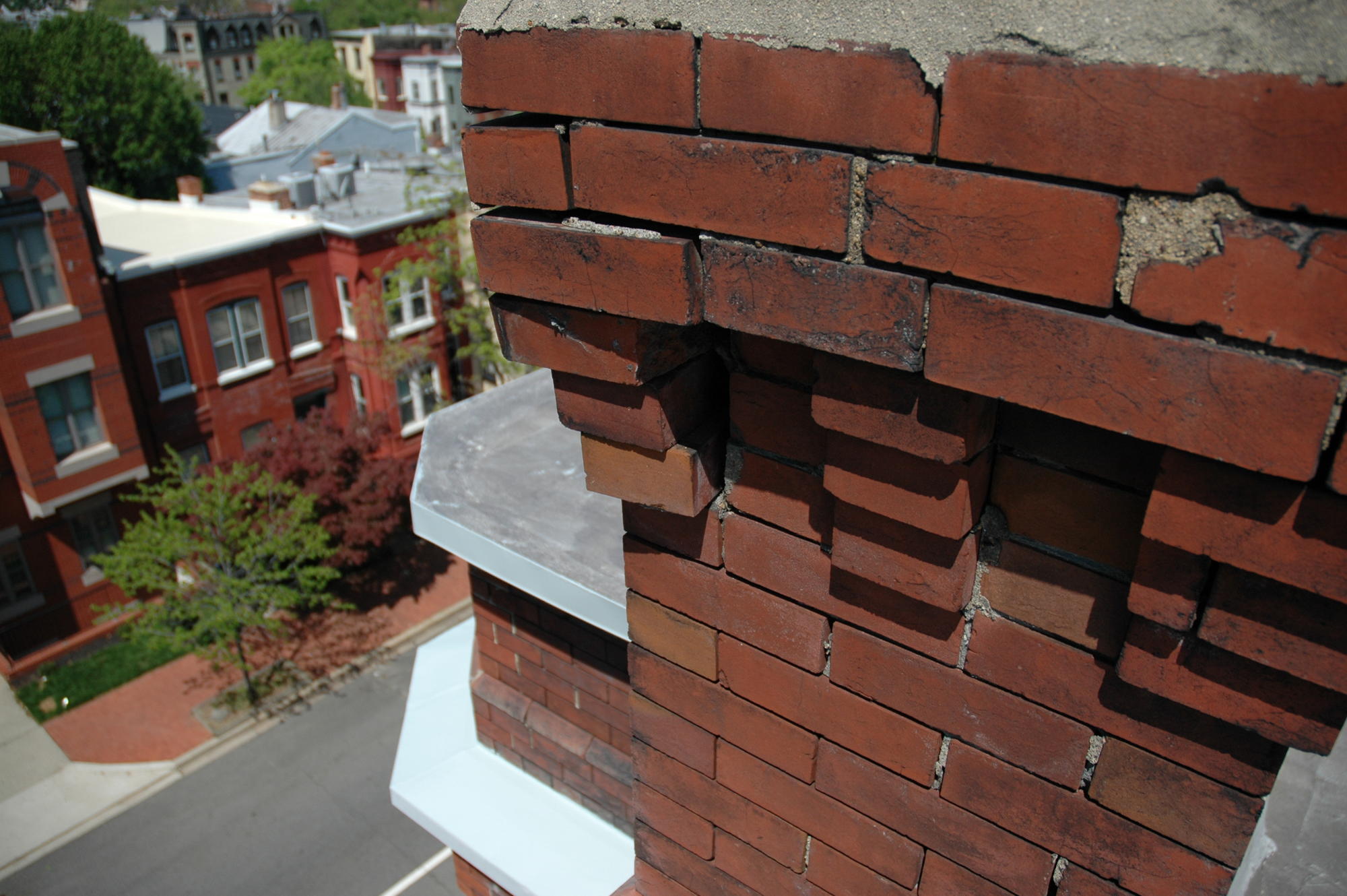

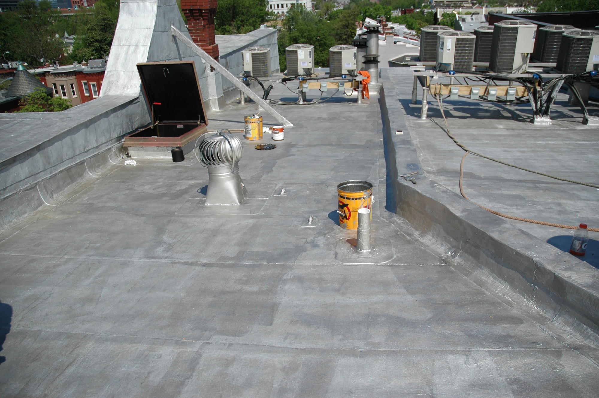

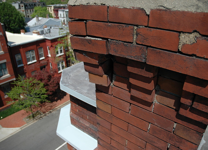

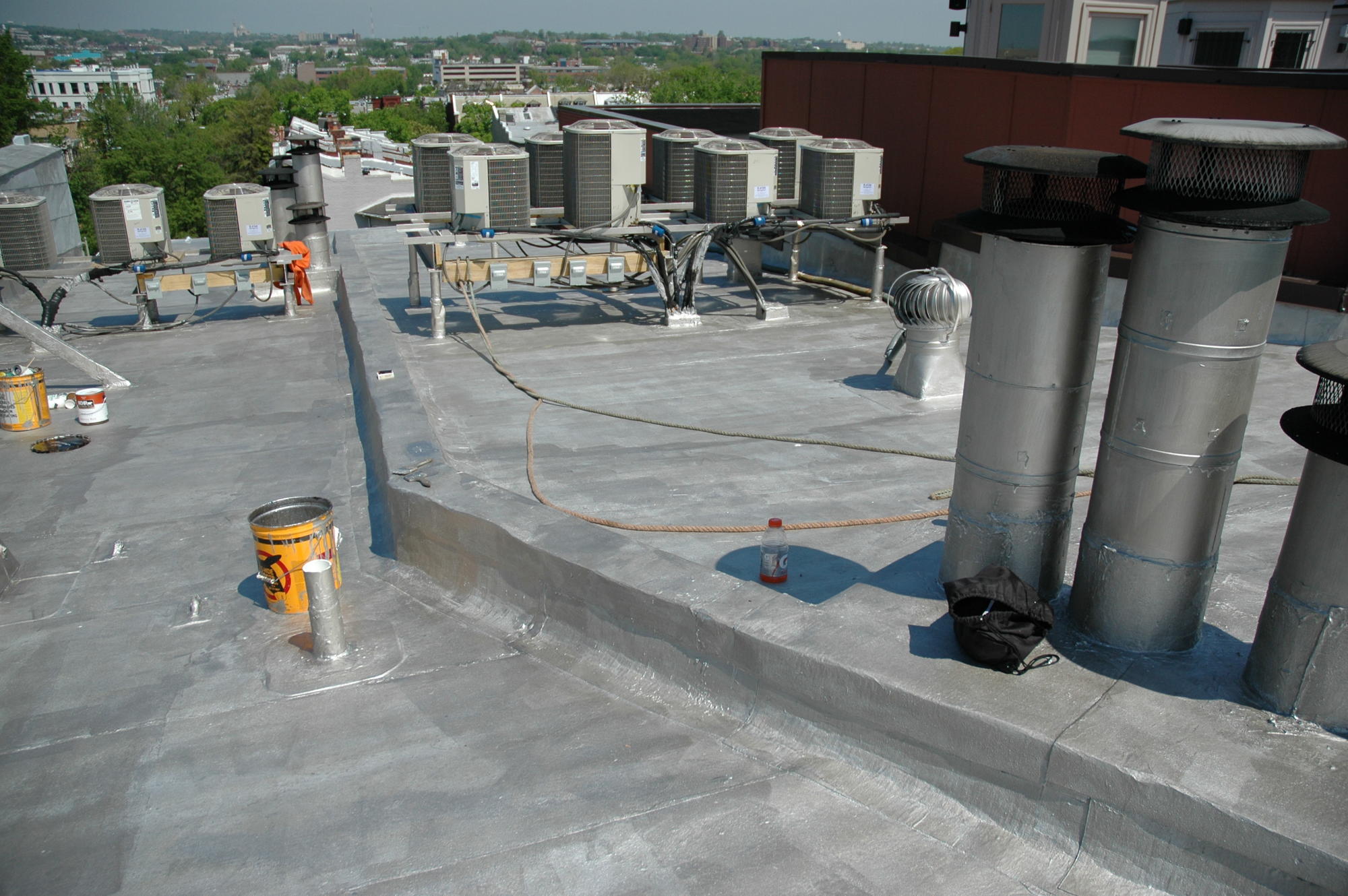

Attached are pictures of a masonry chimney that needs point-up, roof is a rolled torch-on roof with a moderate slope, the roof was replaced, it is new, per manufactures requirements after a period of exposure to natural elements to cure a reflective protection paint was applied.

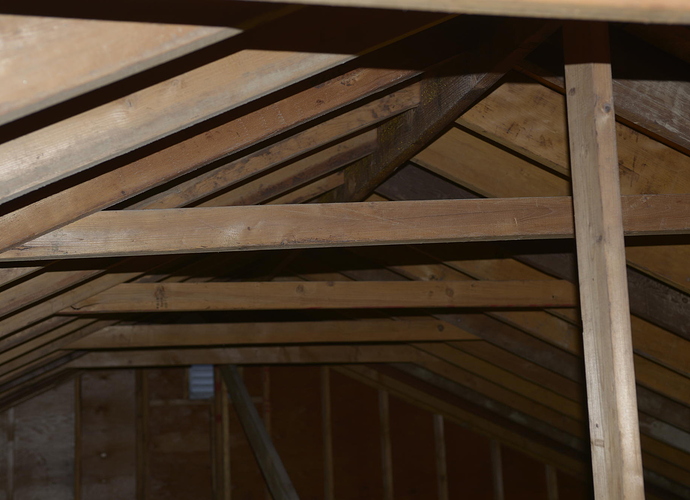

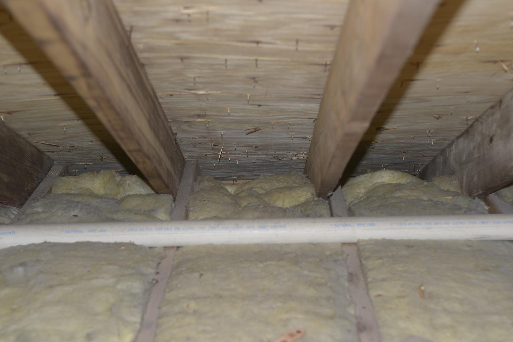

The first picture is taken in the attic. It shows a gable roof with a structural ridge and rafters. Collar ties are place approximately every other rafter, although in some cases they are placed every three rafters. Collar ties should be placed every two rafters to prevent uplift of the roof. The plywood panels are installed with the grain perpendicular to the rafter boards. Although difficult to see, roofing nails fully penetrate the plywood underlayment as is recommended. Also visible is the gable vent which is sized 1 sq ft. per 300 sf of area as is required for a gable vent with soffit vents.

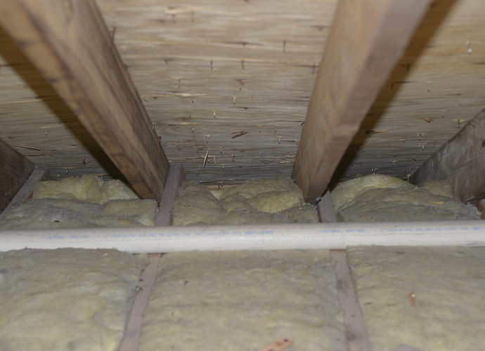

The second picture is of the eaves. Although difficult to see, the insulation has been pulled back from the soffit vents to allow for proper air circulation.

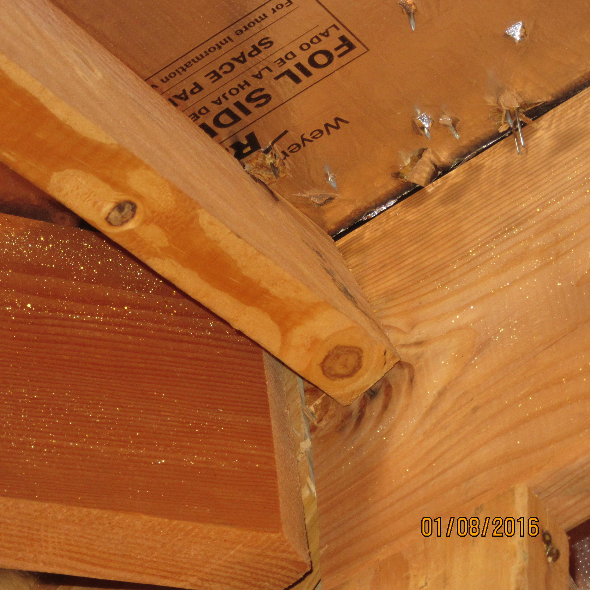

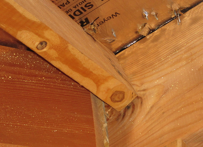

While doing a home warranty inspection I came across areas of significant rafter spreads. The one that struck me the most was this rafter that was warped and not attached to the ridge board like it should. I am finding more and more of these deficiencies on new homes that are built here around the Dallas Texas area. I recommended the client to get with their builder to replace the rafter.

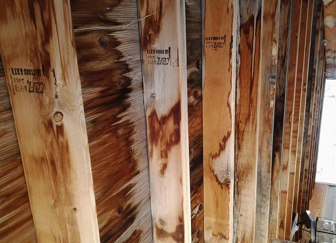

This response is to complete the requirements for the how to inspect the roof course. This image is showing the underside of shed roof belonging to a patio. There is obvious and substantial water damage both to the sheathing as well as strucural lumber. Visully from the ground ssing flashing and improperly fastened metal sheeting arr likely to blame. I would strongly recomend repair both to the roof covering as well as underlyiig sheatingand possibly rafters as well.
