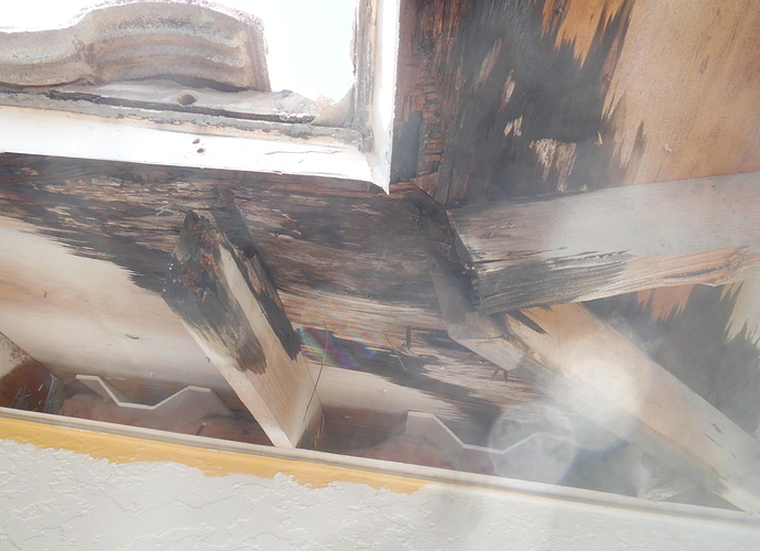

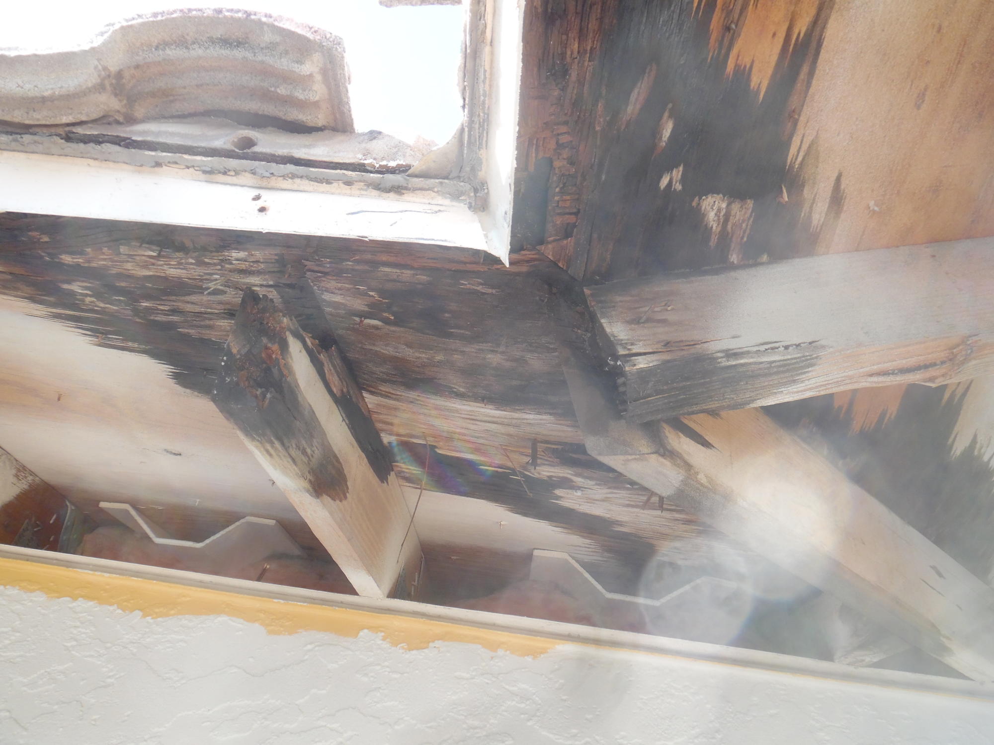

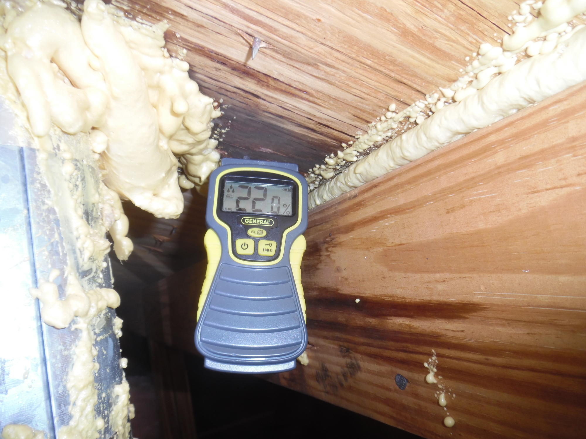

I observed this fascia on the east wall on the north end showing signs of insect damage and flaking paint. The open soffit showed that the underside of the roof sheathing had significant moisture damage. The top plate extension also showed signs of moisture damage. I recommend further evaluation by a qualified roofing contractor.

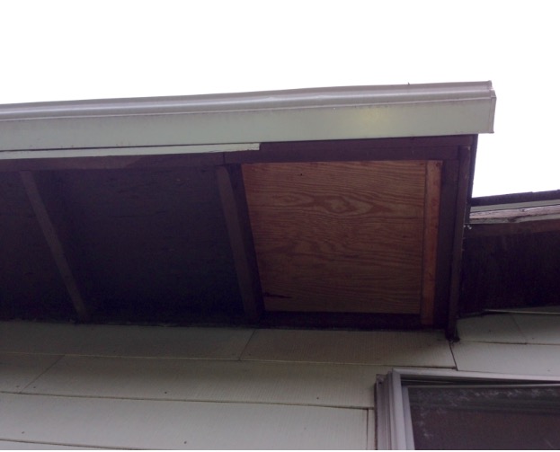

I observed this fascia on the east wall on the south end showing signs of flaking paint. The open soffit showed that the underside of the roof sheathing had been covered with a piece of unpainted plywood and nailed to the 2x6 rafter with an unpainted 2x4. The rest of the exposed underside of the sheathing showed moisture damage. I recommend further evaluation by a qualified roofing contractor.

Moisture intrusion causes property damage through decay, which occurs when moisture levels reach 20% which can be reached with a small trickle. Often this is manifested as drywall ceiling stains or bubbling paint on trim. Structural damage, of course, is more serious and costly than a finish damage, which can be repaired relatively easy. Corrosion of metal fasteners can cause otherwise solid assemblies to fail over time.

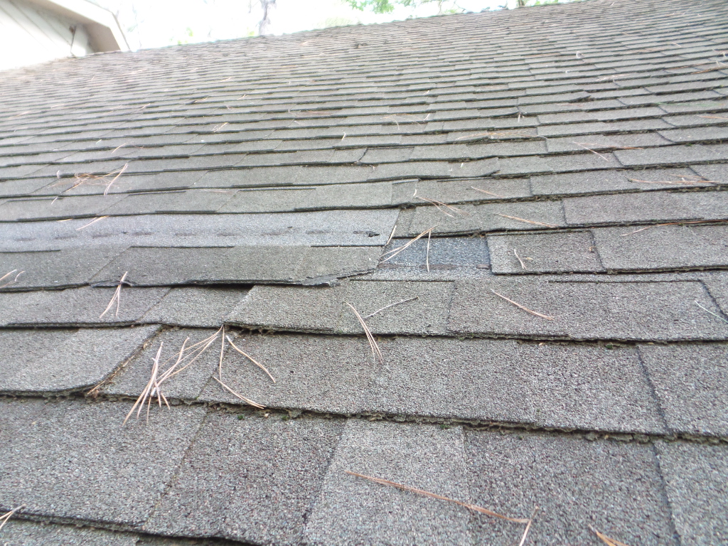

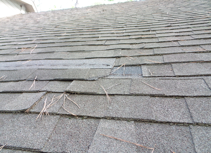

This roof look good overall. I found no leaks in attic. However, there are a few loose shingles that need to be repaired.

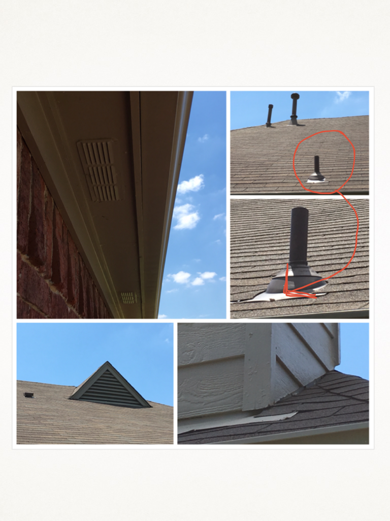

I chose to inspect my own roof on the house that i just recently purchased. The roof is only 8 months old and has only one layer of shingle on it. This is a basic three tap shingle placed on a hip roof. I walked the perimeter of the roof line to check for drip edges. There were none to be found. There are, however, gutters that surround the entire roof line. They were attached properly into the fascia board with no loose brackets. The gutters were clear of any debris and the down spouts directed the water away from the foundation of the home.
I then looked for proper ventilation of the house. You’ll notice in the pictures that there are gable vents as well as soffit vents. This is adequate ventilation for the size of my attic space. I then walked into my attic as it is a walk in style. I could not see any signs of water discoloration on the decking, rafters, or insulation.
Next I began looking at the penetration points through the roof beginning in the attic space. Again I saw no signs of leaks from within the attic. I then moved back outside to look at the same points from the ground level. I noticed the flashing on the chimney looked sufficient but the PVC vent pipe caught my eye. You will notice in the pictures that one faster is raised up from the flashing. Although it has not yet caused any issues I will be fixing it as soon as possible as a preventative measure.
