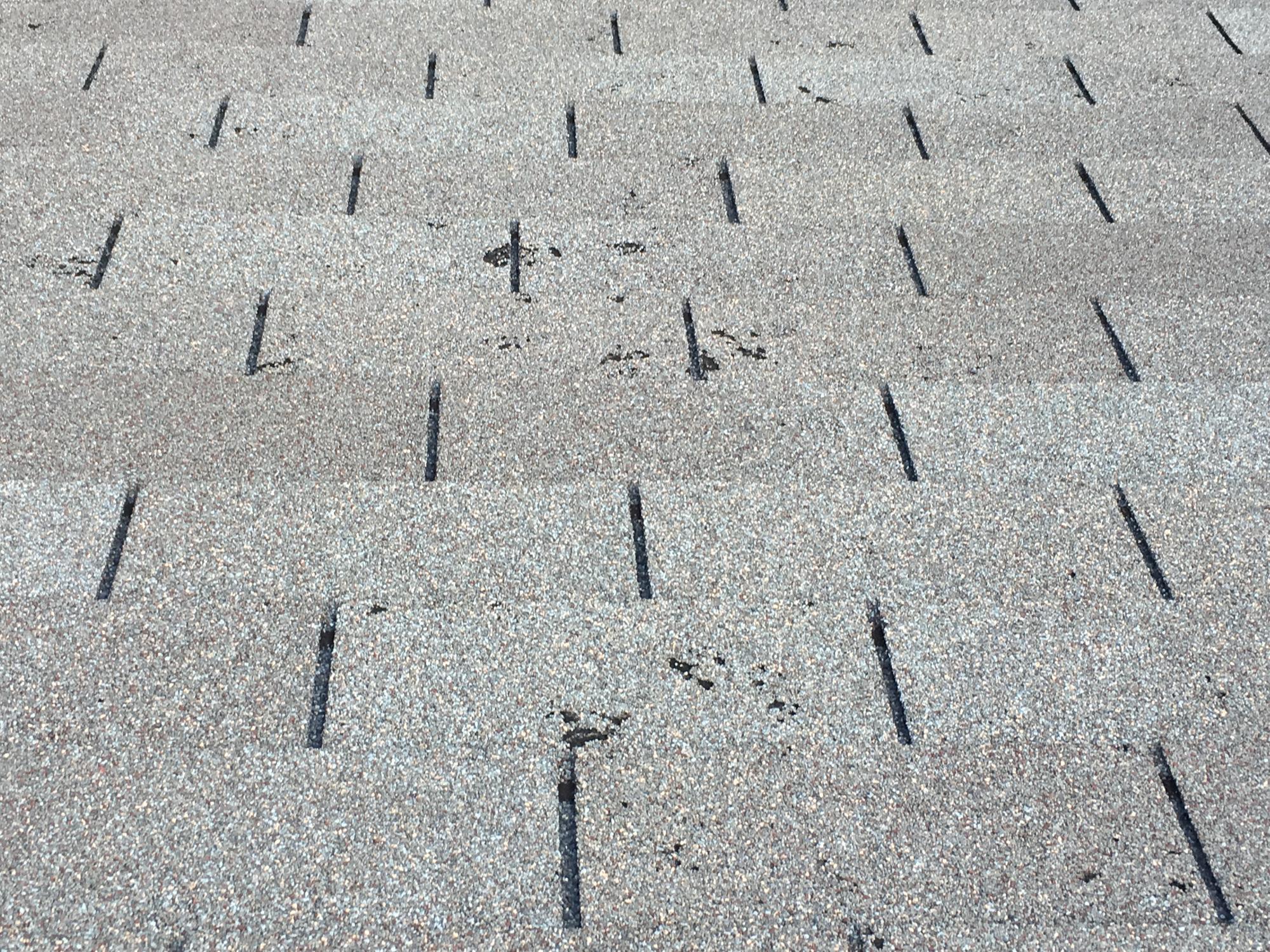

Here are some asphalt shingles that are showing a little granular loss. This is important to note because the granules are first layer of defense against the elements. You can actually see the fiberglass in some of the spots. These shingles should be replaced asap.

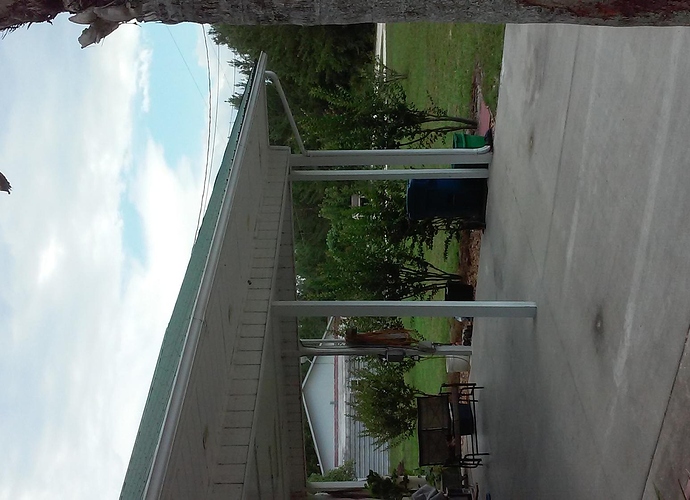

Home has gable roof. The home also has a metal roof gutter at end is in need of repair. Gutter has become detatched at end. Metal roofs have a life expectancy of 17 to 20 years.

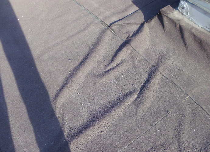

Here’s the roof I just inspected a couple days ago.
This’s a flat roof, single-ply roll roofing. There’s no ponding, no tear and rip,no lap edge lifting, no exposed nail head,no loss of granule. But there’re some blisters on the north side of the roof,around the chimney.

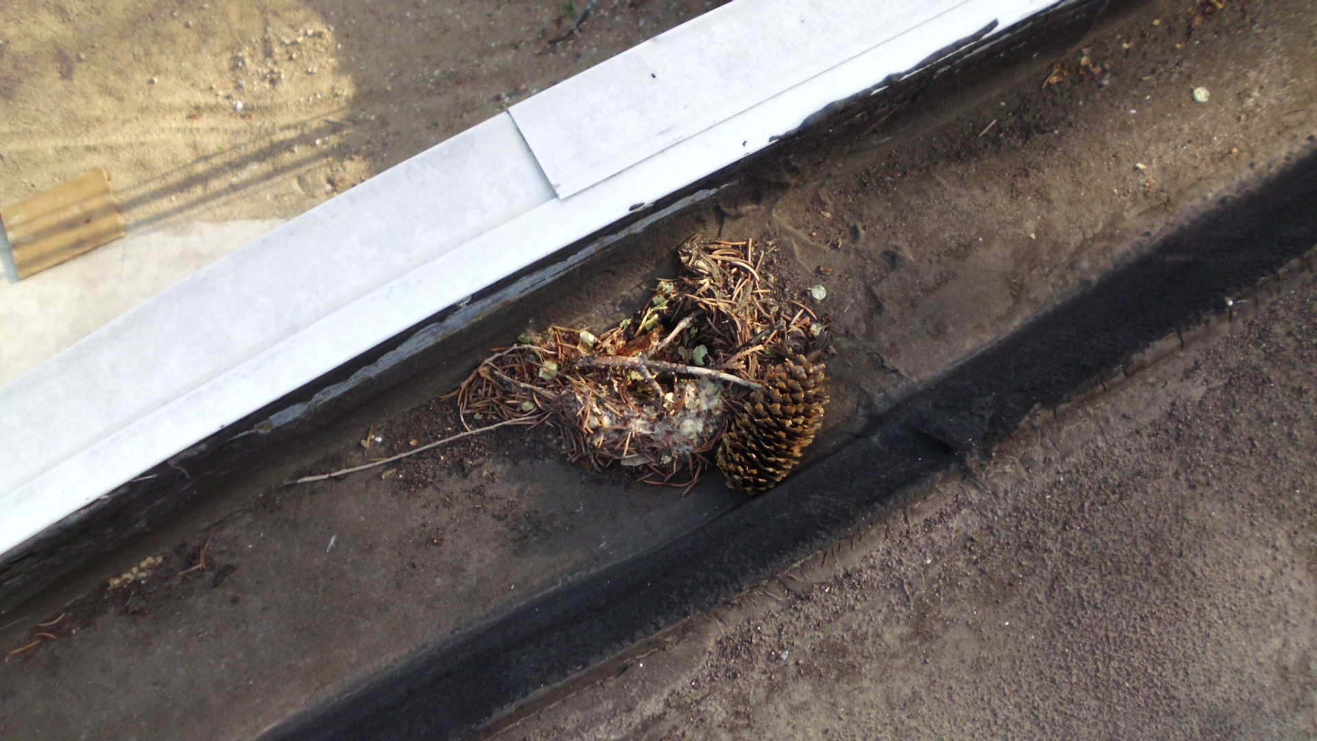

From the photos I pasted you may see the gutter need to be cleaned, the down spout was clogged with leaves.
The penetration/vent looks okay. The flashing was properly installed.

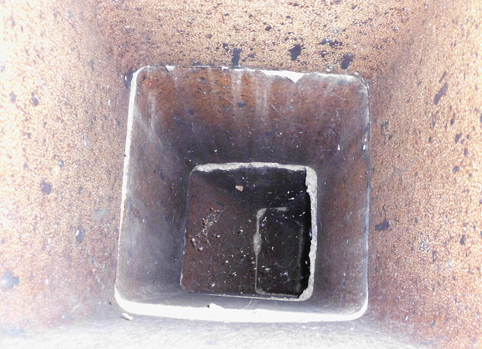

The masonry chimney with crown cap, about 4 feet high, the cap has crackes and broken . The liner looks good.

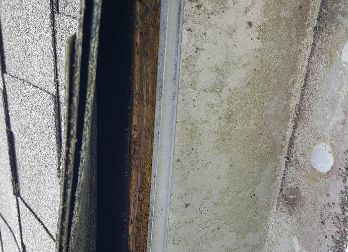

this roof is 5 years old but has a few major issues. It has no drip edge or fire and ice shield which is required. Also is missing flashing in many places. Going to recommend that these issues be addressed by a licensed contractor.

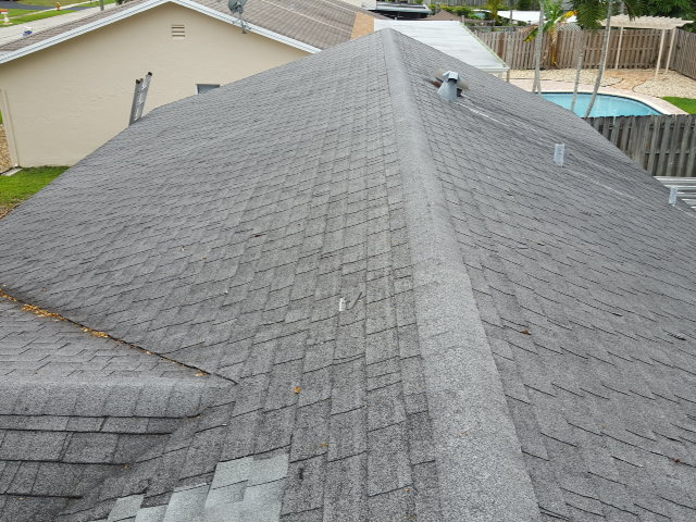

In South Florida shingles roofs don’t last that long due to severe weather conditions during six months of hurricane season. This shingle roof shows a big previous repair above the living room area. The condition of the tabs is poor shows granule loss and shingles are brittle. We can aldo observe rusted flashing at two areas at the eave, drip edge. this roof is from 1994, its supposed to last 30 years, but its has reached much faster the end of its life expectancy.
[ATTACH]PHOTO_20160519_133855.jpg[/ATTACH]

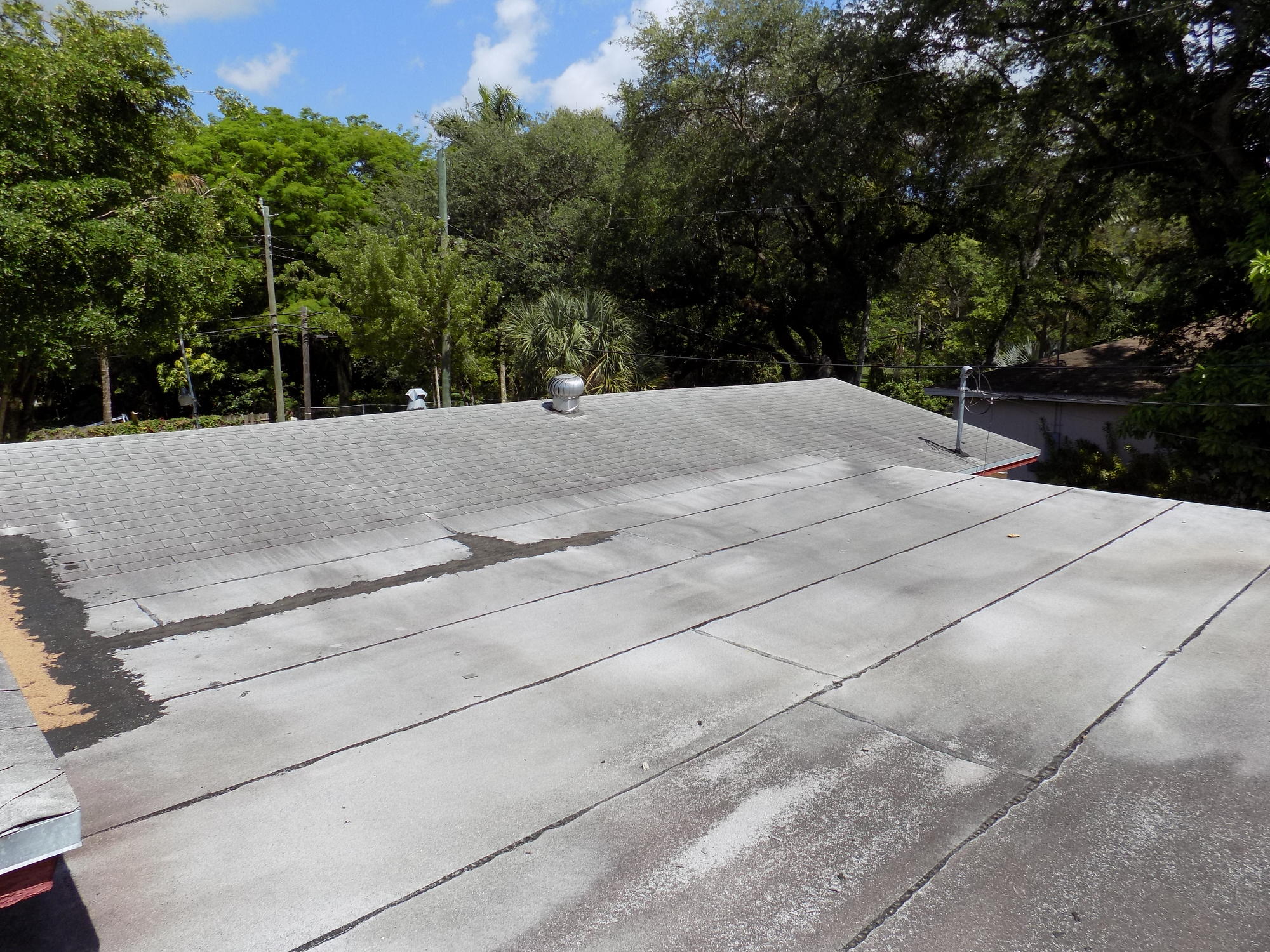

This photo depicts the the meeting of two roof elevations. The first being an architectural shingle that appears in good condition at time of inspection with flat shingles, no exposed fasteners, no cracking and no signs of granular loss. The second roofing material is single ply rolled roofing with no signs of blistering, ponding or loss of adhesion, or granular loss. Step flashing is installed at the wall where the surfaces meet.
