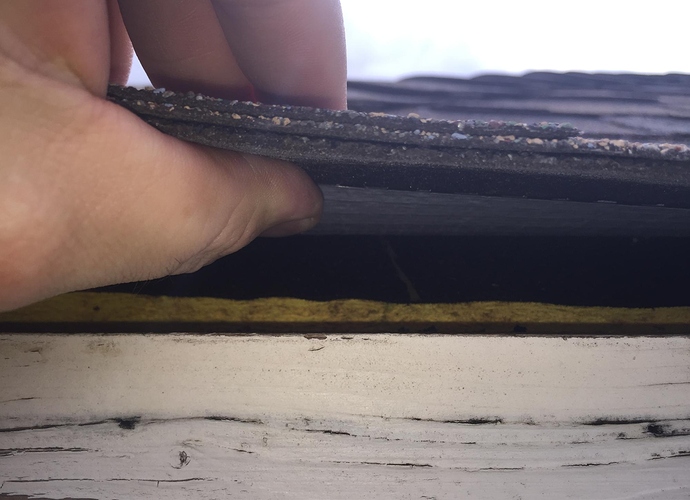

In this picture, it is hard to do a simple inspection of the leading edge of the decking, underlayment, and drip edge due to the 2 inch over hang of the asphalt shingles. Upon closer view, you can see the lack of the drip edge on the decking. Also there does not appear to be any underlayment other than the loose house wrap style material under the shingles. I would consider this a material defect.

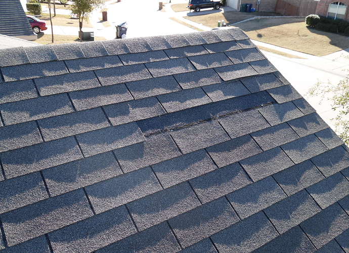

Roof Covering Type: Three-tab asphalt shingles on ¾ inch plywood decking.
Comments: Shingles missing from Southwest facing roof area. Damage from weathering suggests dilapidation including UV and/or wind damage and possibly improper installation or lack of fasteners.
Suggest replacement and repair by a bonded roofing contractor to prevent further water penetration, damage to surrounding shingles from wind and UV damage, and general dilapidation of roof substrate and covering materials.
