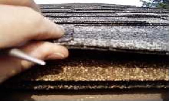

This is a three tab asphalt roof covering placed over an older asphalt roofing material. Although there are only 2 layers I would still note it, including the extra weight load, and do a more extensive inspection of the attic to insure the new roof was fastened correctly. I would be looking particularly for roofing nails to have penetrated the new roof covering, the older roof and the sheathing as well as the flashing to make sure it was installed properly with the new roof covering. The new roofing material appears to be in good shape with most of the granules still attached.

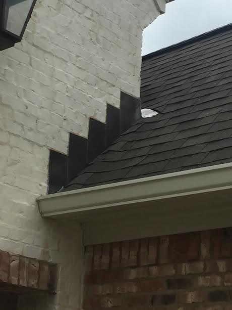

This is an architectural asphalt shingle roof in new condition. The shingles are in good condition with no visible signs of wear or damage. Step flashing is present under the shingle layer and counter flashing is installed. Kick out flashing is missing at the termination of the roof/wall intersection. This is allowing water to pass behind installed gutter system and down face of wall. Note the visible water stain present under gutter.

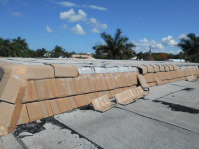

This is an image of a flat roof with concrete tiles wrapped around the outsides of it. As you can see some of the tiles along the upper edge have come loose and fallen off. The roll roofing at the edges where the tiles are missing has lifted and may allow water / moisture intrusion. Large areas of the flat roof also had areas of blistering / bubbling. This roof definitely needs further evaluation by a licensed roofing contractor!

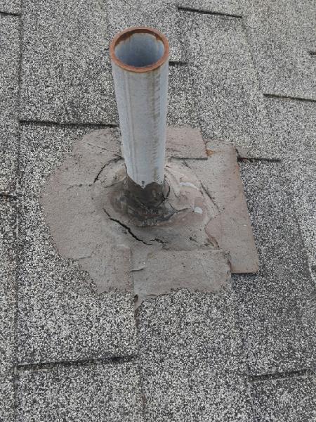

After having performed over 500 full home inspection to date, some patterns emerge. For example, the plumbing vent boots (the neoprene collar which connects the roof flashing to the plumbing vent stack) typically last from 10-15 years in this environment (Willamette valley in Oregon, “Rain capital of the west coast”).
While typical architectural shingles have a 30 year rating (though seldom achieving this).
It stands to reason that these vent boots should be replaced 1 to 2 times during the life of this type of roof covering. The pattern I see is this: A small stain on the ceiling of a bathroom or kitchen appears. The homeowner decides they will save some money and fix this themselves. They buy roofing tar from the local HD and proceed to cover the vent and roofing materials in one foot wide perimeter, hoping to somehow stop the leak. However, the one area they don’t cover is the cracked vent boot, from whence the leak cometh!
If by chance the cracked boot is covered with tar, this repair typically lasts about one season before the tar cracks, the leak reappears and the cycle of life continues…
My advice to all my clients is to hire a licensed and bonded roofing contractor to replace the entire vent boot (along with all his dried up and ready to crack brethren) and then forget about them for the next 10-15 years.

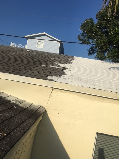

See the attached photo of a standard 3-tab roof. The roof is very weathered and the granules are missing in locations. The photo shows where a section of roof has been patched and a paint roller from the repair work is shown. I suggest a consultation with a licensed roofing contractor.

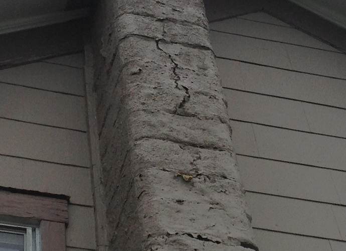

Hello,

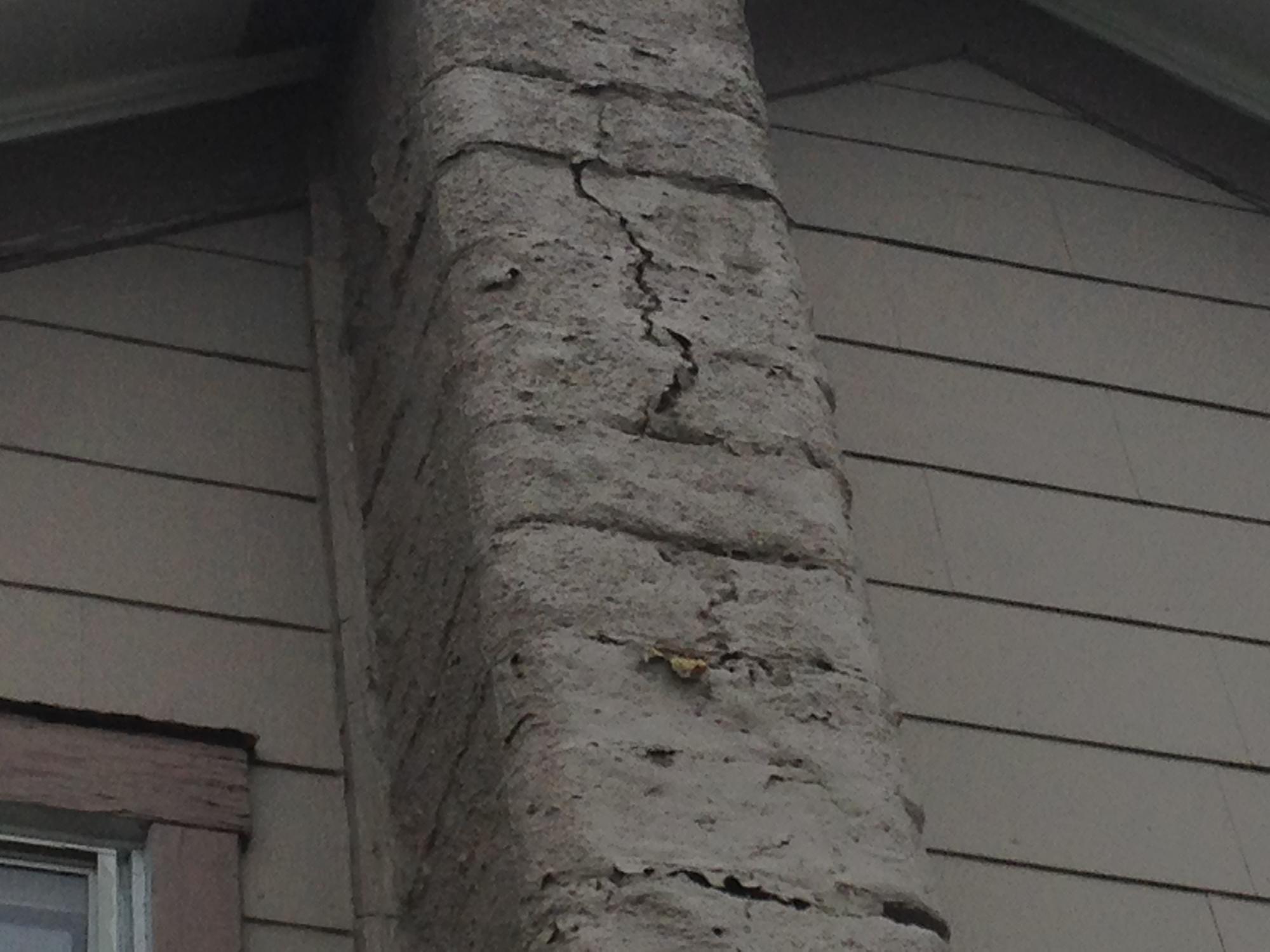

I’m writing about a chimney defect that I found during an inspection. In the photo you can see failing stucco and chimney separation from the house. Also, I found water stains in the attic around the chimney indicating past water stains. I wrote out the report that due to a stucco covering that I could not determine or see the chimney’s condition and I recommended this to be evaluated by a licensed contractor.
Thanks,
Bill

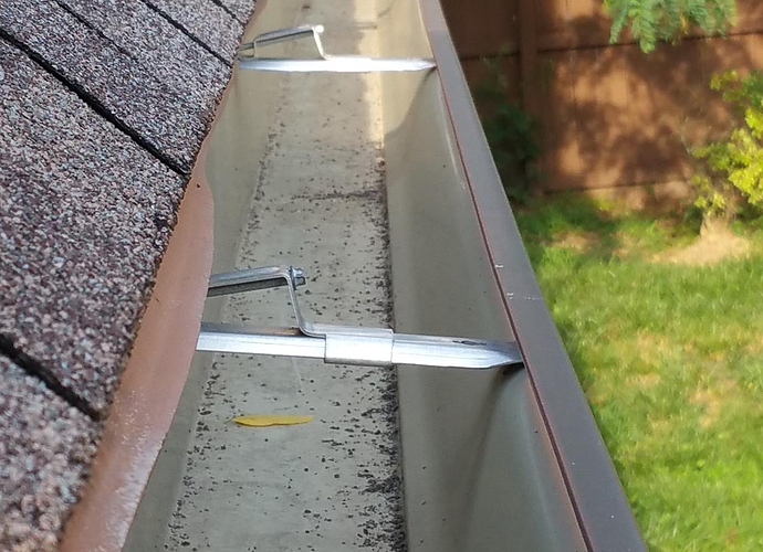

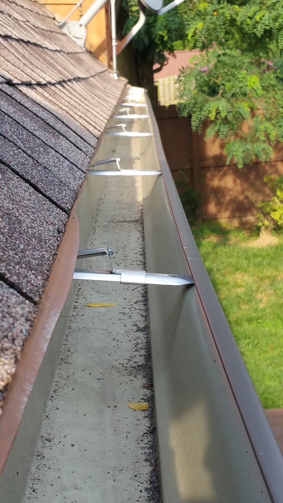

In this photo of the gutter system it shows several sections of the gutter are not secured to the home properly. This can cause inadequate drainage which could result in water damage to the wood trim of the home. I recommend having the entire gutter system repaired or replaced by a certified professional gutter repair person.

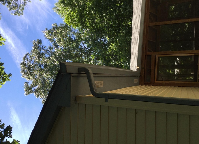

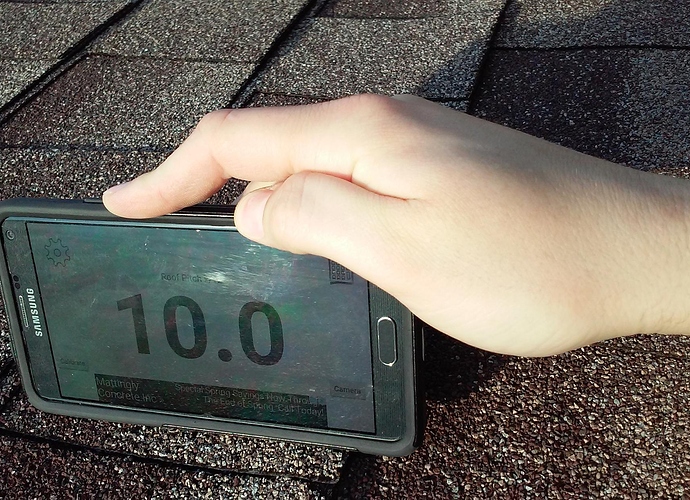

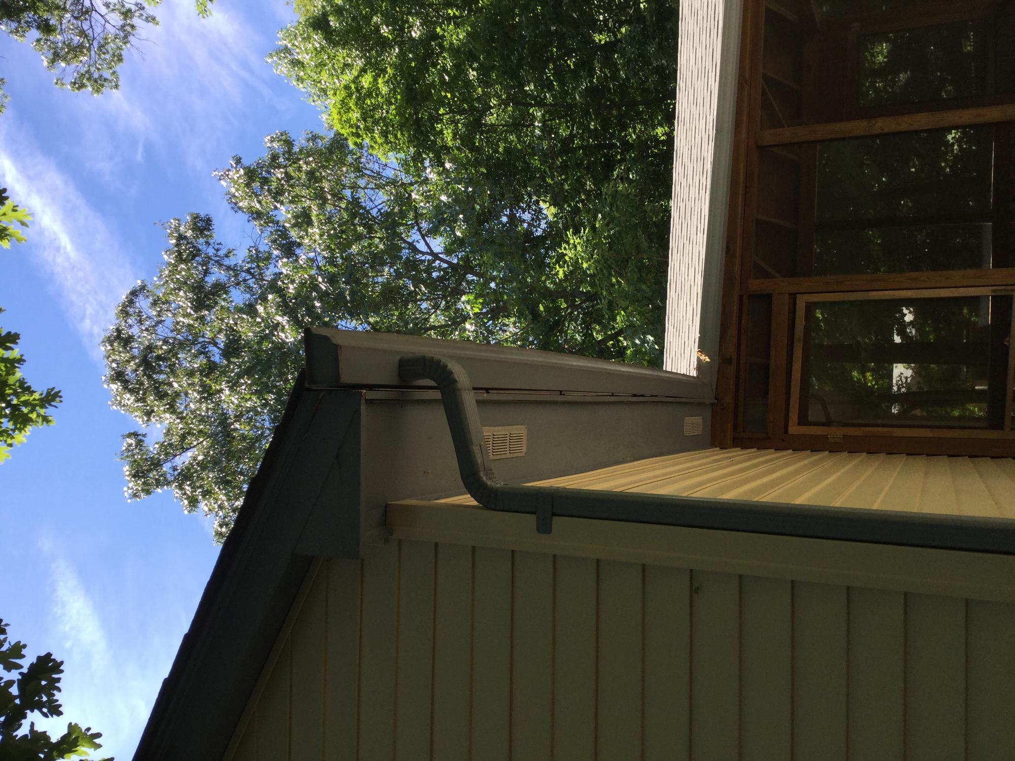

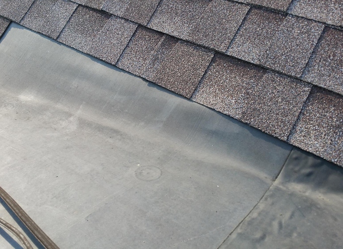

I decided to look at my own roof. Overall my roof looks pretty good. When we purchased the home, the seller’s disclosure stated that the roof had been installed in 2008. The roof has a slope of 10:12.
We have 3-tab asphalt shingles for the majority of the roof. I did however notice that for one portion, connecting the home to the garage, we have membrane roofing installed. It slopes downward and I found no evidence of ponding. Both roofing materials seem to be in good working order.
The gutters were clean. There was a light amount of asphalt shingle aggregate in the gutter. One of the gutter spikes is backed out.
Another issue I noticed was missing flashing around the fireplace. The wood around the base of the fireplace is falling apart.

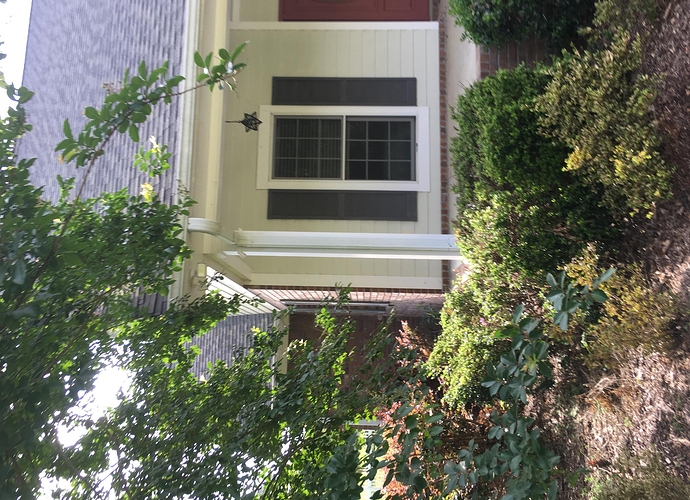

Roofing

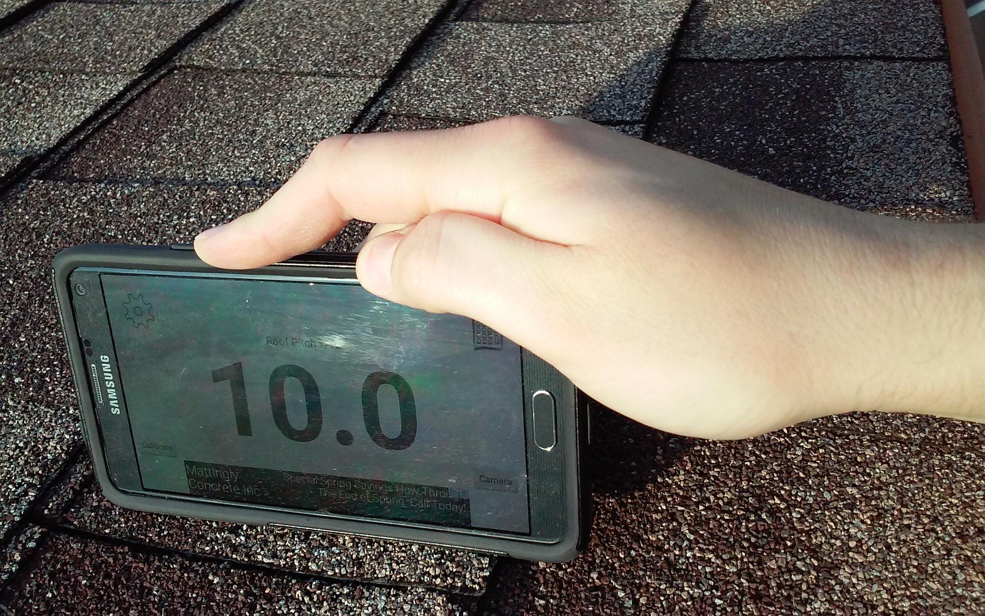

The roof style is side gabled with a pitch of 10/12.
Viewed from the ground level due to the pitch of roof.
Venting: ridge venting, gabled venting, soffit venting
Roof covering is of fiberglass-based asphalt shingles…
Age of roof is 8 years of same age of house.
In general the roof, flashing is not visible for inspection.
There is 1 section where tree branches are against the roof.
PVC vent stacks visibility seen right.
There is no chimney on this house.
Roof drainage aluminum gutters and down spouts discharging water away from foundations.
