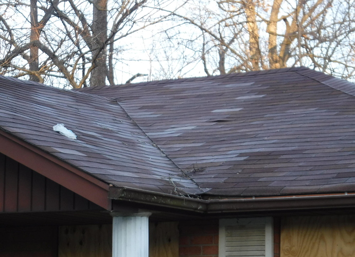

The roof has nail pops which will make the shingles easy to be blown off. The gutter is pulling loose from the house and needs cleaning. The roof covering was getting close to the end of service life.
