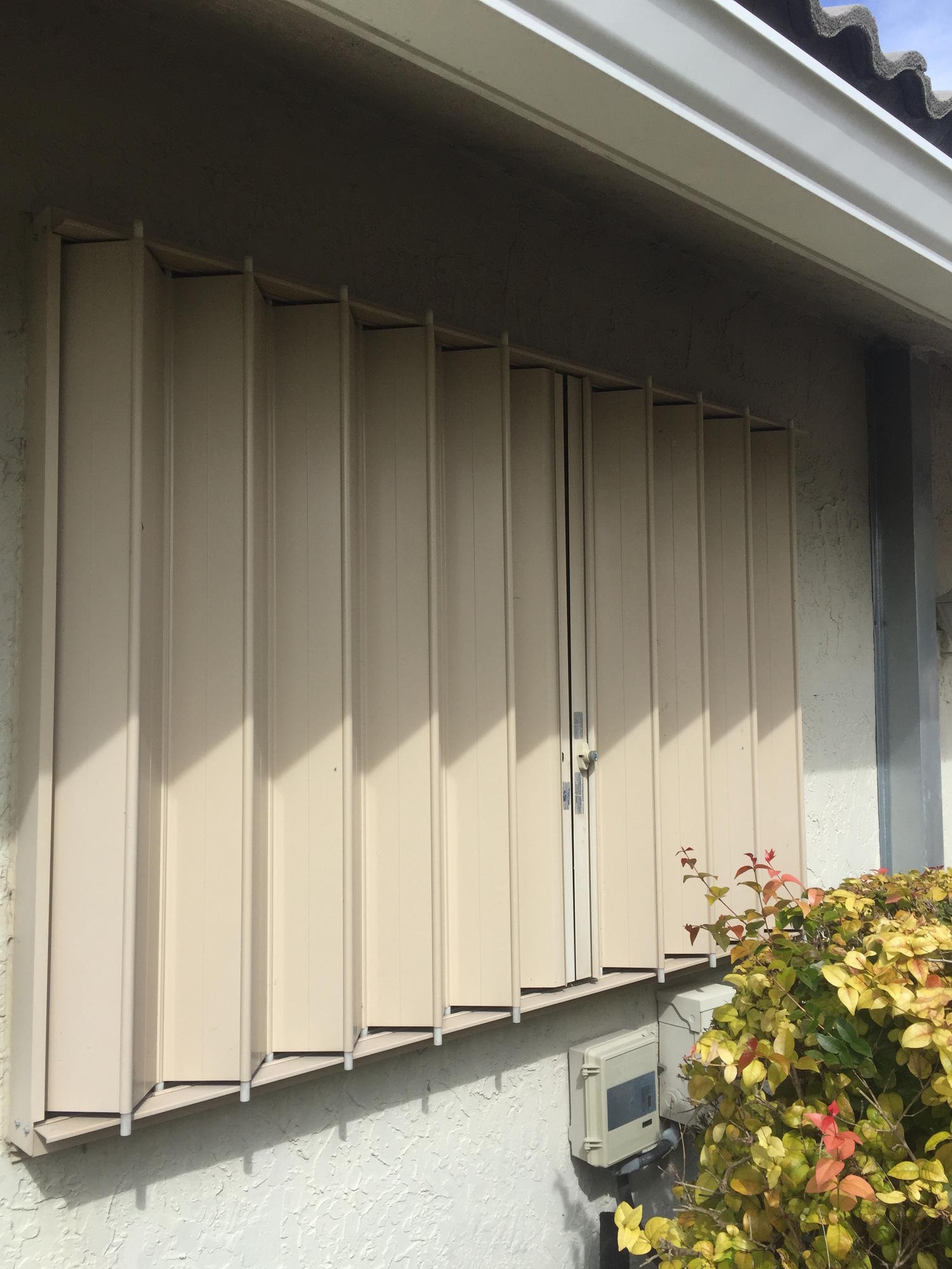

This is a picture of an accordion style hurricane shutter. The shutters are impact rated for hurricane protection. There owner has paperwork - permit card, notice of acceptance, model numbers, and installation invoice from contractor. The problem is the locking mechanism is broken. The shutter is not able to be secured… This goes into the report.

This is an insulated aluminum garage door. The track is fastened to the bucking with 5 connecting brackets. This door is reinforced horizontally but does not meet the impact resistant standards. On form 1802 I would mark box x 6. No wind borne debris protection on garage door.
