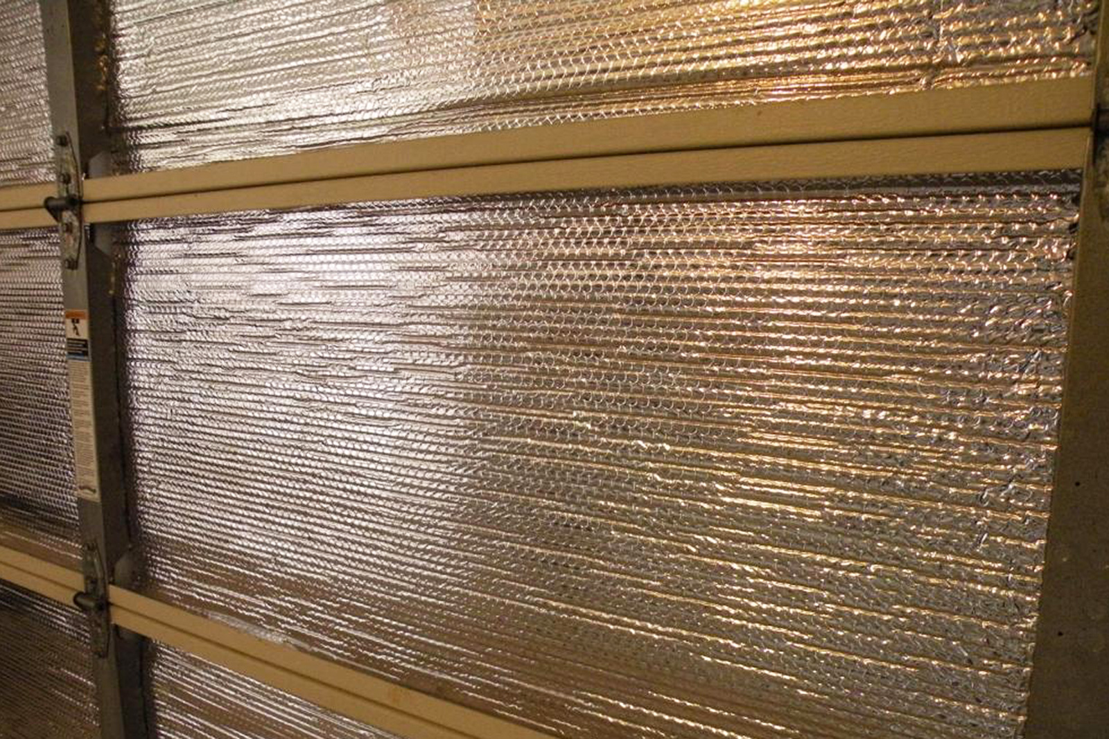

Exterior garage door is not in good condition. It is the original with the home built in 1979. No glazed openings and not impact rated. The interior of the door did not have any reinforcement and 3 bolts fastening to the track.

Topic: Garage Door commonly fail during windstorms due to inadequate door-track strength and mounting systems; and flimsy metal panels. The following features can protect a garage door from wind damage
  1. No Windows
  2. Garage door tracks that t have six to nine mounting brackets or continuous mounting
  3. Trak brackets that are securely attached to the wall
  4. Horizontal and/or vertical reinforcement on all panels
