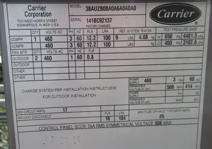

Interesting. Here is a 7.5 ton unit on a 277/480 volt 3 phase 4 wire for illustration. I see your point Robert, not much variance between min and max for a fairly large unit.

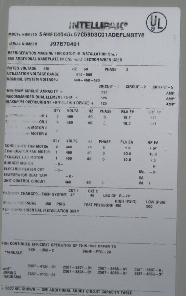

And here is a 40 ton unit, not much variance here either

I think that it has more to do with the design of the units and the applied voltage when you’re using a 480 volt system. A unit designed for 480 volts will normally see system voltages of 460-480 volts, that’s a difference of about 4% from high to low. For the residential unit in the nameplate I posted the variation of 53 volts would be a 20%+ difference therefore the OCPD needs to be sized to compensate for that range. The best thing about all of this is that if you just follow the MCA and the MaxOCPD you’ll never have a problem with the branch circuit.
The manufacturer decides what the MaxOCPD size is and puts that on the nameplate, but that is the maximum size permitted it doesn’t say on the unit or in the NEC that is the size that’s required. It also says what the minimum size branch circuit is. The NEC defines a branch circuit as: "Branch Circuit. The circuit conductors between the final overcurrent device protecting the circuit and the outlet(s)" A unit with an MCA of 20 amps and a MaxOCPD of 35 amps would be code complaint with a 20 amp conductor and a 20 amp OCPD because that would be a 20 amp branch circuit.
And to your point I’ve heard from many electricians that they use the maximum size listed on the nameplate because of potential nuisance tripping using something smaller. Maybe there is some validity to that when the applied voltage is near the bottom of the unit’s operating range. I don’t know because I have never seen it happen. I agree with you that this is circular logic and it would be clearer if they just said Required OCPD is X.
