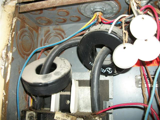

After pulling the cover off of this Zinsco panel, I found these two “dough-nuts” with wires connected to them.
Never seen them before.
Does anyone know what they are?

Current Transformers for metering
thanks what are they metering?
Thy likely go to the meter to measure power consumed
Services above 200 amp usually require these to read how much power has been used in the Location .
http://www.ayainstruments.com/transformertheory.html
I’ve seen a few similar looking end-user products like that for homeowners to monitor their own usage. I’ve seen them attached to SE lines to monitor whole-house and also attached to each branch to monitor individual circuits. I had a seller show me the whole system once… it came with a software program so that he could constantly monitor usage and adjust accordingly for energy conservation.
