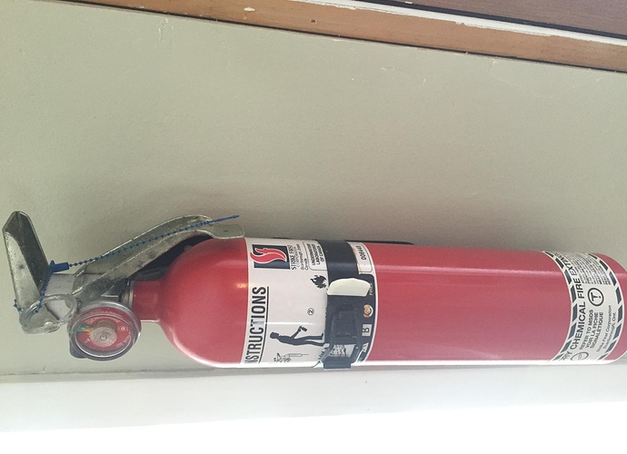

portable fire extinguisher inspection
this fire extinguisher is located on a wall in the kitchen and has no obstructions in accessing it. it is securely mounted at a height that any of the occupants can easily reach.
in inspecting, the bottle is full and is verified by the gauge which is reading in the ‘green’ which indicates full and ready.
this device is rated class A B C and is a 2 1/2lb bottle which is ideal for a residential kitchen setting.
this unit has no hose attached. there is no physical evidence of tampering or damage. the safety seal and pin are intact.
