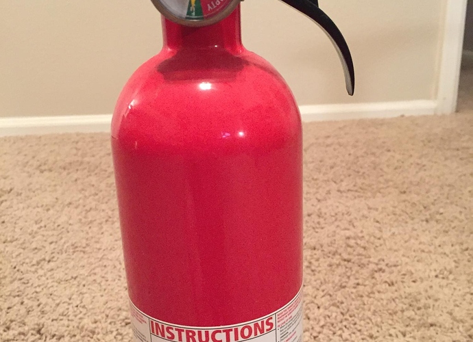

I inspected the portable fire extinguisher in my apartment which is located under the kitchen sink mounted to the side of the cabinet with the appropriate bracket. It passed all of the checks for the monthly inspection except two of them. It doesn’t clearly say what the manufacture date is. It also does not have a metal, paper or plastic tag to initial and date.

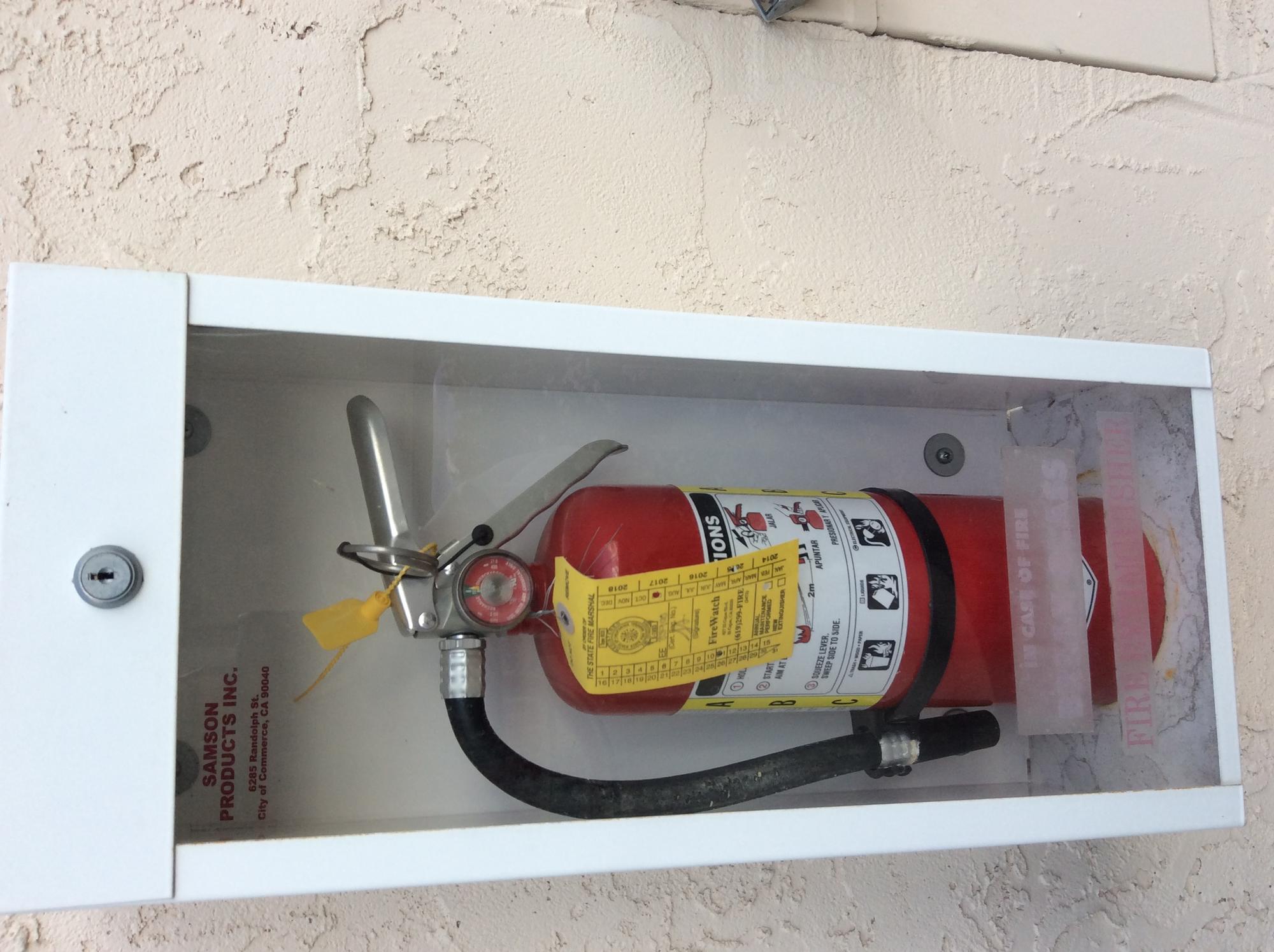

Pictured is a type A,B and C rated fire extinguisher located in an open space which is easy to locate and access. The paper tag indicates that this particular Extinguisher was last serviced on 9/11/2015. The appearance and workmanship look to be acceptable as the Extinguisher looks to be ready to use.

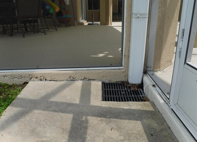

Gutter downspout is full of debris at drain. This is a maintenance item that needs to be addressed for the proper function of the roof drainage system. I recommend that the debris be cleaned from this drain and all roof gutters by a qualified contractor.

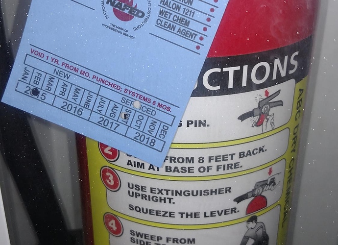

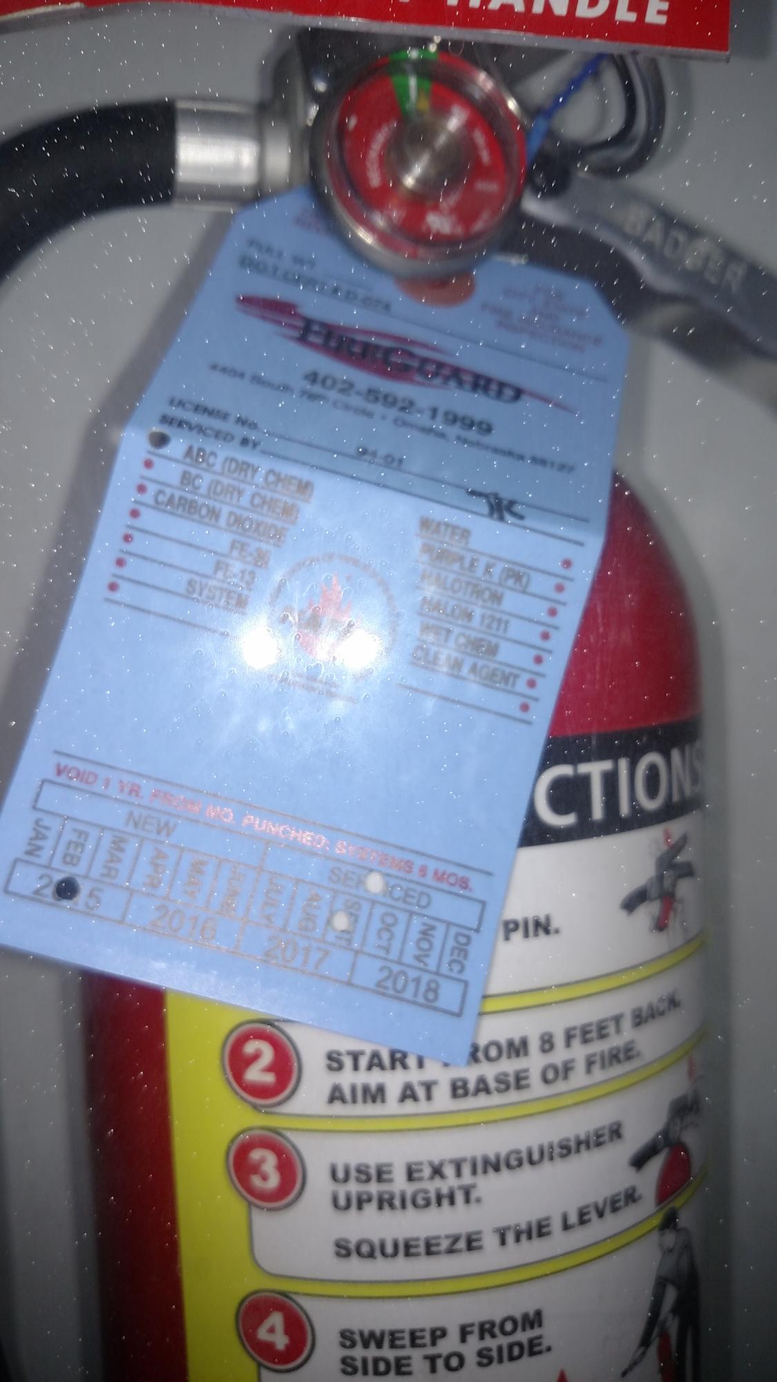

The fire extinguisher in the attached picture is taken at my condo complex. The picture indicates that the extinguisher has all required components to pass inspection. It has the seal and the plastic “zip tie” to hold the pin in place. It has the label with instructions and the tag is punched with the expiration month date. The extinguisher is full and the pin is within the green region of the gauge. The extinguisher content is ABC which is a generic for most of flammable materials.

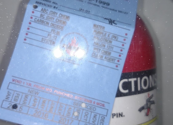

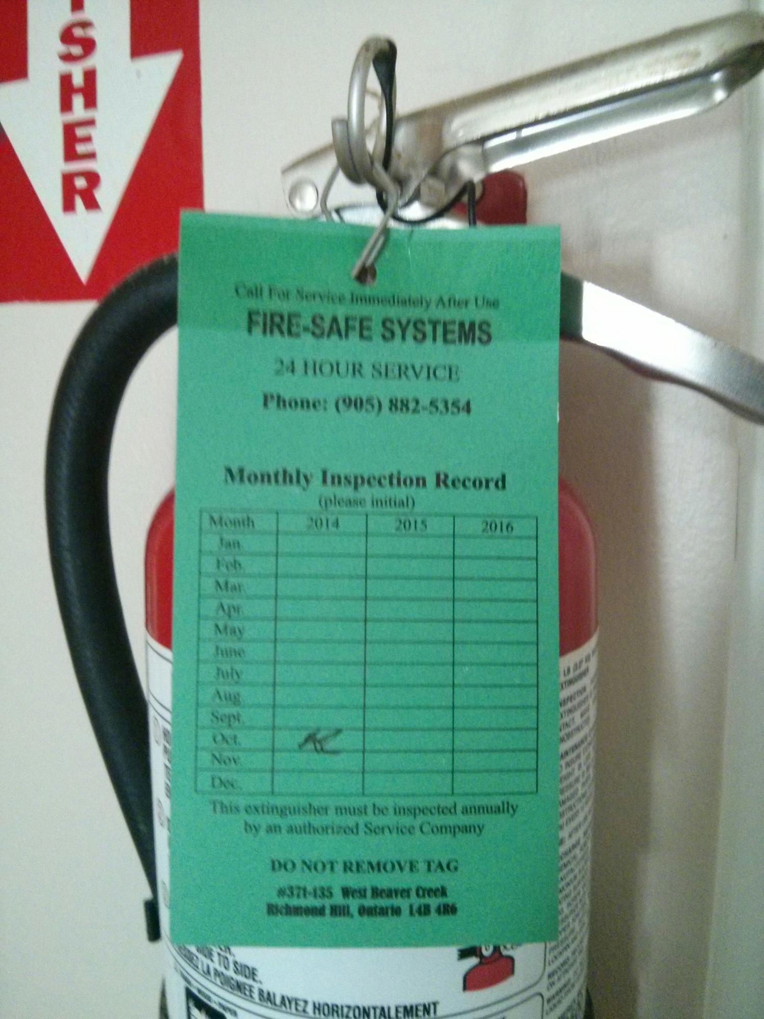

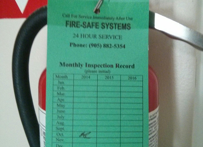

This Fire Extinguisher is several years out of date for its annual inspection and may not function when needed.
If monthly inspections were being performed then this issue would have been addressed.
It takes only a few minutes to do a proper monthly inspection, be sure to sign the tag to indicate the inspection was performed.

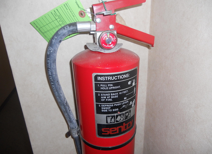

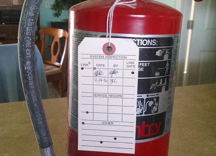

I inspected this fire extinguisher. I lifted it, I checked the gauge for being full. I checked the hose. I checked the labels ( all were legible). I checked the safety seal and signed off on it.

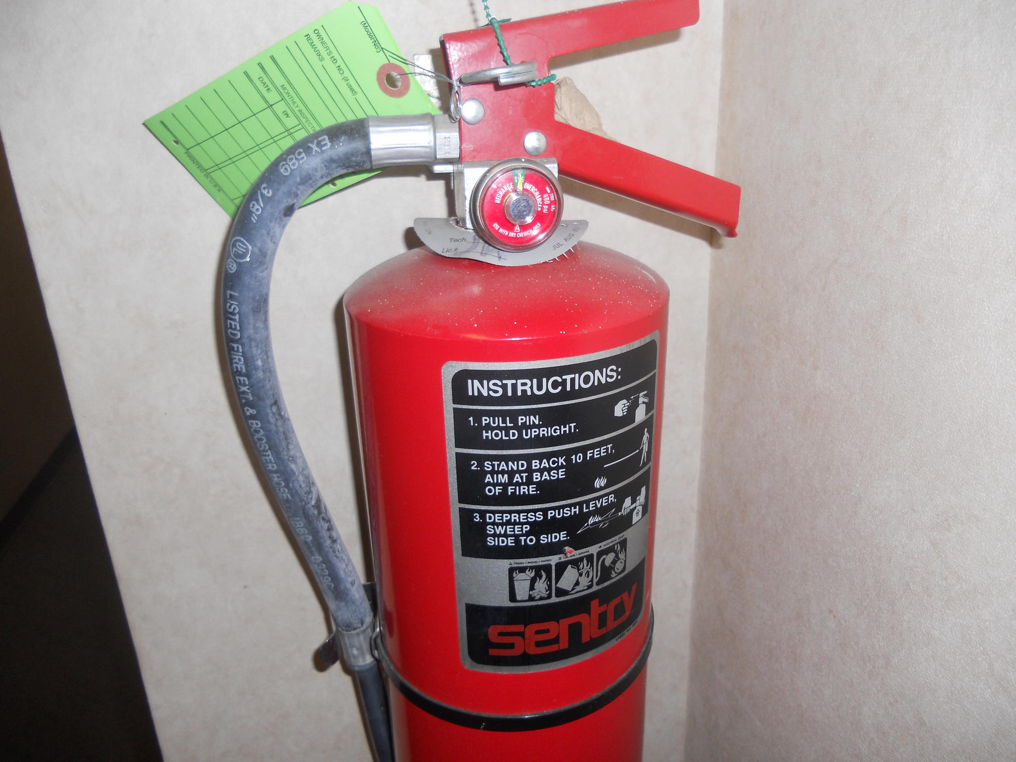

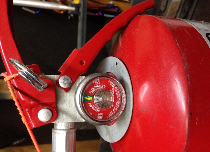

I inspected this 10lb, dry chemical fire extinguisher. Upon lifting it and checking that the indicator is in the green, the fire extiguisher is full and fully charged. It was refilled and certified Oct. 2015. The pull pin and plastic safety tie were intact as well.
