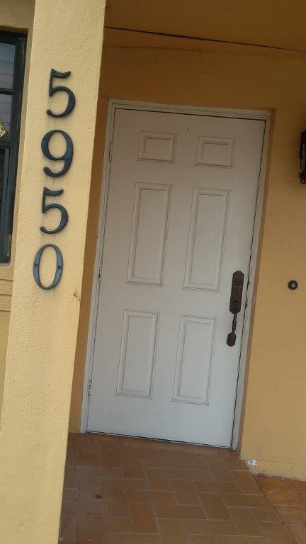

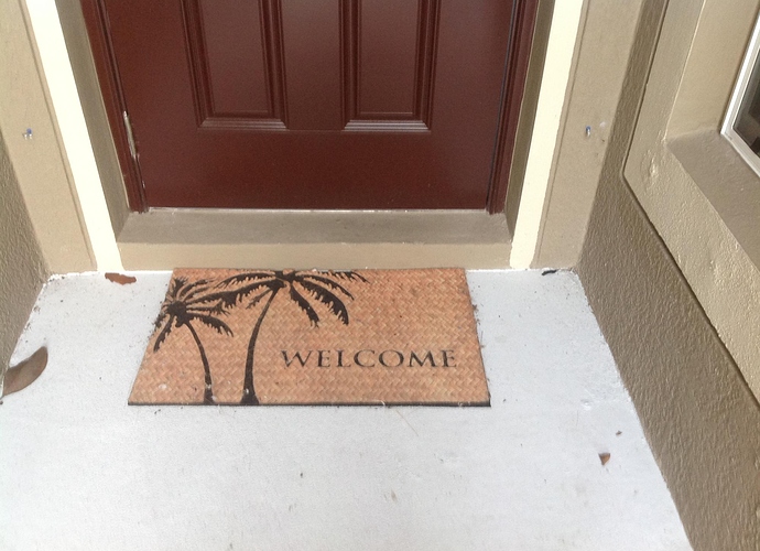

As you can see the entrance way to this home has a walkway leading up to the front door that is the main egress out of this home. The door opens outward for hurricane compliance, the step from the walk to the top of the threshold is about four Inches, you can see the lock is a thumb latch which is in compliance for egress.
The egress door to the dwelling is the required three feet wide and 6 foot, 8 inches high. The egress door is a side hinged door and does not swing out over the landing area. The landing area meets the required 36 inches in the direction of travel. In addition, the exterior landing falls within the exception rule of within 7 3/4 inches below the top of the threshold.

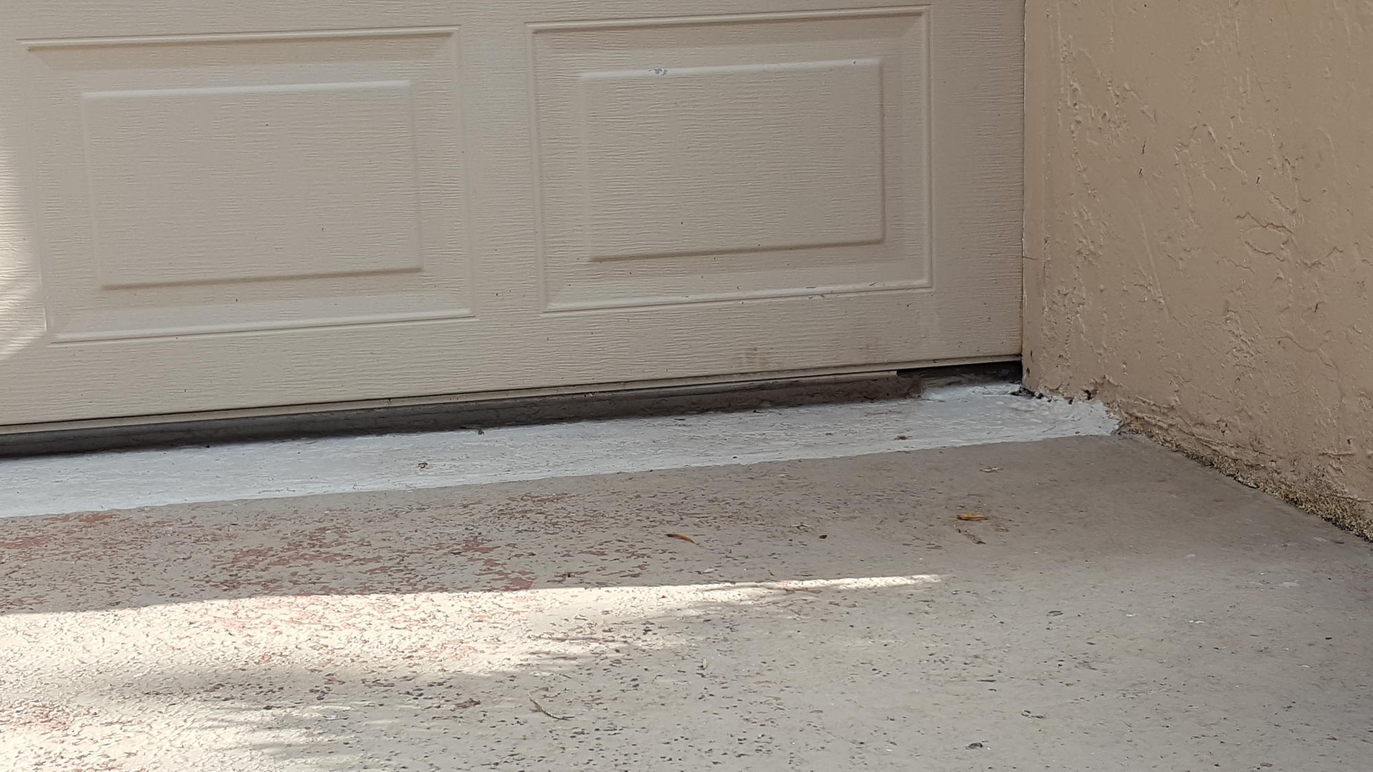

Inspection of the garage door shows weather stripping partially missing from bottom of door (see photo). The missing weather stripping exposes the garage to rain, insects and small rodents. Also the door does not sit flush. Recommend having the garage door repaired/ adjusted by a licensed garage door technician.

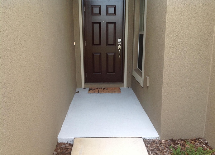

This picture shows a means of egress. The step-down is approximately 4 inches. The landing is considerably wider than the door. The landing is also twice the length of the door. The door being 36 inches. This is an acceptable egress for this dwelling.

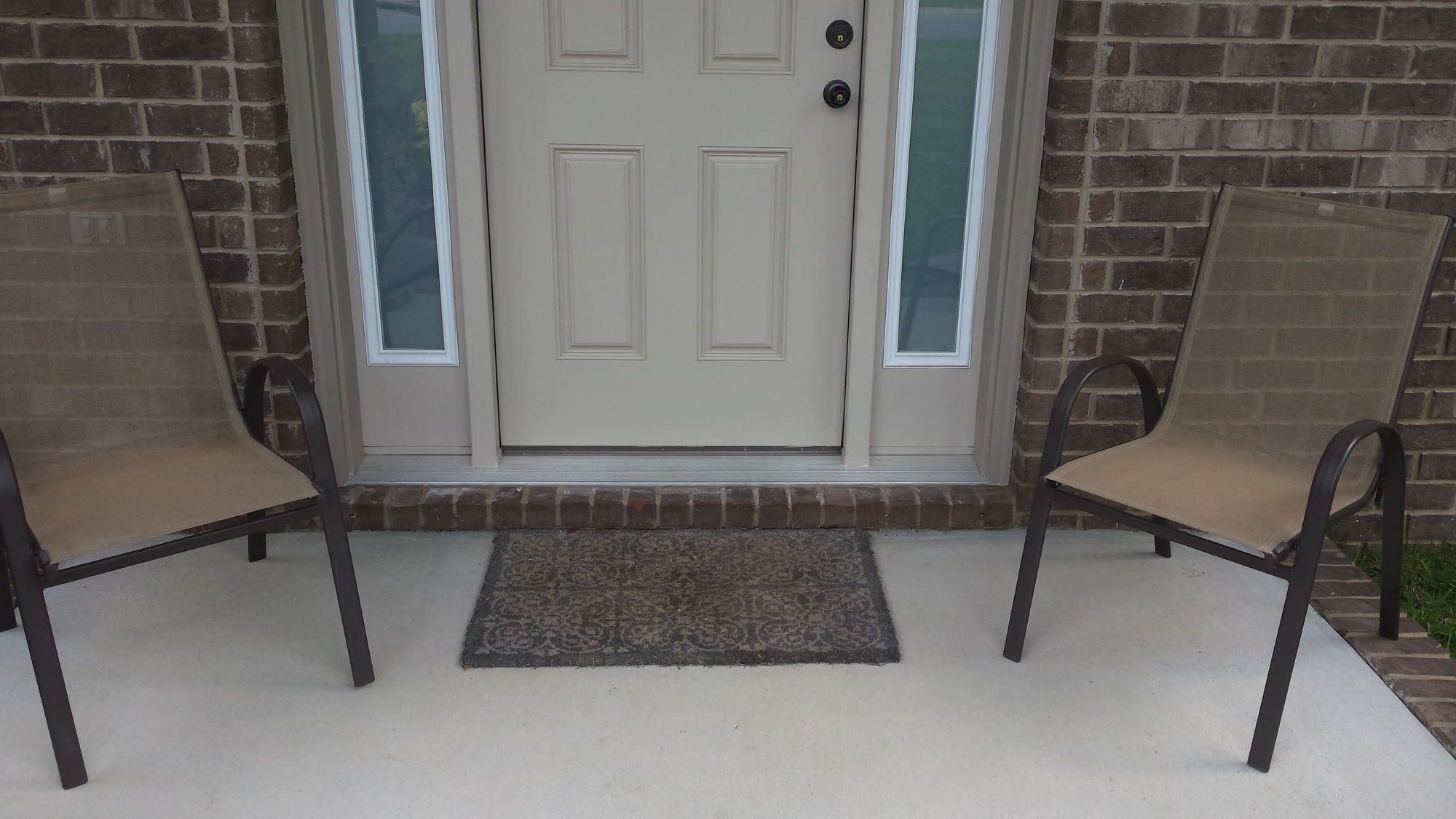

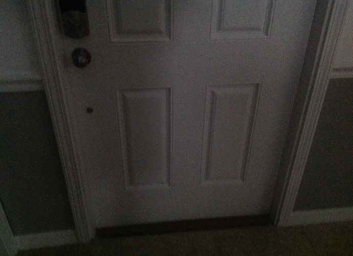

I inspected my mother front door. This door is a out swinging door that meets all the requirements for a means of egress. There is a small ramp that leads to the door that also meets the requirements. The home has mutable doors throughout but this one is primary means of egress.

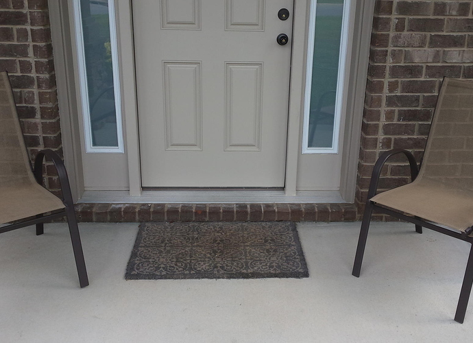

Inspection of this means of egress shows it is up to standard. This is an outward swinging door measuring 36" wide. It swings over a landing even with the threshold and measuring over 36" in length. The landing is elevated an acceptable 4" above the exterior slab.

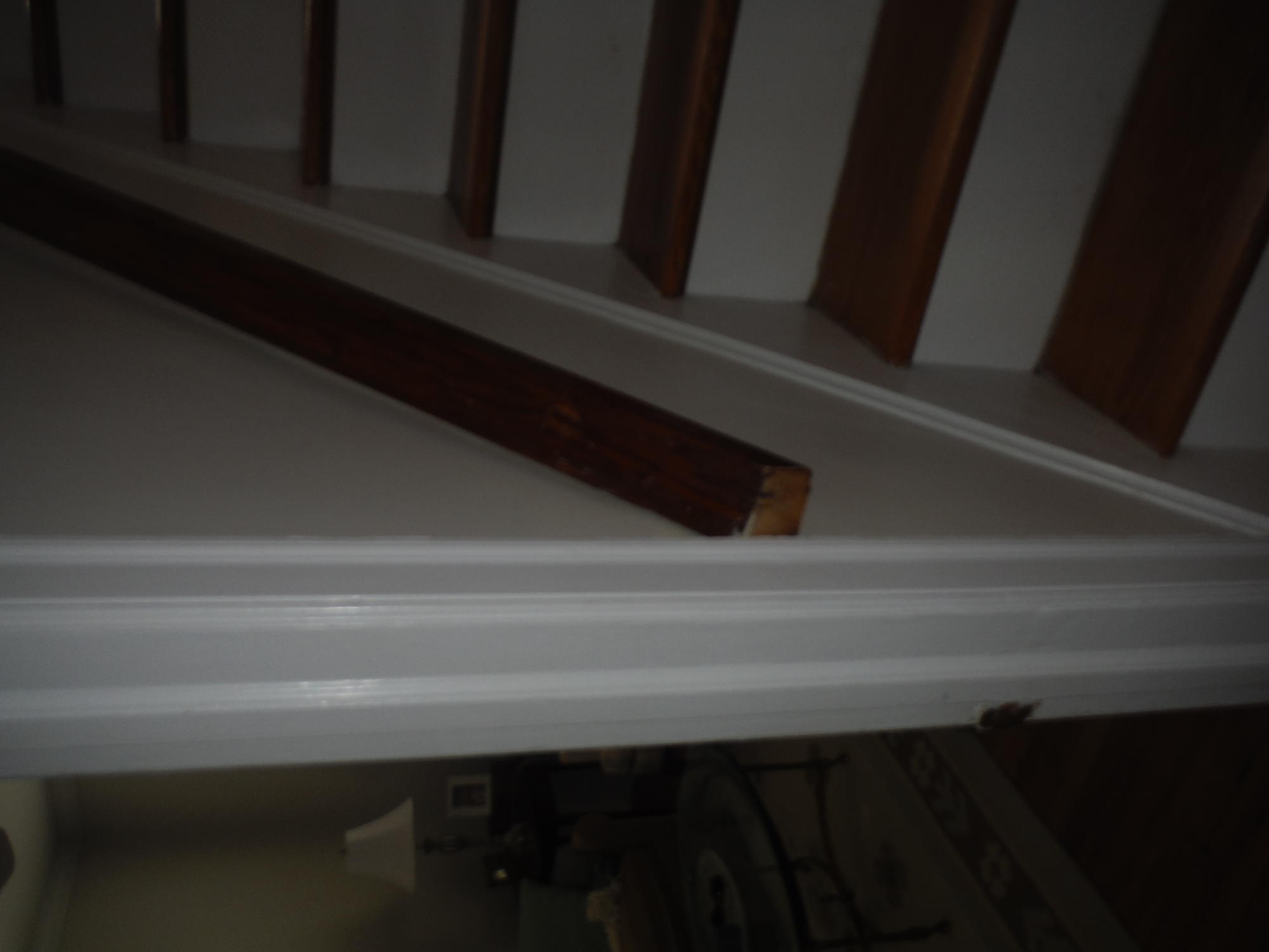

Here is a handrail that has a gap of 0" at the bottom and a acceptable gap at the top of the rail. If a slip or fall should happen a hand may become trapped causing injury. I recommended a licensed contractor to repair this error that has knowledge of local handrail codes and safety.

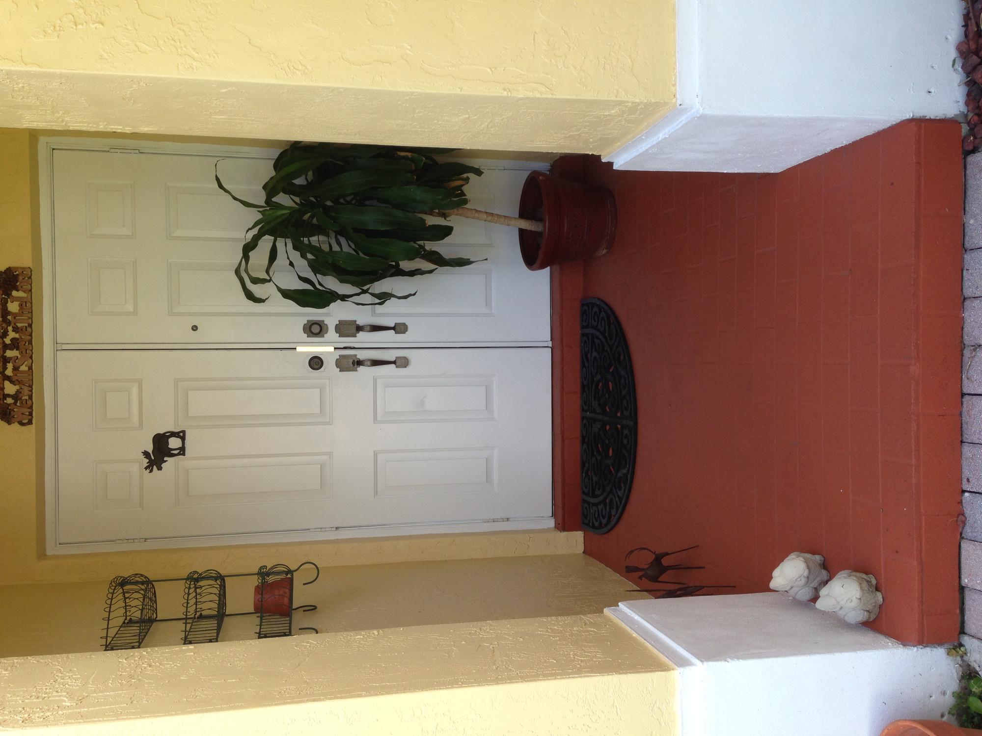

I inspected the front porch of my own property witch has only one egress door that leads outside, This double door with side-hinges meets the correct dimensions. The size of the landing is 5’ 8’’ wide 6’ 6’ long witch also meets the correct dimensions.
