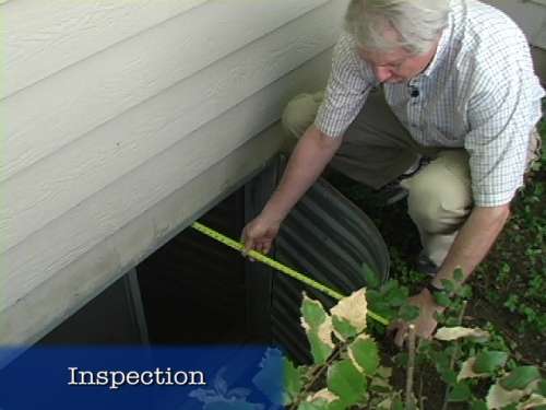

(Christopher Currins, CMI) #3
The window well should have a horizontal area of at least 9 square feet=* 3’ wide X 3’ deep*
**R310.2 Window wells. **
The minimum horizontal area of the window well shall be 9 square feet (0.9 m2), with a minimum horizontal projection and width of 36 inches (914 mm). The area of the window well shall allow the emergency escape and rescue opening to be fully opened.
Exception**: The ladder or steps required by Section R310.2.1 shall be permitted to encroach a maximum of 6 inches (152 mm) into the required dimensions of the window well.

(Hank Lancet) #5
So therefore a window well that is 36" wide, has an 18" projection
(hence a semicircular window well) is in violation.
But of whose standard? That’s what I want to know. I guess what I’m looking for is when I document that this is in violation of the 9 square foot rule, then I’d like to be able to back that statement up with an authority from where it stems, because most of the homes in my neighborhood have wells that look like this:
In that picture, you can see the inspector measuring the projection of the window well even though it’s pretty clear that there’s no way that thing encloses 9 square feet.
Is it part of fire safety code or something? I understand the reasoning behind the 9 square foot rule. Because of the large number of local violations, however, I’d like to be able to back that rule up with some authority that I can direct homeowners to, if such a thing exists.

(Christopher Currins, CMI) #7
The window well must be at minimum 36" wide and 36" deep at center measurement.

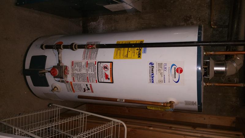

(James Maue) #15
This is a gas fired water heater with a pressure relief valve. There is no expansion tank on the domestic hot water. There is an expansion tank on the feed side of the heating system on the boiler (not pictured).
