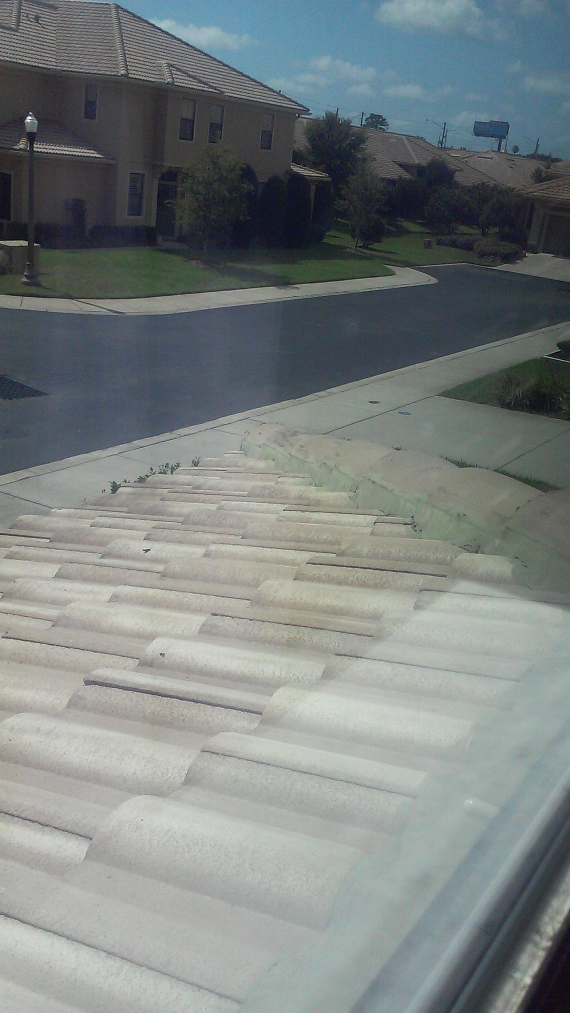

The roof was installed in 04/10/2000 and is approximately 16 years old, the typical lifespan of a concrete tile roof is 25 years. During inspection of the roof it was noted that there were loose tiles along the front left corner and numerous broken/cracked tiles in the field. Repair/replacement by a qualified roofing contractor is needed to prevent further damage from water intrusion
I inspected a flat concrete tile roof just over 20 years old. This home is located in Florida with a few over hanging oak trees. There were a few tiles that were cracked along the the full width of the tile and two tiles over the overhang area of the garage that were broken and collapsed in where leaves and twigs have collected. At the back of the house is an addition which has a flat roof installed. There is an excessive amount of leaves and branches laying on top of the flat roof area and in the valleys of the tile roof. The build up of leaves is holding moisture against the tiles and should be removed. The gutters were also filled with leaves and should be cleaned out.
Did a visual inspection of this tile roof. Everything appears to be in order. All flashing, roof louvres. plumbing stacks appear to have been installed correctly. The only thing I found to be missing is the bird stops at the bottom eves. Noted. On to the interior to do an attic visual to look if there are any leaks…
