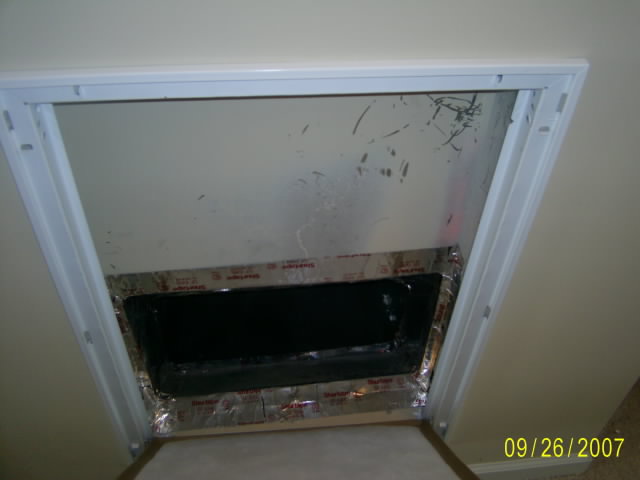

The workmanship is poor, at least. Looks like the person doesn’t know how to squeegee down their tape, and also looks like they used leftover fire alarm cable for the thermostat wiring.
This one had a 14x30 filter but only a 14x16 hole in the actual wall for the free air which was then reduced to about 13x9 as it runs under the air handler…:shock:
Is this the only unit for a two story home? Around here, you almost always see two units, even if it is a zoned system. Workmanship, unfortunately, looks a lot like some that was done when my home was built !!
when sizing duct, most professional HVAC people use the CFM approach which is warrented for each install. i have no idea total length of duct and sizing throughout so I could not say off hand what size return is needed. You really can’t judge air flow by duct work. BUT, looking at pics, I can say it is definetly needs to be tidied up and checked by HVAC pros

Uusally try to design about 400 cfm per ton and return ducts about 20% larger than supply…so from a local HVAC supplier catalogue “INFO” section:
If all zones were calling for AC together, you would need about 270 sq in for return air.
