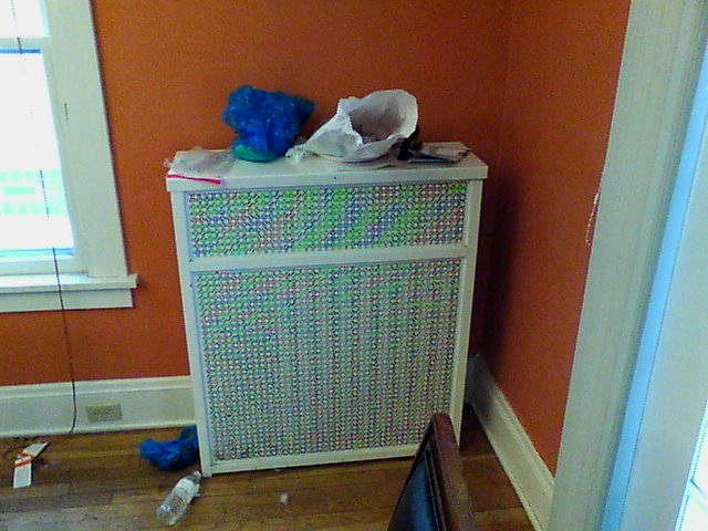

Here is another related to boiler radiators. One question would be can you properly use IR on radiators with the register covers on? What would you say on these images if anything?
The home had 3 floors above the basement and this was on the 1st floor.

Yes, “shooting the hole” works just fine, but you must adjust transparency settings if your using qualitative temp assessment.
That is not available in many low end cameras now is it?! :cool:
You must be mindful of the effects of “YOU” being in the scanned area. You will see your own footprints (even with shoes on) with appropriate TI Equipment all the time.

Transmissivity settings can sometimes be used when your looking through a consistent (object to object) screen, grill or translucent material to save from taking all the heater covers off.
The holes are too small to get a direct measurement (spot size ratio), so you end up with an averaged reading.
You must take one cover off to get a direct measurement and adjust Transmissivity (with the cover on) to get the same reading.

In this thread we are talking about one application; qualitative assessment of heater radiators where the temperature is wanted but not critical.
What I proposed is a work-around for the OP’s question.
I have used this when I had a job of inspecting 400 fiber optic stations under a prescribed load. It was too dangerous and too much work to remove screen panels without taking them off line.
Took one apart. Tested it with and without the covers and adjusted the rest for transmission through the covers. If a problem was detected, it was shut down, taken apart, and properly evaluated.
We did not rely on scans that were close to the threshold temperature. But if they are well below, there is no reason to pull them all apart.
This is about as accurate as guessing on the emissivity of a target.
So much for the “for newbies” part.
On the radiators, if you compare multiple radiators, all demanding heat and you have an outlier that you can see based on the thermal pattern, you can infer that there is an anomaly that warrants further evaluation. You can make out the thermal pattern well enough in the image. You do not want to try to indicate temperature as you cannot do that with any degree of accuracy without taking additional steps as David indicates. I would remove the temp marker from the image.

The image of the radiator appears to be in Iron mode.
Change it to Rainbow with Flir tools and let’s take a look.
Just curious.
In addition, I got my camera back and it is working fine.
I took these the same day as I wanted to see what i looked like in different palettes. Glad you have you camera back!!

I’m too new at this to ever come close as to if/or there are any issues with the radiator.
But, Here are the images side by side.
What is the conclusion …Are there any issues?
