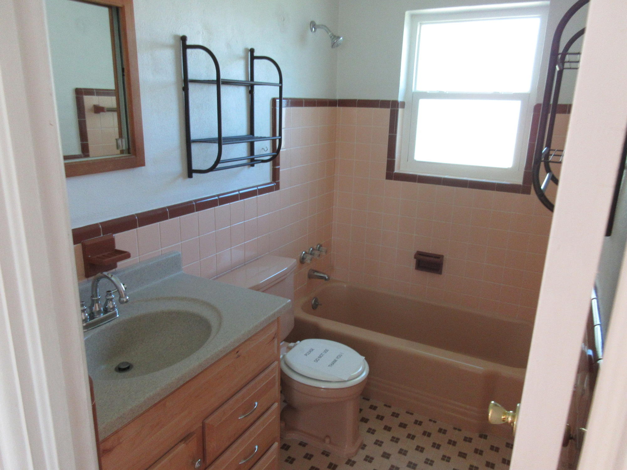

This is an original 1950’s era bathroom. The clients advised that after purchase they plan on updating this room entirely. The clients were advised that EPA procedures must be followed by the contractor for testing and containment of lead based paint.

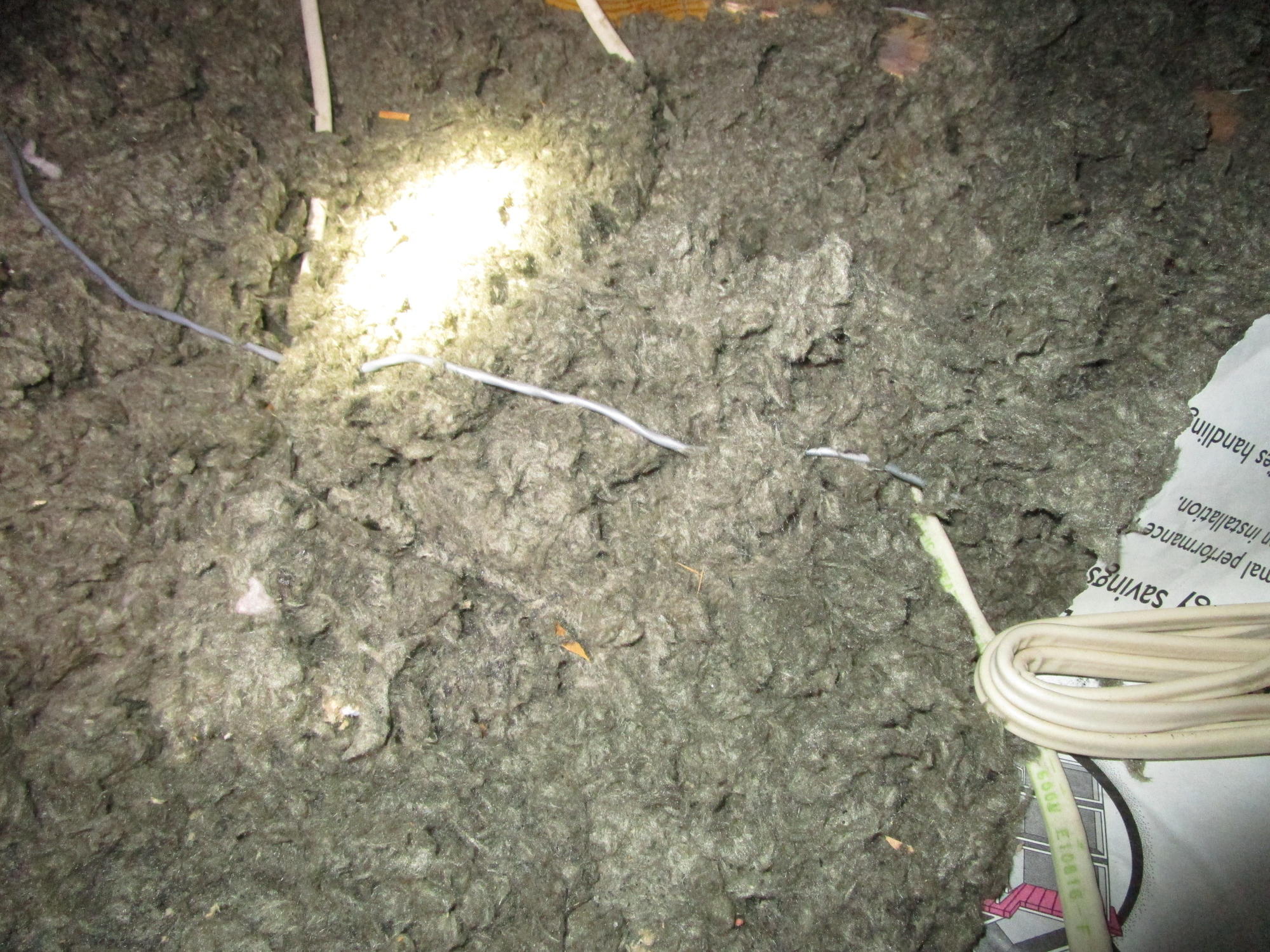

The insulation installed appears to be loose fill Rockwool. Rockwool insulation is spun from superheated minerals. It has a good insulation value and is resistant to fire. Although this material is not commonly installed in this area it is a modern product that is considered safe to install.

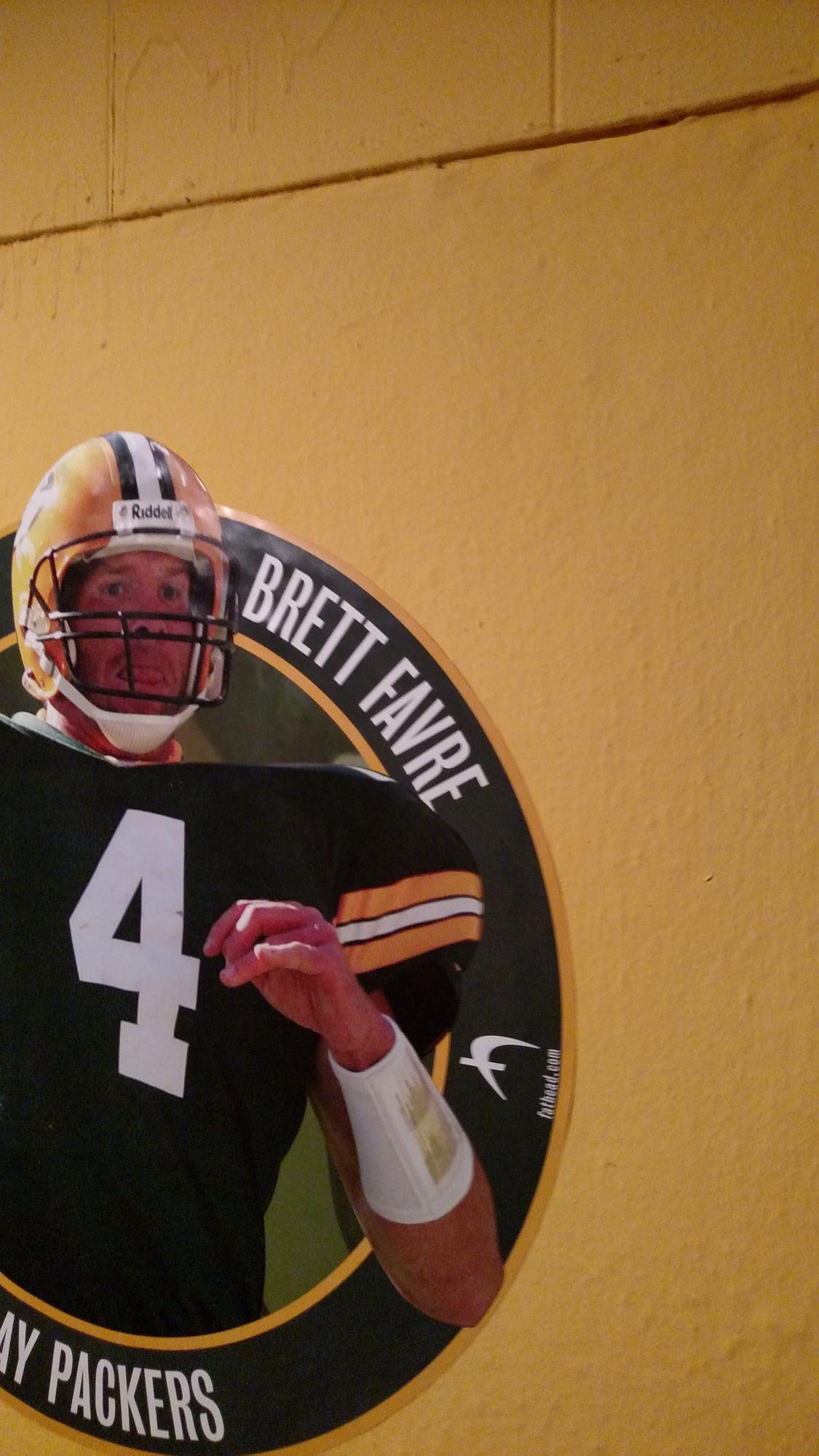

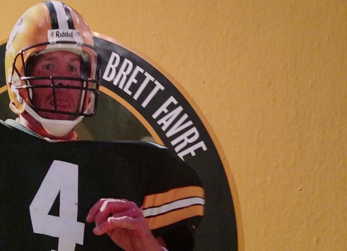

Great class! Well I went downstairs and took a picture of my concrete wall which was painted twice since 1958. Its current color is Green Bay Packer Gold, and it use to be white. The question is, does the 1958 white contain lead? I will buy a kit and test it, following the rules and advise given to me in the class. I atteached a picture of my gold wall with Brett Farve! Go Packers

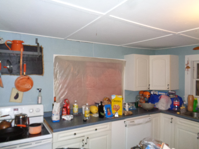

The entry door to the work area must be covered by 2 layers of plastic sheeting. The window to the right of the door must be sealed on the inside with plastic sheeting and tape. Waning signs must also be placed appropriately.

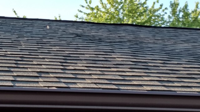

This is a roof over an attached garage. The roof is about 5 years old with architectural shingles. There appears to be some sagging between the rafters starting.

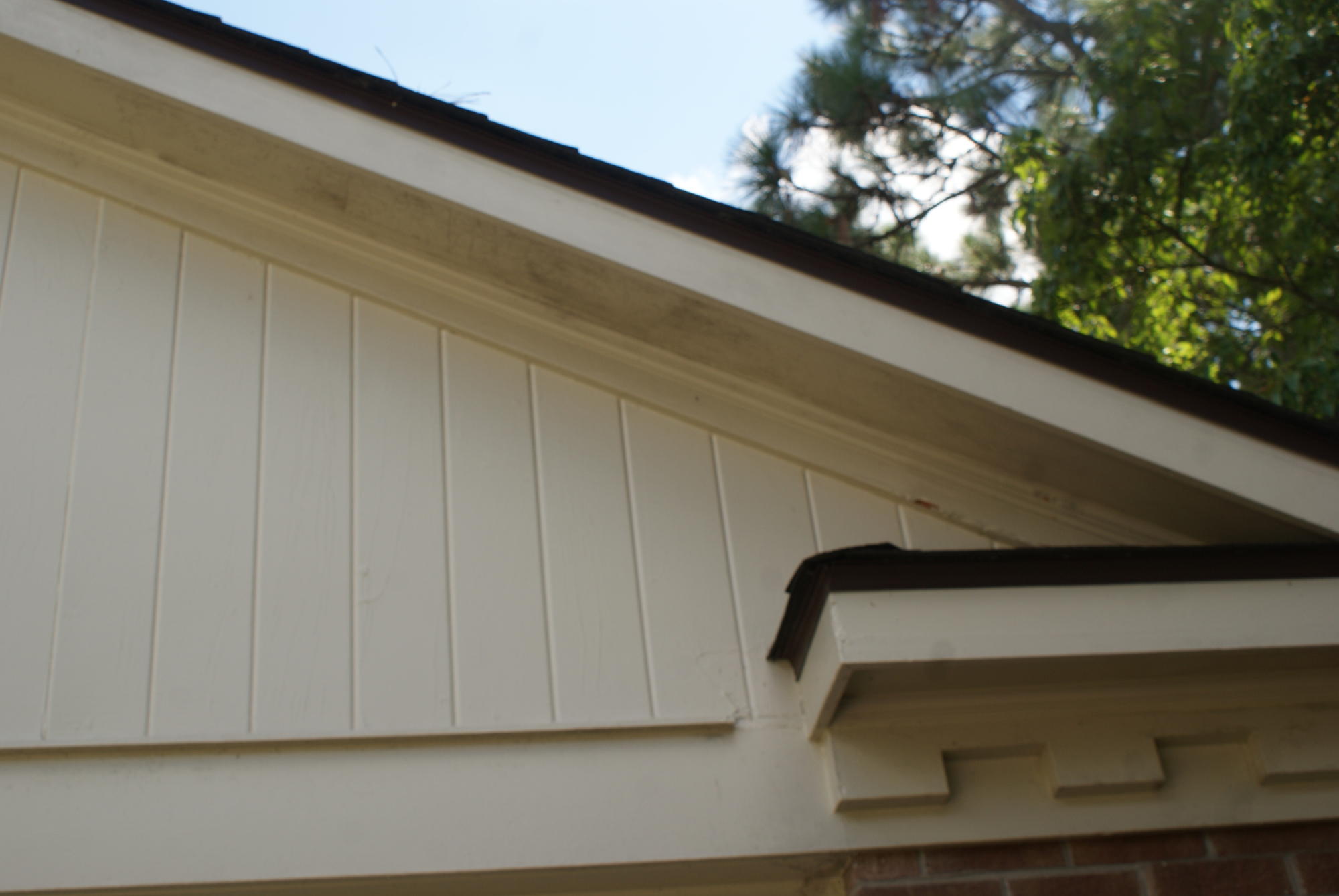

Essay for the exercises:
“The eave of the front right corner of the home at 1234 main street Townville ST 12345 was noted to have loose paint materials, and according to municipal records, the home was constructed in 1978. It is possible the loose paint materials may expose and produce lead and may be a hazard to the inhabitants of the home. See http://www.epa.gov/lead for more information, and have the loose paint materials in and on this home tested for lead, for safety.”
