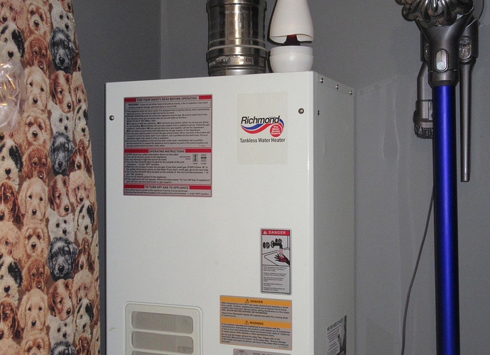

One of the areas that may be contaminated are the components located within tankless hot water heaters. While some of the newer gas water heaters draw their combustion air from the exterior, some of the older models, such as this Richmond tankless heater, draws its combustion air from the interior of the home. While there is commonly a filter in place, the computer board and various components within the appliance itself can be contaminated as well as the inside of the stainless B-vent. Therefore, is important that you are able to determine the difference between sealed combustion and natural aspirating tankless hot water heaters.
