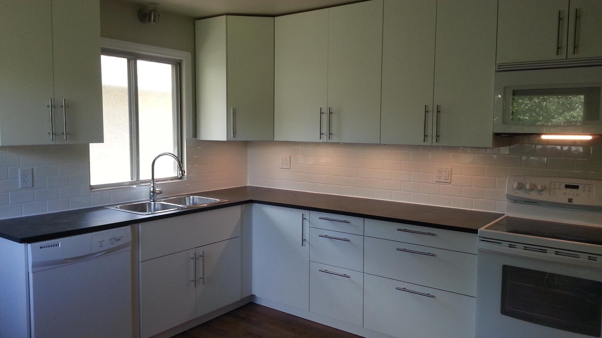

A picture of a kitchen I inspected. Window open and closed fine and was no sign of condensation or cracks. Ptrap under the sink was installed properly and no signs of leakage. GFCI plugins on both side of the sink and tested working normal. All cupboard doors and drawers functioning normally. Vent fan above venting outside and no abnormal noises. Water pressure from tap was normal and showed no signs of leakage.

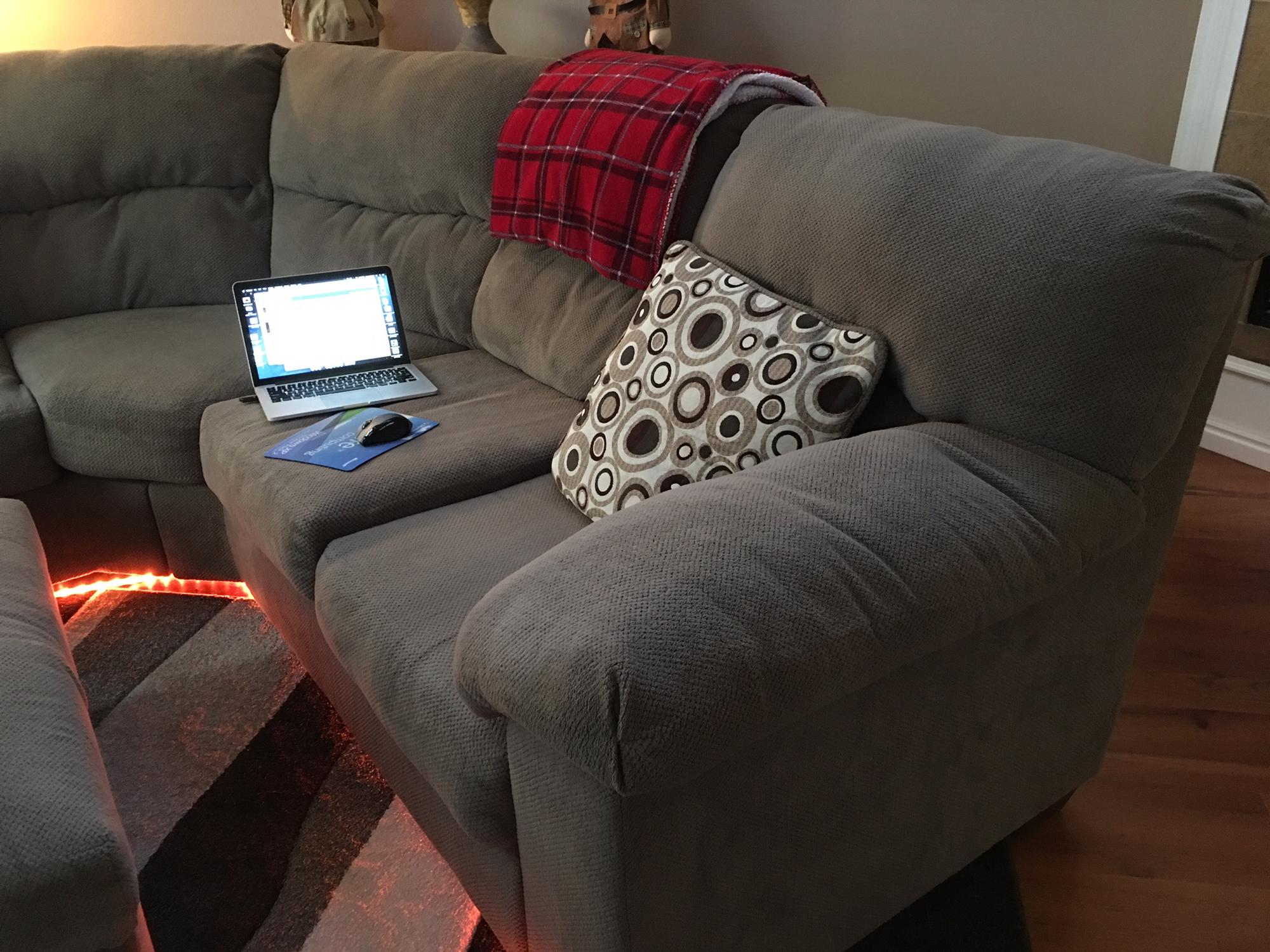

Below is an image of a piece of furniture. Typically, if this sofa were found in a meth house, it should be discarded in such away that it could not be re-used. Fabric of this sort is soft and porous and it would be difficult to de-contaminate. However, if this piece was far removed from the cook site, away from the HVAC circulation and perhaps test shown not not to be contaminated, a micro-vacuum system might be used to clean it."

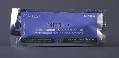

In some cases we simply want to know if there is meth residue present. How much residue is present or exactly where it is, is more information than we need. If you are buying a house you probably want to know if there is meth residue present. If meth is present, that’s usually enough information to make a decision. This testing can be be done by individuals using home test kits. I like the Meth-x test kit http://www.meditests.com/meth-test.html

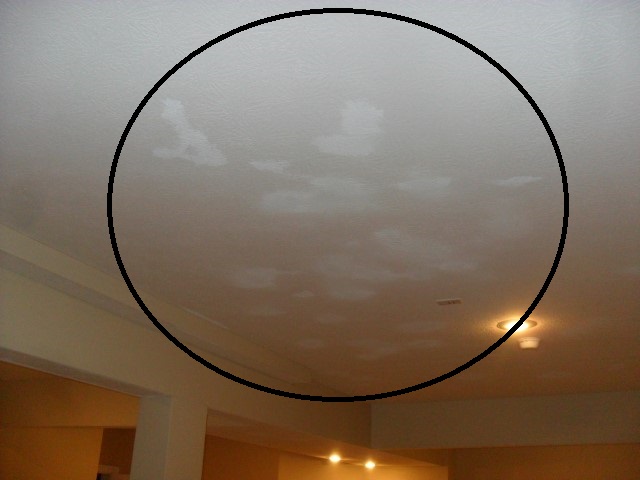

Hi Everyone
I have ran into several homes as of late in very nice areas the have really bad staining on the ceilings and some walls.
No roof leaks found and no repairs have been made. This is what has prompted me to take this course

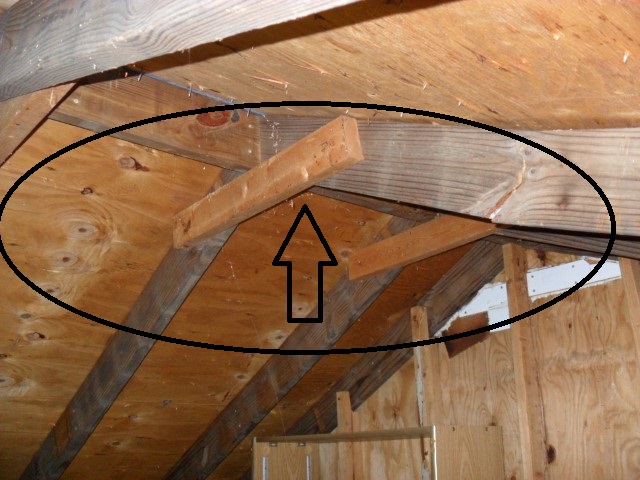

Collar ties
Inspected a home yesterday and the attic above the garage has been altered for storage.
The collar ties where remover and raised to the top of the rafters , Allowing the rafter to spread and break

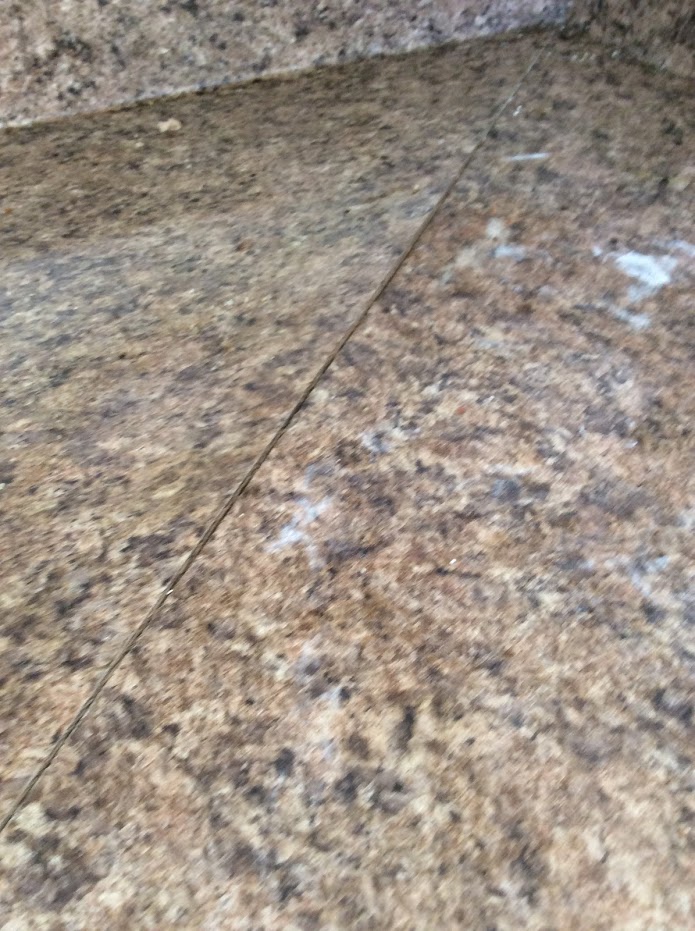

Meth Lab remediation is a dangerous job. It is important to do thorough cleaning. This counter top is damaged and may have hazardous waste etched in it. The counter top should be removed.

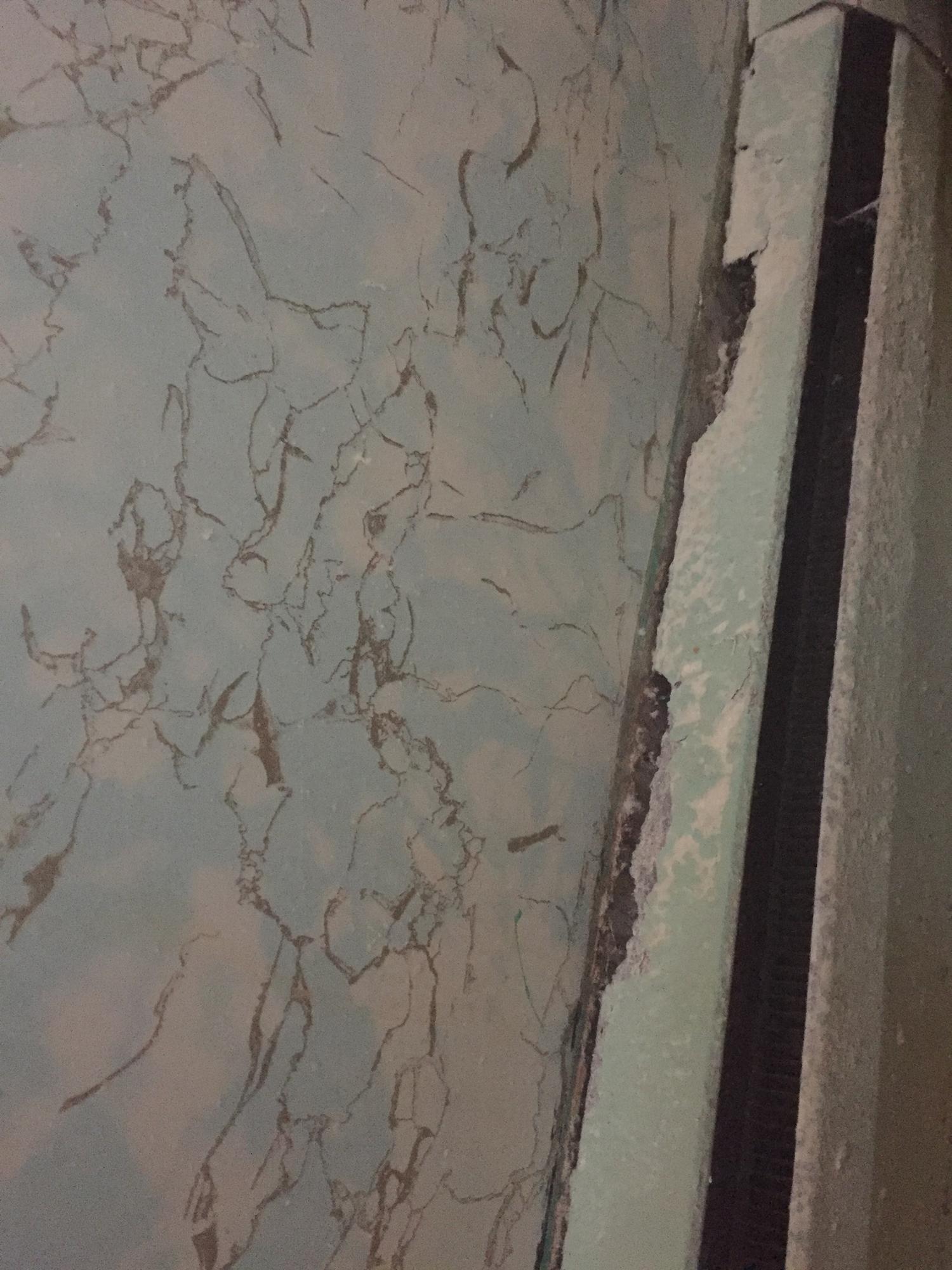

I know this photo is not actually from a meth house but it is something you could find in a meth house. The photo is showing a baseboard heating unit. The unit is rusting out because of a moisture issue in a bathroom with no exhaust venting system. Look at the white powdery substance on it however. If other signs were present and I did not know the property I as the inspector could question the possibility of meth use or meth lab.

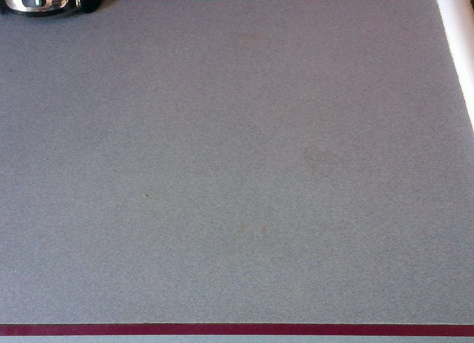

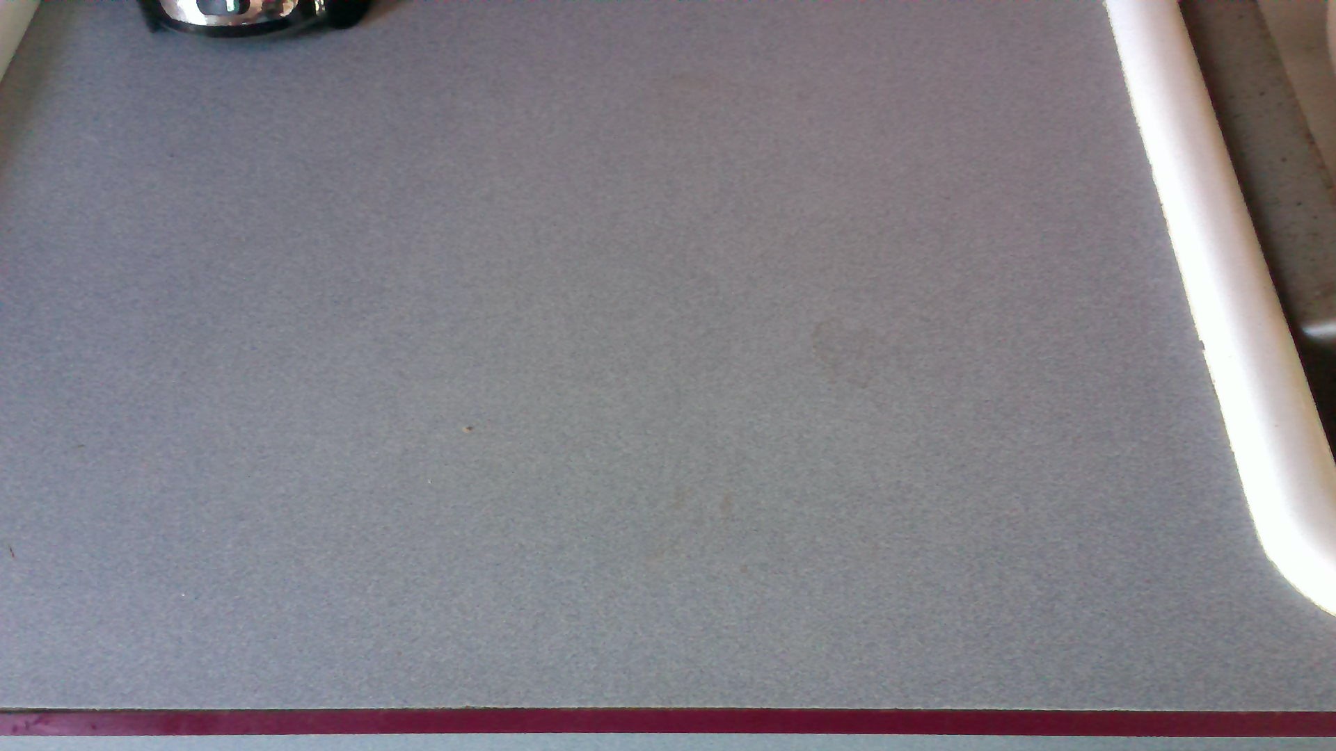

Countertop located in main floor kitchen. Light staining present on surface which may indicate a meth cook or use may have occurred. Staining is isolated to counterspace left of sink approx. 3"x4". Wipe sampling to be used for sample collection.
