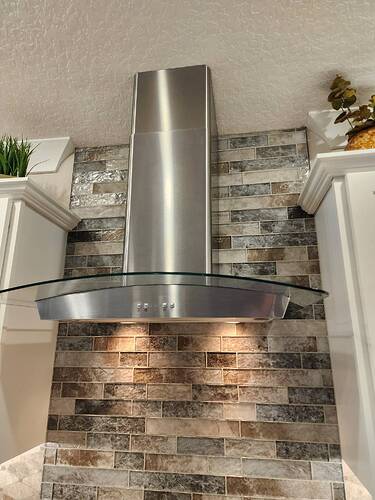

The cabinets in the two most recent pictures were installed with a stove hood in mind, not a microwave. Even when proper planning has taken place initially a replacement microwave or stove may screw up the whole arrangement.
Best oven for a microwave installation has ALL the controls in front. 16 inches to the bottom of the microwave is probably a MINIMUM workable spacing.

I also will add that many of the newest homes I’m inspecting only have a hood, some of which have nice fancy hoods.
The microwave is either a countertop or in a cabinet to the side with the oven below.

Wrong stove for that application. Stove should have controls on front edge for obvious safety reasons. Those cabinets were installed for a range hood ONLY!
