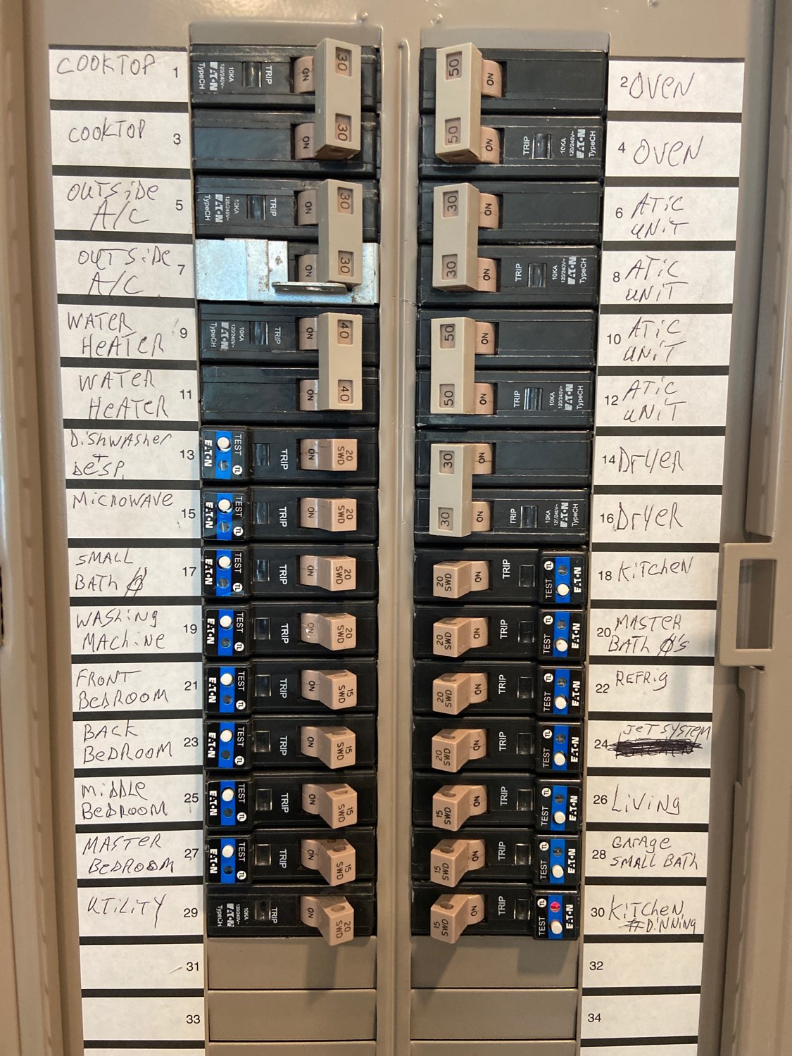

I am new in business with maybe 75 inspections under my belt. I inspected a new build today where there were no receptacles anywhere with GFCI markings or test buttons on the receptacle. Assuming they were GFCI breakers, I tested the locations with my basic 3 light tester but nothing tripped. After removing dead front panel, the Eaton breakers had the test buttons on them. I assumed those with the test buttons were AFI breakers. How do I determine if those are AFI/GFCI breakers? There was no wording on the breakers except the letters “TL”. If this were an older house, I would write it up with no GFCI protection and move on. But this new construction has me second guessing myself. Any help is appreciated.

Yes, I do have photos but I need to figure out how to get them on here for you to see.

Hey Martin, thanks for the reply. What you mentioned really wouldn’t even surprise me that much, sadly. This house didn’t have GFCI receptacles ANYWHERE. Not in the kitchen, bathroom, garage, or exterior. That’s why I’m writing here. Am I missing something? I’m attempting to include the pictures here.

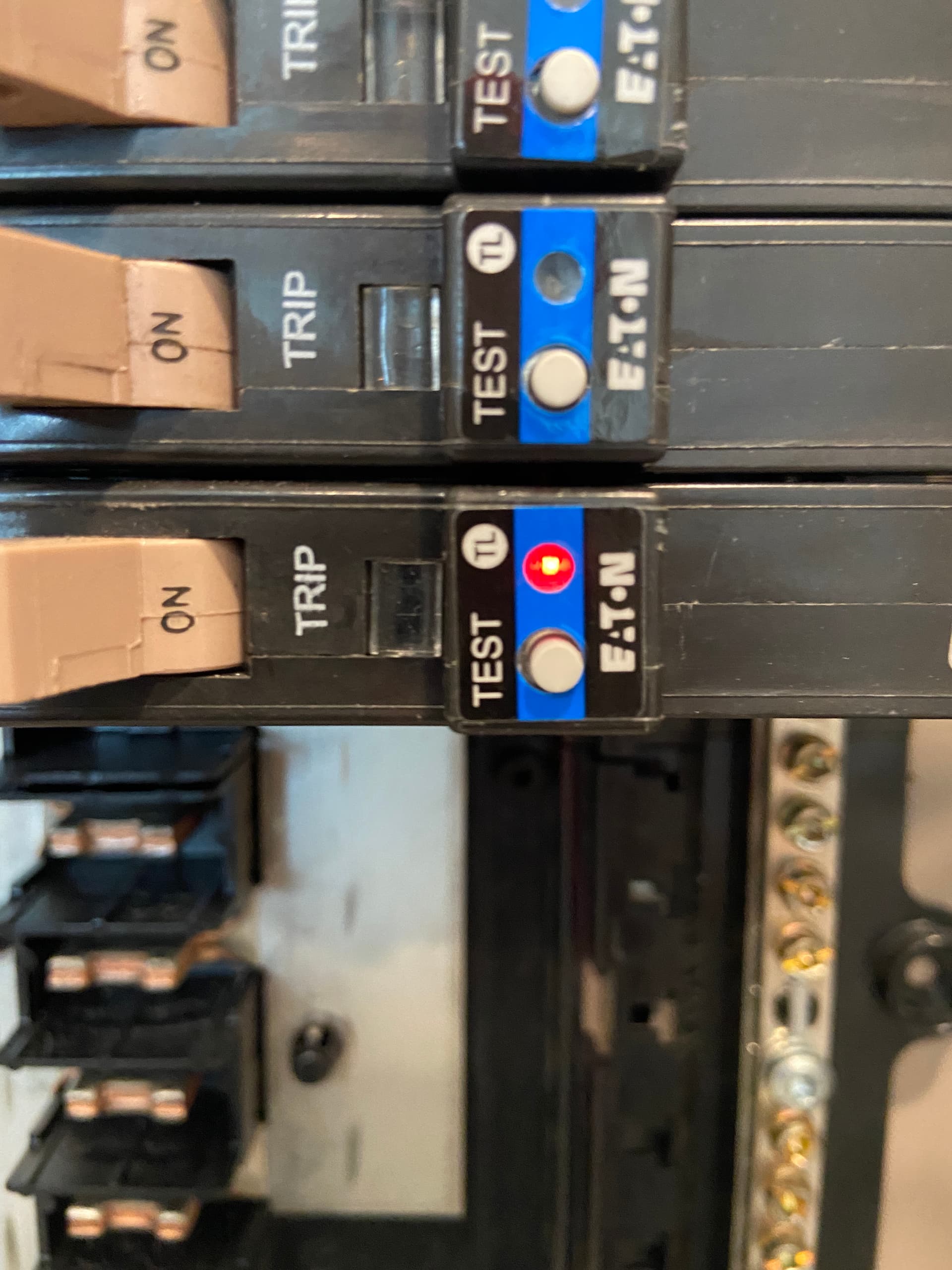

Looks like the receptacles are protected by the GFCI circuit breakers. It appears the kitchen circuit breaker has been tripped.

Or an error code
http://trcsupport.eaton.com/Residential-Distribution/Loadcenters-Resi-Breakers/1010506601/What-is-the-color-scheme-of-the-AFCI-GFCI-and-AFGF-residential-breakers.htm
I saw the light and will note that on my report. It was a solid red light and I haven’t been able to find any information other than it has been tripped.

Martin and Brian, Many thanks to both of you for the great inputs. Good info here. Keen eye on the red light.
I personally would follow my original narrative and add in the red light.
