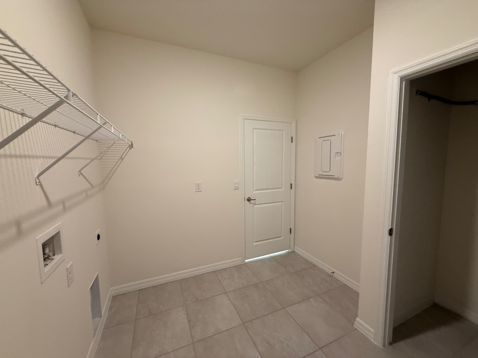

Here’s pics of the laundry room. Door is in the left corner.
That’s part of the problem. In this area the Engineered Mechanical Drawings often mysteriously “disappear” and the unsupervised contractor takes as many short cuts as they can think of.

Where does it say that as long as it has a RA box it’s okay for it to pull from the closet since it is not the only method of return air? Not saying you’re wrong, but from the way the code reads it, it just flat out says “return air shall not be taken from a closet.” I’m just curious if there is an exception I’m missing or miss reading.
Here is a picture of the outside hallway with a return vent.
The code is meant to allow free flow of air to the unit. It is meant to prevent starving the unit from an enclosed space, because it needs to pull sufficient air from the main living area. If it were enclosed, the depressurization would force air through outlet boxes, light fixtures, and anywhere it can get it.
This setup is not pulling air from the closet.
How many times have you seen an AHU in a closet with a louvered door? Does that mean it is pulling air from the closet?
