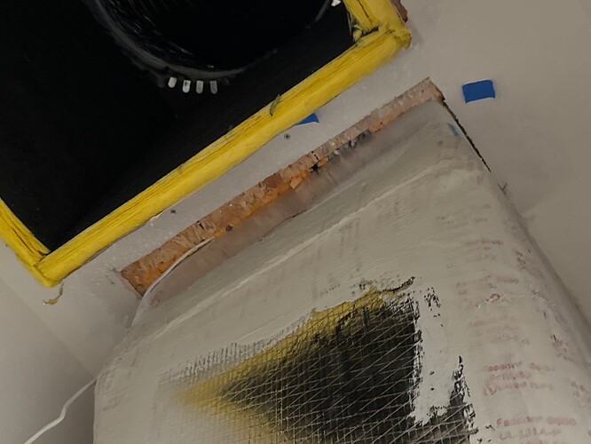

Hello! I was inspecting a new build today and was looking at this HVAC system. I have personally never seen a system done like this, but that doesn’t necessarily mean it’s wrong. The air handler is inside of a closet located in the laundry room. It looks like the return Plenum comes from the ceiling, but doesn’t go all the way to the unit. The air handler has an open bottom with an air filter underneath it. It basically looks like this whole closet sucks the return air in from the ceiling and into the bottom of the air handler. There was no gasket underneath the closet door. If anyone has any experience with an HVAC system installed like this, I would love to hear it!
Based on the pictures you have provided, my WAG is that all the return ducts meet up in the attic and there is a single large duct from that point through the ceiling and into the closet. Therefore, the closet itself is used as part of the return air ducting in this up-flow setup. No seal at the door? Not a big deal. The air handler will pull some return air through there as well. I just wouldn’t want too big of a gap where it would pull all the return air that way. The unit will by default pull air from the easiest place.

Looks like a typical “take as many short cuts as we can” install. No pan under unit, not installed per manufacturer’s installation instructions, return air from closet… etc. Most common Carrier unit in this area are FB4 or FJ4 models. The label on the unit says the unit must be trapped as close as possible to the unit. Get the model number off the unit and check out the instructions.

That filter at the bottom of the unit is a construction filter. It is not big enough for negative static pressure requirement. They do it, but it is not right.

Up flow AHU. I see nothing unusual, except…no air filter and no air filter retainer assembly.
AHU, Up-Flow Air Handler Unit. Seen them in many configurations. Typically/normally/usually in that conditioning curculation configuration, there would be an air filter in a metal screen base at the base of the return duct where that yellow gasket is installed.

He says there is a filter at the bottom of the unit. Up-flow configuration? What is the big hole in the ceiling for? is it pulling down from a ceiling plenum to the bottom of the air handler?
I still want to know what’s going on inside of that laundry room! This closet is depressurizing and so is the laundry room. That stuff in the ceiling we can’t really see but that looks like something from outer space. Can’t say that it looks normal when you can’t see anything from here.

That’s the return, which should have a duct that runs to the outside of the mechanical room or into a hallway depending on the install.
So, in effect, the mechanical room is the return plenum? I thought we had moved on past this in the modern age :slight_smile: Wait until they fill that room up with junk and restrict flow . Then wonder why the home is inefficient, especially when the dryer is running.

The return air duct should be attached to the return air intake on the unit.
I agree, it’s new construction too. There are multiple defects with the installation. Again, what’s the model number? Then apply FBCR 1307.1, 1401.1, 1602.2 etc. Did you put a level on it? If the drain line gets clogged and the cut off switch fails, the house will flood.
