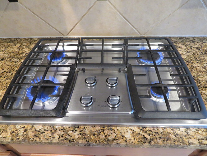

It appears as though the ovens power supply cord is also connected with an extension cord. I believe that fixed appliances should not have any extension cord. Am I incorrect on this assumption?
That is correct for an electric range if that is what you are asking.

It is a stand alone stove top and I assume the plug was for the spark for the gas. I thought it may have been for the range hood but that had a separate plug.

What exactly is that? Is it a free standing range?
At any rate, you should verify what the cord is connected to if your suspect a built-in appliance is installed with improper, temporary wiring.
Oh crap I can see the confusion lol. here is what it is

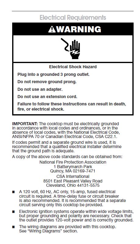

FYI, the product manual will tell you exactly what you need to know, the info is available online through Whirlpool.
And the cooktop has a sticker with this on it:
And that sticker is on the cord on the floor that we see.

Keep it simple, extension cords are not to be used with anything installed permanently – they are only rated for temporary use.

That’s the answer. The NEC specifically prohibits the use of cords as a substitute for permanent wiring.
