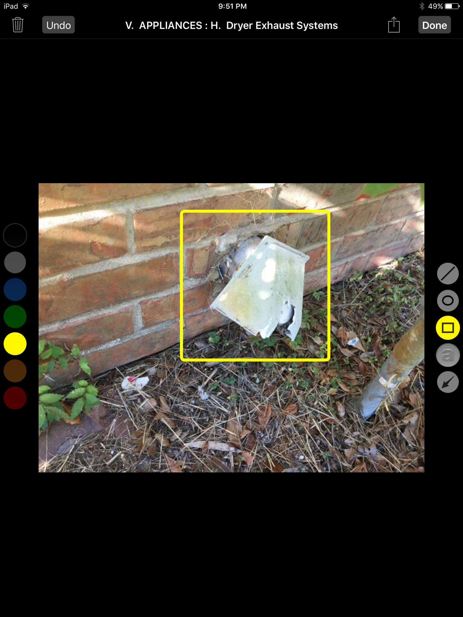

Hey HG Team,
Is there a way to use a stylus to drawn circles and write on the picture (like you see on football play analysis)?
If not, this feature would save me a TON of time. Forget trying to rotate and stretch arrows. I get tense just thinking about it :slight_smile:
Please keep in mind we don’t all use HG the same way. Here in Seattle we “pre-inspections” are very common. Often I’ll do 3-4 of those a day and just need a quick way to convey the main issues. Speed is essential to doing a good (and efficient) job. The less fiddling with arrows, text boxes, and mouse clicks, the more we can focus on inspecting.
Such a (simple) feature would really make HG shine!

I found the item listed below on the HG marketing page:
  1. Sketch Tool: Use the sketch tool for drawing simple sketches or diagrams. Click on the insert picture box at any item to access the sketch tool.
I’m having trouble finding this in my software. Is anyone familiar of where I can find it?
Here’s a link of the HG marketing page where I found it:
https://www.homegauge.com/inspector/home-inspection-software/features.html
It is right there, right click on the picture window in the comment box and click insert sketch, it is used to draw a diagram. Placing arrows and lines in the report is easy, one click can do this. Are you asking for this in companion? I usually do my inspection out in the field and upload, tweak by adding arrows and comments before sending off.

Thanks Shawn! 4+ years with HG and didn’t know that existed. The drag/drop feature in Sketch is exactly what I was looking for in terms of using the normal HG picture editor. I’m writing a report now and keep clicking the wrong tool and not realizing it until I add it to the picture.
And thank you Russell!! Adding a stylus/freehand draw function to HG would help me tremendously in this crazy busy multiple-offer Seattle market. Really appreciate the consideration!

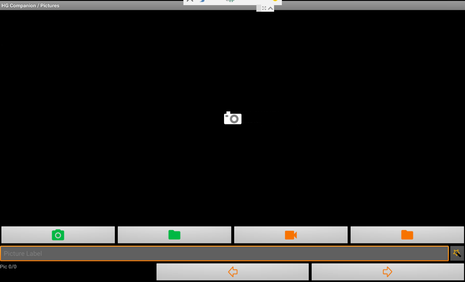

You can do this in Companion too… (Only tried in on an Android Tablet)
1. Add a new comment
2. Click the film roll icon after comment is added
3. Click file folder icon (choose use once when selecting the app otherwise you set this as a default for all apps that use this API)
4. Draw and save, then click on saved file and it is imported in HG companion.
If you need a video to explain a little easier, you can go here: http://www.ontarioachi.ca/wp-content/uploads/HGC-Insert-Sketch.mp4
Hope this helps.
your video is really good Leonard. Can you also open a picture and sketch on it?
Yes you can. You actually don’t need the sketch program for that on certain pen enabled tablets. The Samsung 7 note and 12" pro both have annotation available when you remove the pen. You have to open the photo in a drawing app though and save it back to the same location when done. I’ll do another video to show.
