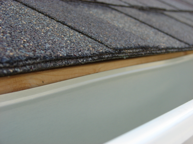

Is Ice Guard an adequate substitute for drip edge flashing? :slight_smile:
No, but it’s better than nothing. :wink:
Like the other side of that house. :slight_smile:
Is there a site/link that has a list of approved flashings and appropriate location/installation details
That is sad, Bill, for lack of spending a couple hundred dollars for drip edge.
Picture four doesn’t even look like ice and water shield.

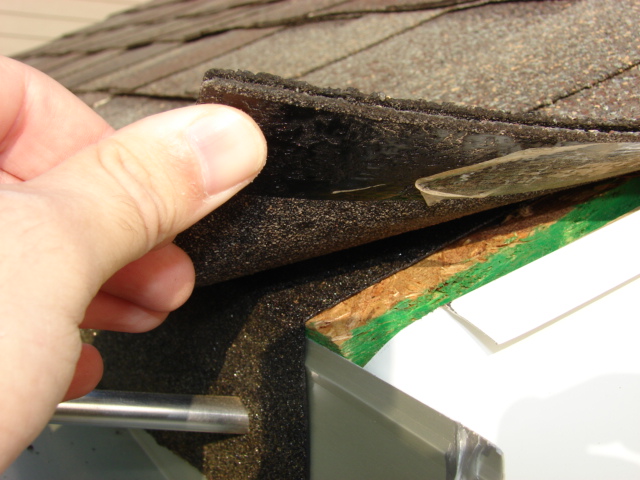

Is the ice shield applied over or under the drip edge? Rake edge?
Over on the eve, under on the rake.
Ice and water shield should be applied under the drip edge and a few inches down the fascia/gutter board and behind the gutter. This protects the fascia board / roof sheathing intersection from ice and water backup. You can always put a small strip over the drip for extra protection.

Dennis, here are the drawings from their site which seem to show the membrane over the metal, but the Grace tech I spoke with told me it didn’t matter. She said you could run the Ice & Water Shield first, install the drip edge, then install a narrow strip over the uphill side of the drip edge to seal it, or install the drip edge first and lap the Ice & Water Shield over the top.

Installed correctly and kept protected it doesn’t make any difference. 30# will resist damage better during installation of the roof-covering mateial and protect the roof longer if for some reason it should become exposed to weather.
