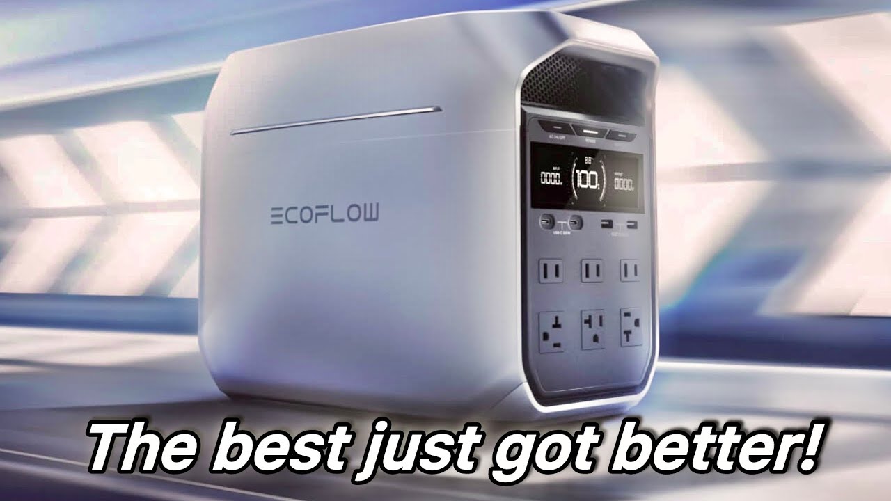

I’ve had my eye on these for a bit and am pretty impressed with the price and performance. Gas generators are great but have some pretty serious drawbacks. Of course, gas as a fuel is fairly easy to transport so it’s definitely a game of pros/cons.
Here’s one a saw at Costco today as a great example:
The main usage would be for my mom (2500 miles away from me) during a storm-related power outage which is somewhat common where she lives. The million dollar question that I still have to determine is how many watts her gas furnace uses and just how long 3600Wh would last (2005 Trane XV90… couldn’t ask mom to actually get #s off the data plate for the exact model - likely smaller BTU as it’s only an 1100sf house). From looking around online it looks like 200-300 watts but it’s hard to say. Assuming 250 watts, it could run for 14 hours which would be great and long enough to wait for power to be restored most times.

The power that comes off those generators is super clean but if you needed 240v, it’s not the right genset.
Grab the folding solar panel for recharging, makes it a better choice for longer outages.
Hey, matt.I just got the older version of the ecoflow delta pro about a month ago.It had no problem running my refrigerator, high efficiency gas furnace, Wi-Fi and house lights for approximately 8 hours. You’ll need a NEMA TT-30 connection. If you want 240V, then you need to purchase another of the same unit, along with a special adapter made by ecoflow. I also have a 400W and 200 W solar panel, When connected in series, I have generated a solar output of 530W so far.

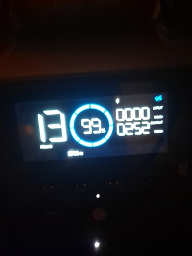

Update - Bought the unit and got it up and running and it works great. I swapped out the furnace service disconnect switch for an outlet and wired a plug onto the furnace instead of the hardwiring.
The Ecoflow unit is pretty nice… shows hours/mins until charged, current watts as charging and the reverse - current power draw and time until dead at current usage. The furnace draws right around 250 watts which is on the good end of what I was estimating. At that rate it should run the furnace around 13 hours which is fantastic.

Overnight update - used 27% of the battery keeping the house around 65. Overnight low was 40, 1100sf house, built mid-80s. R19 attic insulation, R11 walls, crawl w/o insulation.
For some reason today the furnace is pulling 350 watts. I guess last night it wasn’t running at the highest stage so the total run time might not be quite as long as I thought. I’m thinking at least a couple days though. Still very happy with it overall.
