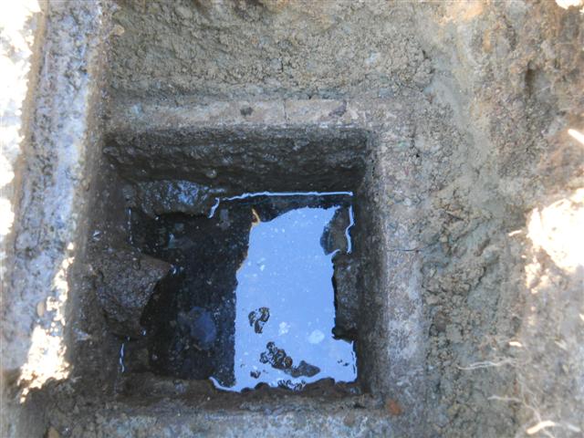

From yesterdays inspection. 8 Year old system failed!!!

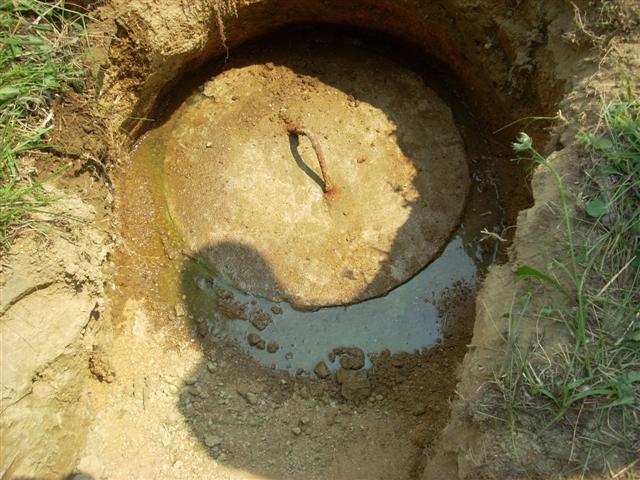

Back up through the tank cover while conducting the flow test.
Another good reason to dig up the tank and pull the cover. Both the inlet and outlet baffles are covered and not visible.

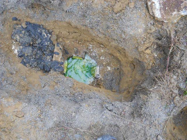

Yesterdays inspection. 24 year old stone and pipe system. I couldn’t believe the condition of this system, it looked great. However, I dug up the D-Box and found that over the years water and soil have penetrated through the cover and a layer of sludge has built up in the bottom and the outlet cover for the tank was broken.
Started to run some water in the basement laundry utility sink and when I checked the treatment tank no water was coming into it. Saw the drains go through the floor and decided to investigate. Found the discharge pipe about 40 feet from the house dumping the laundry room waste into the woods, and this is conservation land!!!
Another good reason to find and dig up the D-Box
Over all a good system but needs, tank cleaned with sludge removal and new cover, replace D-Box, re-plumb laundry so it goes into the sewer system.

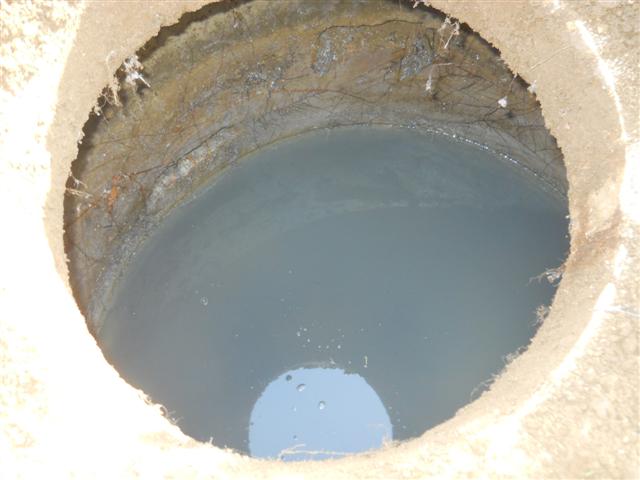

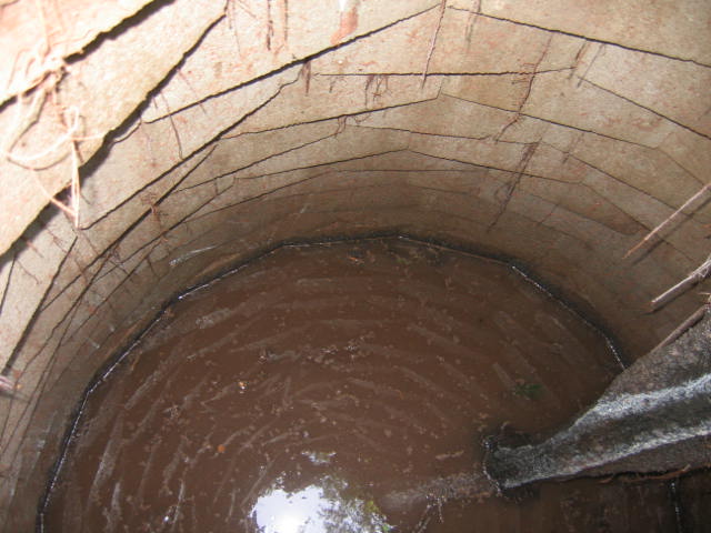

Here is a recent inspection of a dry well system. Home was built in the 1960s. A permit search revealed the dry well was replaced in 1983, (without state approval) and is now in failure. Didn’t even get to the cover before it filled in my inspection hole.
What NH calls a dry well is basically a pit with gravel?
For the most part. Usually there is a treatment tank and then the dry well. Some older dry wells were basically 55 gallon steel drums with hole punched in them.
Dry wells are the early form of a leach bed or EDA.
Most from the 60s are concrete blocks stood on end in the shape of an octagon. The bottom and outside perimeter was backfilled with stone. Problem with these type systems is they require greater height above the water table.
These systems were the basis for the stone and pipe systems that came later.

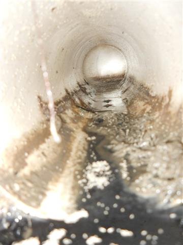

Yesterdays inspection of a 35 year old stone and pipe system. EDA was overgrown as usual and small roots were penetrating the D-Box. Once uncovered the D-Box and laterals looked good. After digging two inspection holes in the EDA and completing a load test the system was found to be functioning as intended with many years of service still ahead of it.
Note the staining on the sewer laterals leaving the D-Box. No flooding or back up are evident. Had th EDA flooded and backed up into the D-Box the staining would show higher up inside the lateral.

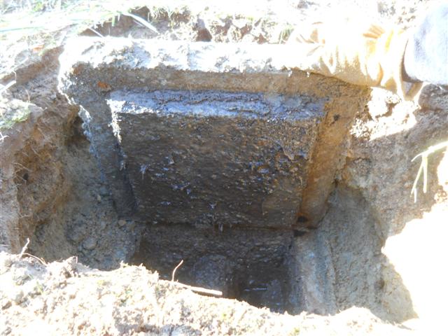

Here’s one from the other day. Permit search revealed the system was replaced in 1988 and is a non-engineered, home owner installed system.
Tank has not been pumped in years.
Covers to tank are broken.
D-Box is completely deteriorated and has collapsed upon it’s self,
I was able to clear enough dirt/sludge out of it to continue my evaluation but the system needs upgrading.

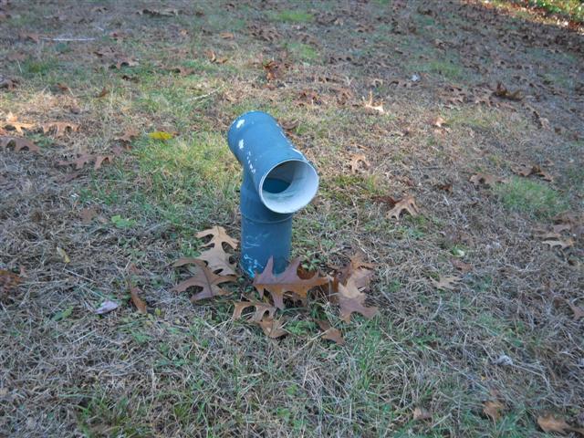

Had the you know what scared out of me today when I pulled the cover off and found this. The screen is missing off the end of the vent and I think he was storing his acorns in the drain line.

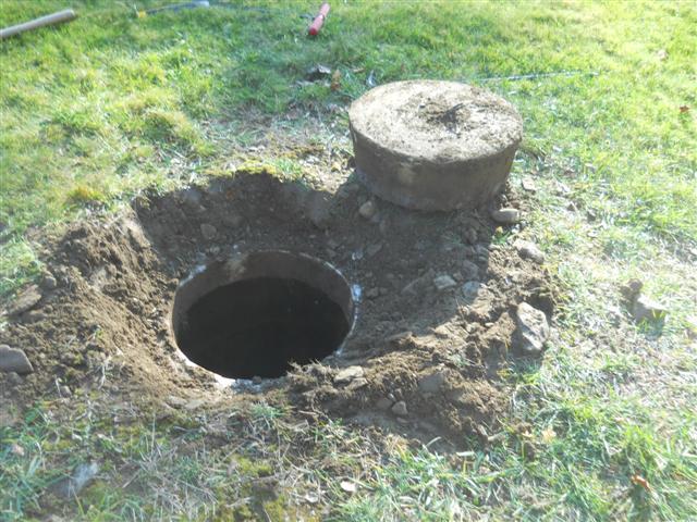

Below is an excellent example of a typical drywell that is found during a New Hampshire septic inspection.
