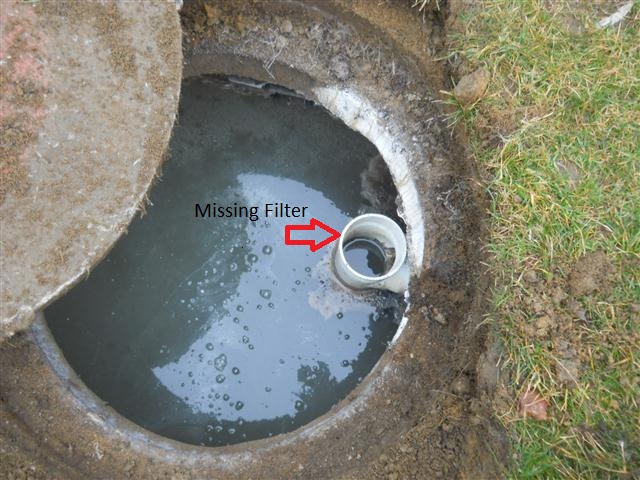

Think you don’t need to inspect a new septic system? Here’s one from a three year old home.
What was installed was not what was designed. Only 7 laterals instead of 9.
Effluent filter missing from treatment tank.
Flow diverter missing from 1 lateral, resulting in this area of the EDA to be flooded.
Overall poor job on finish grade.

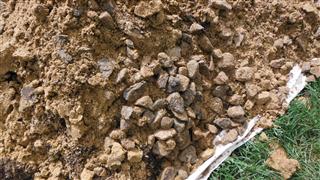

Here is a good example of a 25 year old stone and pipe system. This system was rated as in good condition. Note that each inspection hole had clean sand and stone with no staining, indicating that this EDA has never backed up or flooded. Also noteworthy is the unrestricted flow in and out of the D-Box.
