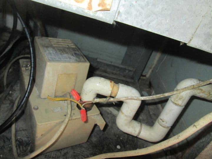

4) Inspect this please… .. …

  4. condensate removal pump; all splices should be made in a junction box.
AC air handler condensate pump with exposed, wires

Those wires are Class 2 control conductors for a unit shutdown if the pump fails and they are permitted to be spliced in free air. The white cord is likely powering the pump.
