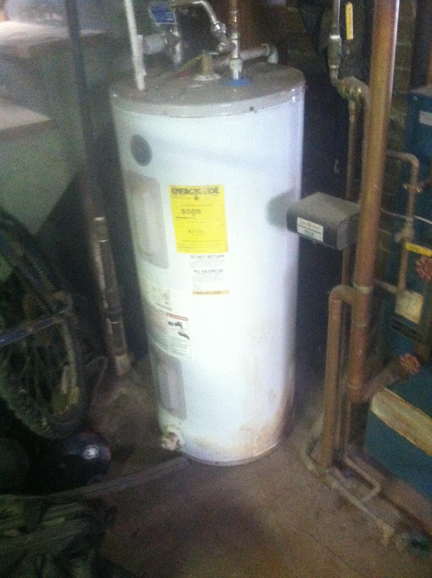

These are pictures of an electric water heater I inspected. The TPR valve shows no sign of a leak. There is a mixer located at the supply and feed designed to protect against scalding. The electrical ground is properly connected. The covers over the heating elements show signs of a leak but there is no moisture. The supply and feed lines are clean and no signs of leaks. The water heater should be serviced annually by a qualified contractor.
