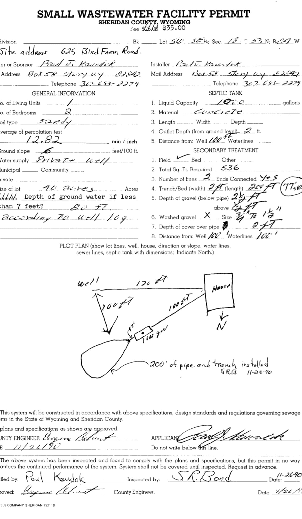

So, I ran 240 gallons into the septic tank at rate of 6 gallons per minute for 40 minutes. Before starting test effluent was 88 inches from top of pvc riser, upon completion of test effluent was 77 inches from top of riser. I recommend pumping tank, and having it inspected to determine if concrete tank installed in 90 was leaking or drain field is backing up. House has been unused for a few years what do you think the problem is?

Well, if it was leaking it would not be rising up the riser.
I was curious if it was leaking before the test, as the house had sat unused, and was rising to the level of the outlet.

It is possible it’s evaporation , but I would expect the majority of evaporation would condense on top of tank. The diagram shown above is not what was inspected, this was a concrete tank with baffles.

The diagram shown above is not what was inspected, this was a concrete tank with baffles…
I understand that. But the principle is the same I believe. Just trying to understand why a rise in effluent would indicate a failed test and what the expectation should be in case I ever add this service to my company. Do you verify that the pump runs and how often during the test or did this system not have a pump?
It was a gravity system, I set the flow rate to just above where the well would not cycle on and off. I use a water meter to verify flow rate, and gallons used. I run it from a hose bib to an outside clean out.
Since the system has sat unused for a few years, it would seem like you would need to know the size of the tank to determine if any of the water you added made it out of the tank. That or you have to run so much water that it is obvious it is making it out, or not making it out.
How thick was the scum layer? The solids layer? Did it have a filter? Was it evaluated?
Scum layer was 4.5 inches, I did not measure the sludge.
And no filter.
