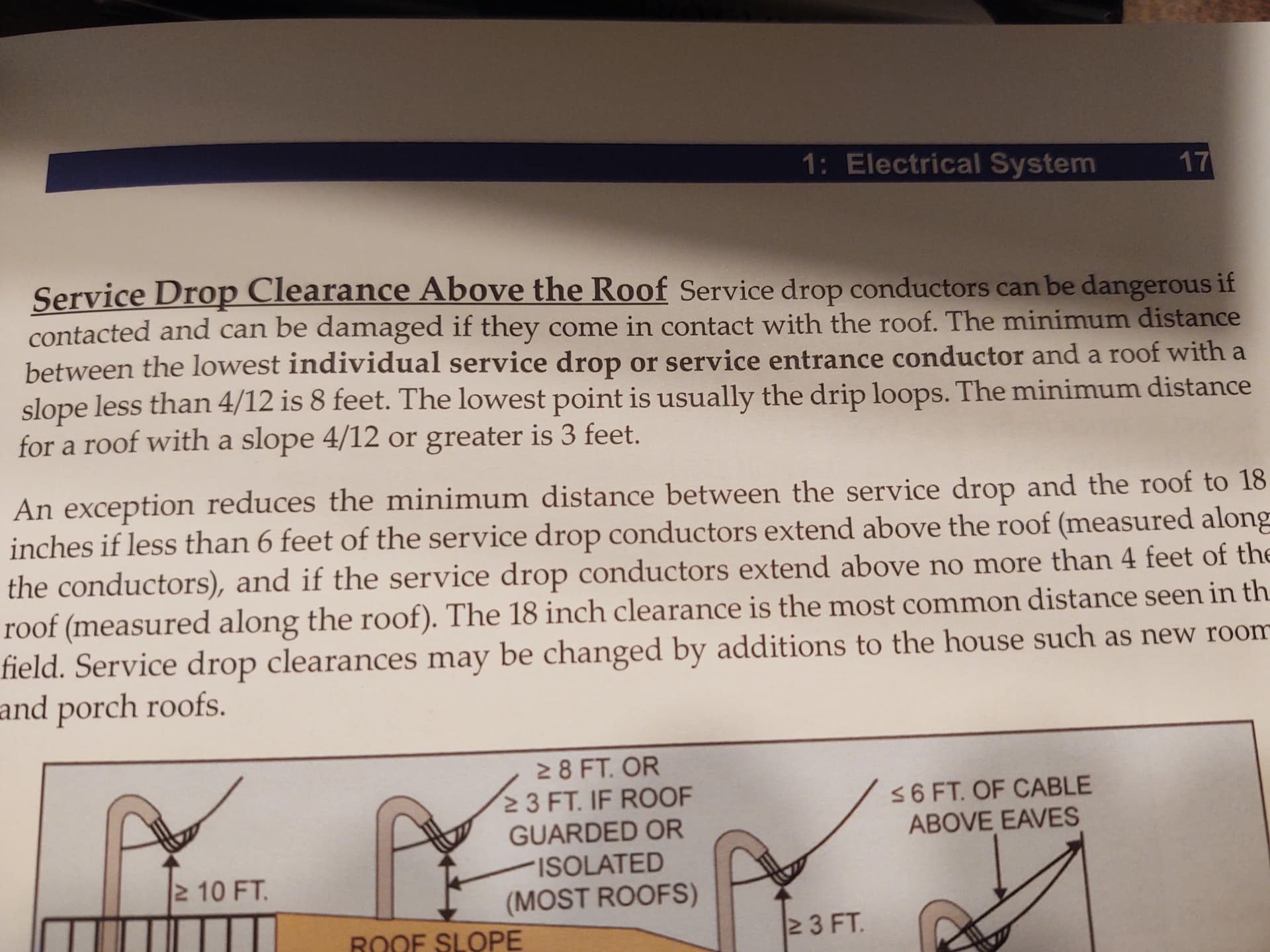

I have a question slightly related to this from the NHEI I am studying for. Here is a practice question I was given and their correction.
I am looking for more information on their correction as the question specifically asks about a flat roof subject to foot traffic.
I referenced the NHIE Mechanical Systems & NHIE Content book and found this example,
Can someone help me understand why the clearance in the question only needs to be 8’ above a flat roof instead of the 10’ like what would be needed from a deck?
Also, what constitutes a “Guarded or Isolated” Roof?
When you have a folks over for a diner, how many stand on a roof?
Because the question was asked about a roof not a deck?
Larry has it. Not all foot traffic is pedestrian traffic. Not all flat roofs are roof decks. Tricky tricky those folks!
BUT… is that the ‘BEST’ answer??
Well, considering the question did not mention roof deck or pedestrian traffic and was not guarded or isolated (foot traffic), I would have chosen 8’.
Let’s answer his questions:
A flat roof (not a deck that people have drinks on) will almost always have some foot traffic. Often for HVAC maintenance etc. A guarded roof section prevents foot traffic by isolating an area with a guard or fence. (often you will see a hazard or safety sign attached to these guards)
A roof deck (which people hang out on) has pedestrian traffic which means the general public or tenant. The service wire must be 10’ above them so they cannot reach up and touch it like stupid people do.
Recent inspection. Blue is roof deck for pedestrian traffic. Green is flat roof (has foot traffic but no pedestrians)
That’s a sneaky one and really makes you think about each of the words in the question. The OP should definitely not feel bad about getting tripped up on that one! Thanks for clarifying it for us all Brian!
