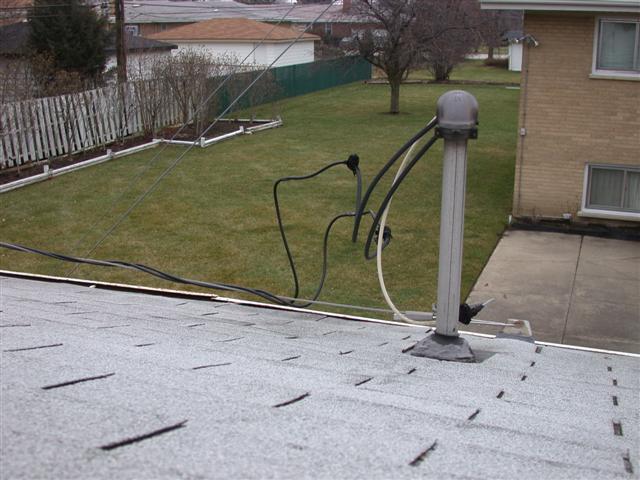

The mast seems to have the required 18 inches but anyone know off hand how much clearence from the roof the conductors should have.
It is only about two inches.
Off topic question, was the seal broken on the meter base?

Not concerned about the masthead, but rather clearance of the lines from the gutter.
What is the rule from the NEC?

For that type of service drop the best infomation will be from the POCO they have pretty spefic detals on the service drop connection and where to mounted to the sturcture or on mast.
As far i am looking at the photo if this place is above the second story or second floor hightwise it should be ok but i wish there is other photo seeing at diffrent angle but the hevey angle iron bracket if lagged bolted or thru bolted to the actual stucture it is ok but on the sheeting plywood or OSB etc ] not a really pratical idea becasue few POCO did stated a warning especally with semilong run the line tenstion can be pretty hard on the bracket keep in your mind this true with snow/ ice belt area ]
and let me add the last comment here if it is above the window and away from window there is no issue with that.
but again please check with your POCO for most recent regulations for your area.

Just to restate ,I am mainly concerned with the two hot s touching the gutter if they sag.
Here you go! Looks like that connection was temporary, or iy may have been a job with no permit?
Thanks Joe .
I know 18 inch rule applies but from the PDF I seem to gather it applies to the conductors in the service drop.
Is that correct?
That’s automatic because of the drip loop that is also required to meet the clearances. Did you note the overhand rule?
Defect contact the utility and ask them to reconnect the service drop and make it look like the picture here from the handbook.
