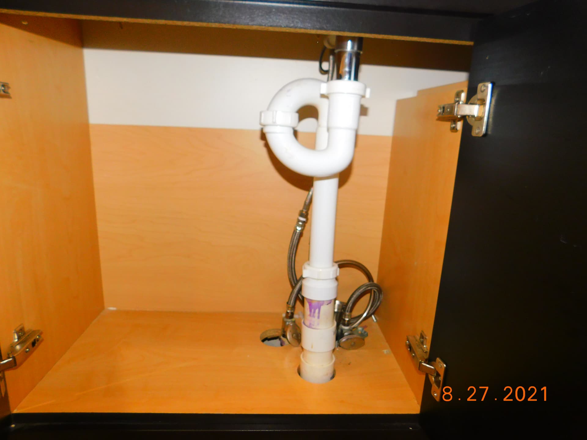

SO, what alphabet letter trap is this?
P- No
S- Maybe
Q- No
Still an s trap

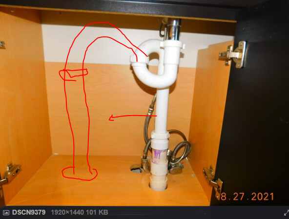

Yes, if you were to swivel the vertical pvc pipe out then you can see the S
Correct, I have this graphic (up for NACHI approval) to illustrate
Crude but very nice graphics Brian!

I do a lot of older homes and see s traps all the time. Had them in the house I grew up in. Worked fine for years. All you can do is report why they are no longer used. Don’t expect much, it’s not a simple fix.
replacing a S trap with a P trap
Sorry, hit send before adding the question, is this a proper fix? Seems easy enough, but maybe too easy.

If looks like an S trap does smells like an S trap. It’s a flip in s trap…

Should be able to install a AAV valve if your area allows them.
