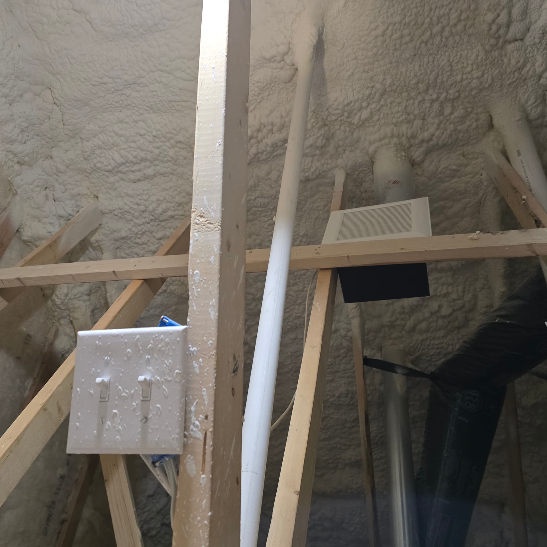

I came across a new construction home with sprayed polyurethane foam applied to the roof sheathing. I suspect it is an open-cell product rather than a closed-cell. My question is regarding a bathroom-style fan installed in the attic.
Situation and info:
  • New construction in Colorado, Zone 5
  • This is a 1-year warranty inspection
  • There is no attic ventilation (soffit/roof/ridge etc.) due to a conditioned space (Encapsulated)
  • A bathroom-style fan in the attic terminates to the exterior of the rooftop
  • The fan switch is located in the attic
  • Access to the attic is a ceiling hatch which will require a ladder
  • The fan was shut off at the time of inspection
  • The fan switch does not appear to have a thermostat
  • The fan has a module for CFM and Time only
Questions:
  • Where is the fan drawing air from? There are several small gaps around the can lights, but wouldn’t that cause debris collection around it from air intake?
  • Why is it not automated with a thermostat?
  • Why is it so difficult to access? The homeowner had no idea it was even there! (single person with no need for a ladder)
  • Should the fan be turned on 24/7?
  • Why is a fan even necessary? I know airflow is good, but how does it work in this situation?
This is my proposed narrative and I am looking forward to critiques.:
The attic was insulated with spray foam applied to the roof sheathing. This approach can create a conditioned attic space, which, when properly sealed, eliminates the need for traditional ventilation. However, an attic fan was present, which is unusual for a conditioned attic. If the attic is intended to be fully encapsulated, the fan may be unnecessary or even counterproductive by introducing unconditioned air into the space or expelling conditioned air to the outside. The fan switch is located in the attic, which is impractical for manual operation, and it does not appear to be connected to a thermostat for automatic control. I recommend consulting the builder to determine the intended function of the attic fan and whether it is needed in this setup.”
Geez, I am overthinking this, aren’t I?
Spray foam insulation with no provisions for some type of ventilation have been found to be problematic. The isolated switch in the attic would most likely go unused by the average homeowner. Here is an old article about the subject:

Yep
Send them back to the builder for design plans and explanations.
An exhaust fan is not the greatest way to ventilate an encapsulated attic, but it may have met the AHJ’s requirements. You could recommend a timer be added. I’d also want a way to verify from outside the attic that the fan is operating. But if it were mine, it wouldn’t be done this way. I would install an HVAC supply and return for the space.
This is required for it to be considered a “Conditioned Space”.
An ‘exhaust fan’ alone does not meet the standard.
I’ve run into one and familiar with another attic where the two-part foam was not mixed/combined properly and was off gassing toxins. I recommend an air quality test if there is a return air vent in a spray foam insulated conditioned attic.
