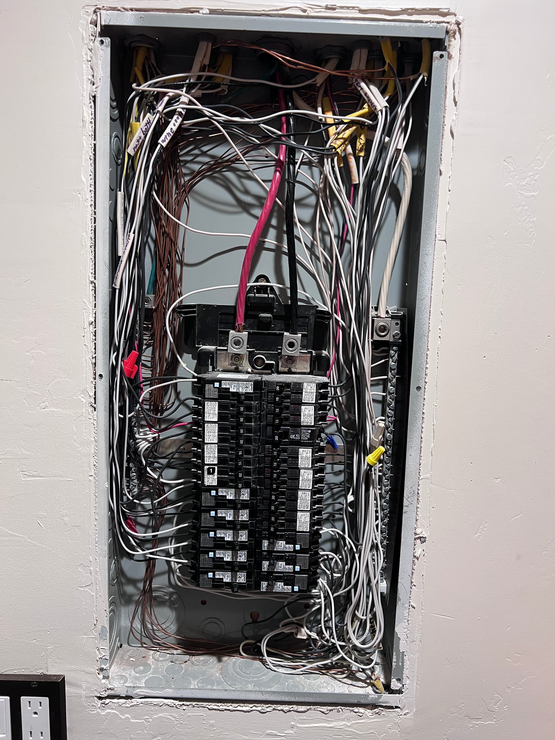

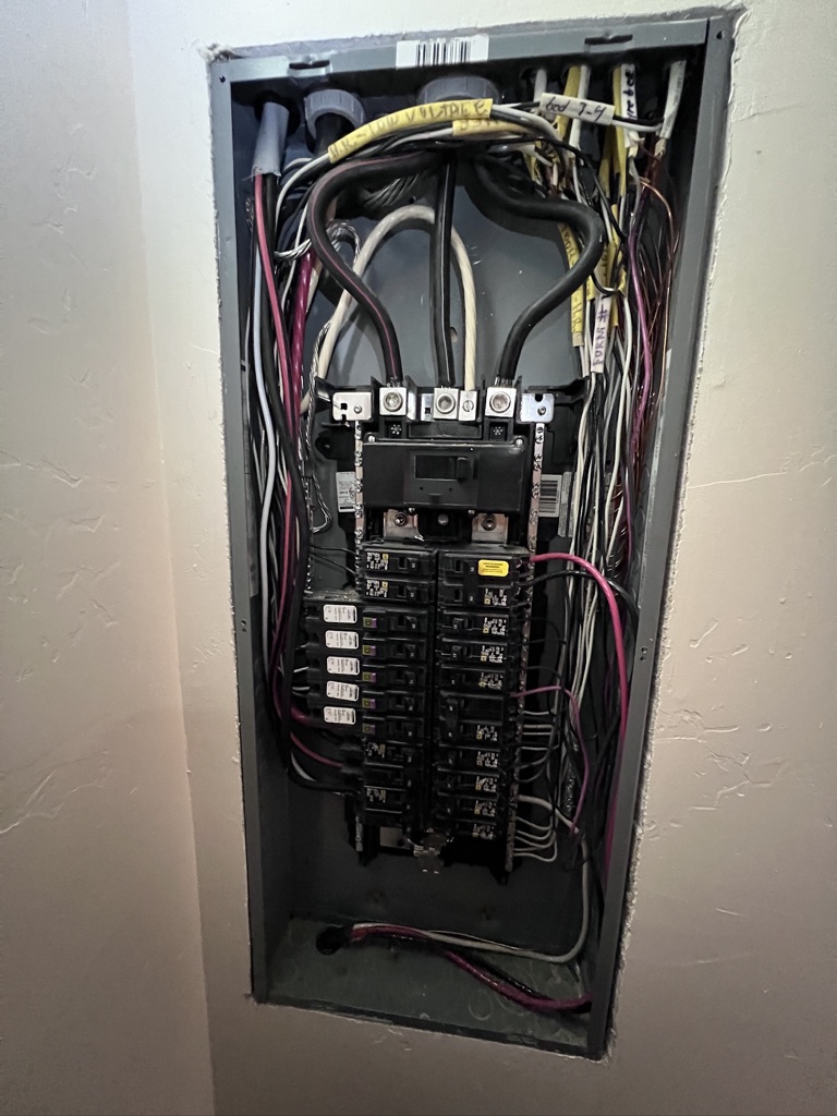

Service panel has 100 amp breaker feeding an interior distribution sub panel. The feeder wire appeared large enough to feed 200 amps. To fit the 100 amp breaker, they cut the aluminum strands. I’m noting that as a defect and that is in picture 1 & 2. I’m noting the non re-identified white wires being used as hots in service so my concern isn’t about some of those obvious issues.

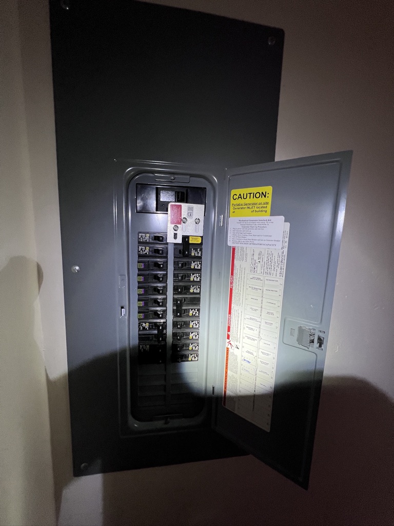

The first interior distribution sub panel (third and fourth picture) that that wire feeds has a 200 amp disconnect (I’m confused why they did it that way) and also has a 50 amp generator back-fed breaker (for power outages) and a lockout mechanism so utility and generator won’t be operational at the same time. Good.
Why the 200 amp disconnect in the distribution panel that is fed by a 100 amp breaker?? Is it for a specific important reason? Its not something I would mention as wrong but I’m really curious why they did it that way. I’m noting the cut neutral strands on the wire on neutral bus so no need for your comment on that one either. This panel also feeds another 100 amp sub panel (fifth picture) and didn’t notice any issues with that setup.
Are the cut strands in the service panel the only defect as far as this configuration goes? Is the first distribution panel considered a “main breaker load center” or just “breaker load center” with the 200 amp disconnect or what would I call that in my report? Or, is it even necessary to describe the panel type as it doesn’t state that its required to do so in our SOP? The sub panel with the 200 amp disconnect appropriately has the neutrals/grounds separated.
