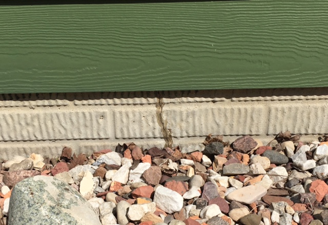

As I walked around the outside of the home I noticed only one crack in the foundation in the attached garage. It is all the way through. I see some sort of caulking in and around the crack on the outside to prevent water from getting in and freezing causing it to expand.
