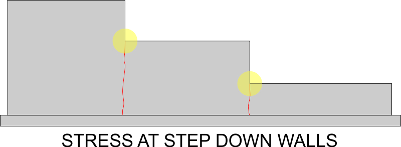

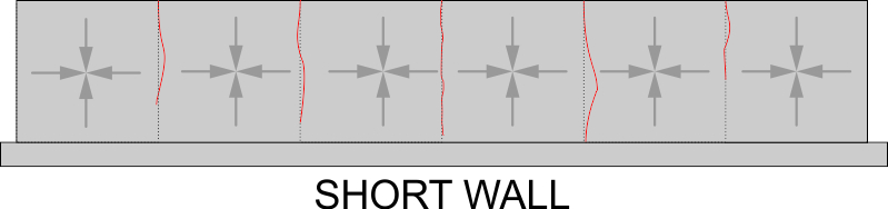

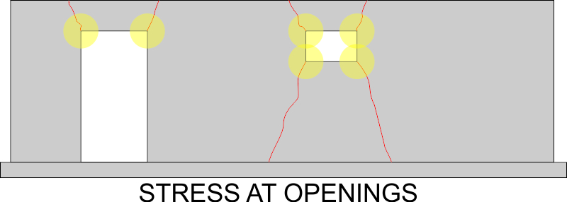

Most shrinkage cracks occur at predictable locations in concrete walls. Concrete shrinks uniformly in all three directions, height, length and thickness as it cures. The effects of shrinkage in the wall thickness direction can be ignored, just concentrate on shrinkage effects on the height and length of a foundation wall. As concrete cures the shrinkage forces start to grow in all directions until it reaches the tensile strength of concrete, which is very weak compared to compression strength. Concrete as it shrinks naturally will crack at uniform intervals unless the geometry of the wall or slab causes stress concentrations to occur. In walls, door and window openings, abrupt changes in cross section like in a step down foundation wall all create stress at the corners. The first two pictures shows shrinkage cracks occurring uniformly at locations where the walls are sectioned into blocks where the length is equal to the height of the wall. Once wall openings or changes in wall height occur stress concentrated at the corners, highlighted in yellow, will force shrinkage cracks to occur at these locations first. There are other factors such as reinforcing and interaction between the wall and footing joint that will impact the generic locations I described, but in general you can expect cracking as I outlined. As a side note once a shrinkage crack occurs any future foundation settlement will likely cause an existing shrinkage crack to widen (typically at the top), basically the wall was already broke.
