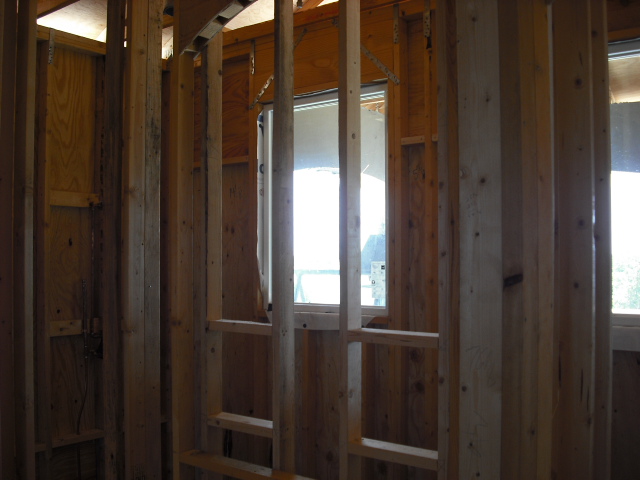

Any inside pictures of the windows?
These are the only two I have now. I will be going back to the home this week.
The second one looks like the tyvek is pulled behind the window nail fin on the top.
If that is the case that is wrong also.
