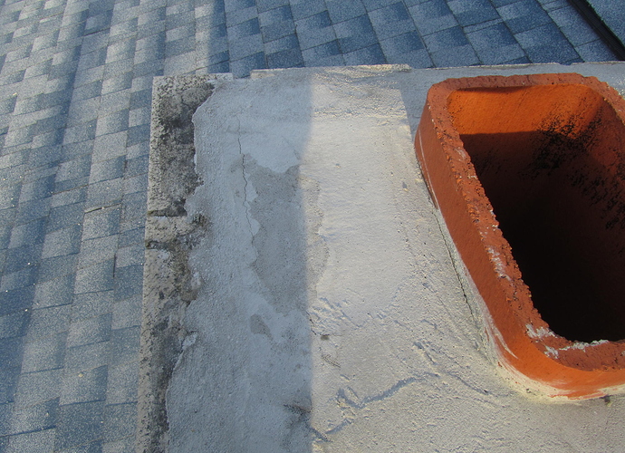

The crown on this fireplace chimney is deteriorated and cracked. The crown was possibly constructed with an inferior mortar mix, which has deteriorated from the weather. The cracks in the crown can allow moisture to penetrate into the chimney and flue causing a serious risk of further damage and poses a fire hazard. Repair or replace the chimney crown with a concrete crown that overlaps the masonry and slopes away from the flue opening.

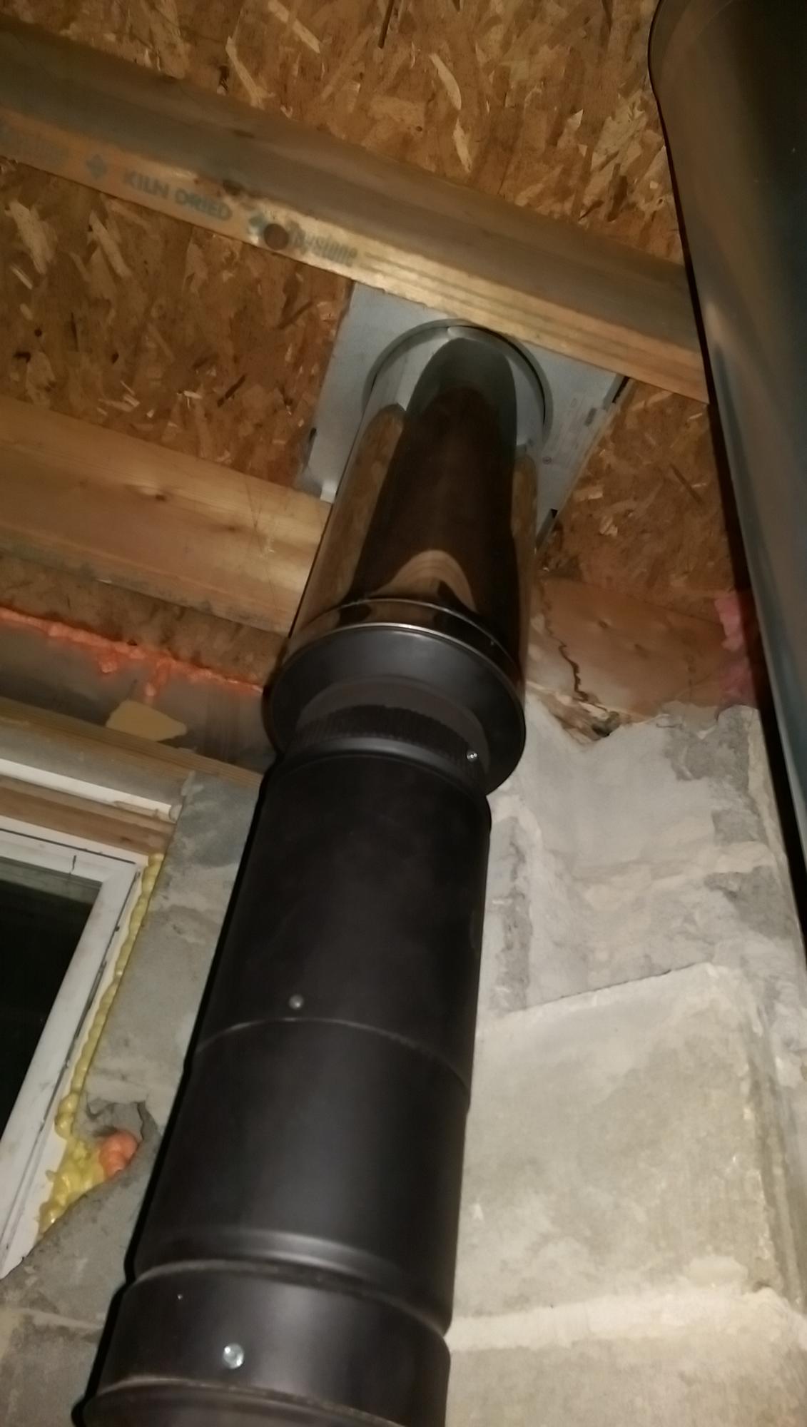

Add on wood burner in basement. Chimney from add on is black double walled, non insulated pipe transitioning to a stainless steel insulated pipe 20 inches from nearby combustible materials. A metal insert is around pipe where it passes through the floor, leaving a 2" space around the pipe. Recommend a certified chimney sweep inspect and clean the chimney if add on wood furnace is to be used.
