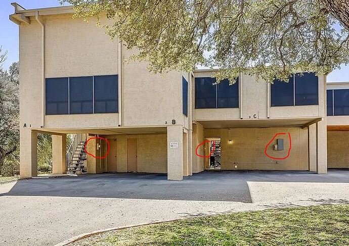

I did an 80’s condo like this yesterday. Each unit had a meter outside, but only some of those meters had a main switch added. My unit did not. I called it out.
Interesting, do you have any photos?
I neglected to take exterior CYA images unfortunately, I’m walking around on a healing fractured toe, so I was trying to get home. But I found it in listing images. The two red circles on the left are meters only (the middle one was mine). The meter on the right has a panel added with an integrated shut off.
I assumed there would be an exterior main shut off and initially labeled the interior panel as a sub, but had to switch things around after poking around outside. Only a meter.
