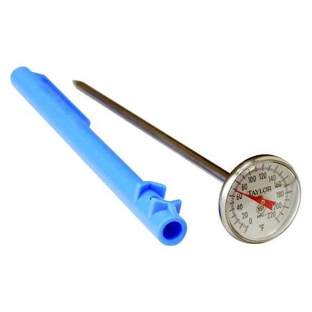

Yep! I use a what I call a needle thermo.
It is easy that way.

If the unit has been running for ten minutes or more, the thin metal fins of the typical residential registers will be close enough to the temperature of the air passing across them for initial analysis. If I see a DeltaT of at least 14 degrees at the registers (using a non-contact thermometer as in the original post), experience has shown me that I will find at least that (and usually better) if I test at the unit itself. If it is lower than 14 degrees, I will test at the unit (using two calibrated probe-type thermometers). If I am getting less than 15 degrees DeltaT, I note it on my report and refer the client to an HVAC tech. Most of the year in Texas, attic temps are higher than living space temps, so there is almost always temperature gain in the ductwork during cooling season.

If he got a good differential using that method, wouldn’t you think it would be even greater if measured at the unit by inserting a thermometer? Performing an exact measurement is beyond the scope of a home inspection. I do exactly what he did but I don’t mention differential unless it is low.
A test a HI inspector goes through is a bare bones , without proper gauges and hour testing , you not testing for proper the operation . You can say it is operating or it is not . Carry on boys . Taking temperatures and Humidity is about all we can do .
