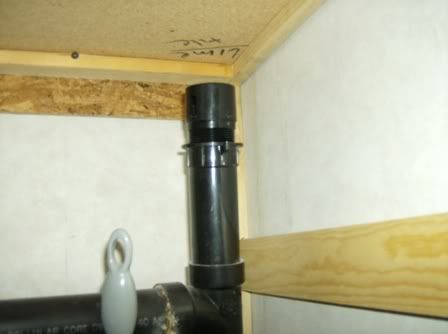

I have to agree with Jeff about the wet vent. I don’t see how an AAV set up could be considered “wet vent” JMHO
“When” i quit? You tryin’ to tell me something?
Just curious - since I have not encountered this yet. What would a monthly inspection of an AAV entail, and are all of them terminated in observable areas, or are they also hidden within walls behind cabinetry (for example)?
When I built my addition a few years back, to include laundry room, the AHJ told me to plumb in an AAV that was to be hidden in the wet wall. He signed off on it with no problems and the drain works wonderfully.

Your AHJ aside I thought they needed to be accessible for inspection.
How else would you know you had one or if it was functioning correctly?
Any other opinions on this?
Correct. They are required to remain accessible. The AHJ made the wrong call.

Don’t forget that a HI is not a code inspector. Is the drain working properly? If so, move on. It’s really of no concern if it meets code or not (I’ll probably take some heat for that comment) as long as it operates properly.

Because they are so easy to damage, and because they fail quite often in my neck of the woods, when that happens, it is quite common for moisture damage to occur in the area of the AAV. After all, the moisture is only four inches below the “wet vent.” And undetected moisture leads to mold growth.

This is a portion of my narrative for AAV’s
AAV’s are a mechanical component, and as such, they are subject to failure over time. Failure of these mechanical vents may allow sewer gases to escape into the living space which would result in potentially hazardous and unhealthy conditions. If, at any time, you notice an odor consistent with waste or sewage, you should immediately contact a qualified plumber to evaluate the AAV.
To the best of my knowledge, they are supposed to be “readily accessible” or some such term. So a monthly inspection would be to look at the thing and make sure there is no moisture damage and mold growth in the immediate area. And for sink cabinets in bathrooms that are rarely used except when son comes home from three months away at college, open the cabinet and smell.
Other than localized moisture damage, mold growth, and smells, I don’t know. But those three items usually do it for me.
Well, yes and no.
Yes, we are not code inspectors, but the codes form the very foundation of our work. And we all know that the codes are merely the minimum requirements upon which to build something.
The AAV is supposed to be four inches above the joint with the drain. Do I call it out if it is 3½ inches? No, I don’t. Do I even pull all the storage and chemicals out of the sink cabinet so that I can actually measure it? No, I don’t. Do I educate my Clients about what they are? Yes, I do. I believe it is that education that will keep me out of court.

The drain-waste-vent system (DWV) employs a mechanical vent, also known as an air-admittance valve or AAV. This application may have been approved by this local jurisdiction, however, you should be aware that this type of system is not recognized by California Building Officials as an approved plumbing-vent system. Although they may function as intended, AAV’s are a mechanical component, and as such, they are subject to failure over time. Failure of these mechanical vents may allow sewer gases to escape into the living space, which would result in potentially hazardous and unhealthy conditions. If, at any time, you notice an odor consistent with waste or sewage, you should immediately contact a qualified plumber to evaluate the AAV.
