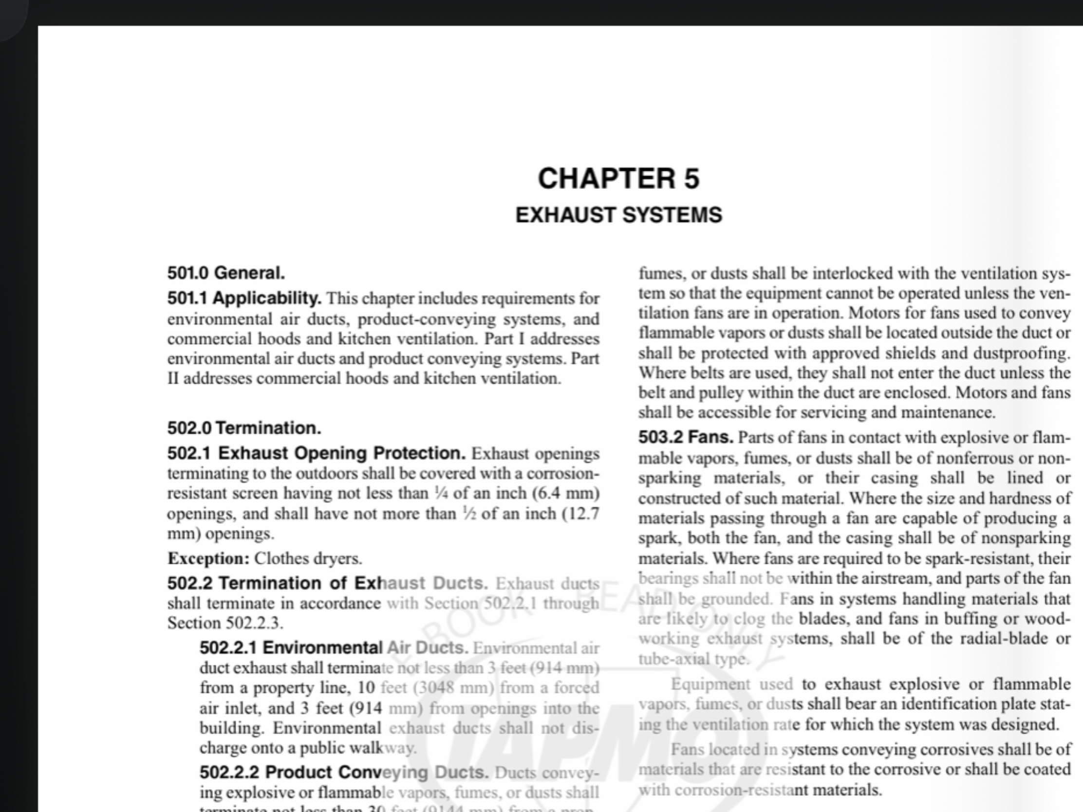

From the 2018 Uniform Mechanical Code Book section 501.1. I’m not sure what code book you are using. I believe your quote came from the ICC not an American Code book. Every jurisdiction has codes adopted from the UMC and put their own spin on it. I still don’t see a specific code for water heater size based on bathroom or bedroom quantity. It’s not like sizing a septic and there is no hard number unfortunately. Thanks for your expertise.

California code bro. Remember what I said about local jurisdiction. I’ve been a Chicago plumber and the codes are different in every city and county in Illinois. I have held a license in two states and currently have a plumbing contractors license. California has a separate plumbing code as well. The Uniform Mechanical cold is the baseline for local jurisdiction codes. Local jurisdiction can increase a code but can’t decrease the code. Best to stick to quoting codes for your local jurisdiction if you dare. I would not recommend it as a home inspector. You might run into a guy that know a thing or two.
I did a search on the link you sent for my current state and guess what…zero reference to sizing a water heater. Be careful when you enter a contractors swim lane and start throwing codes around. Just friendly advise. Codes are often amended and updated. I can’t emphasize enough how we home inspectors must never quote codes. I will rarely call out a code violation unless it endangers the safety of the occupant and even then I recommend a licensed contractor evaluate the violation as I cannot fix it according to my code of ethics. Putting this one to bed.
