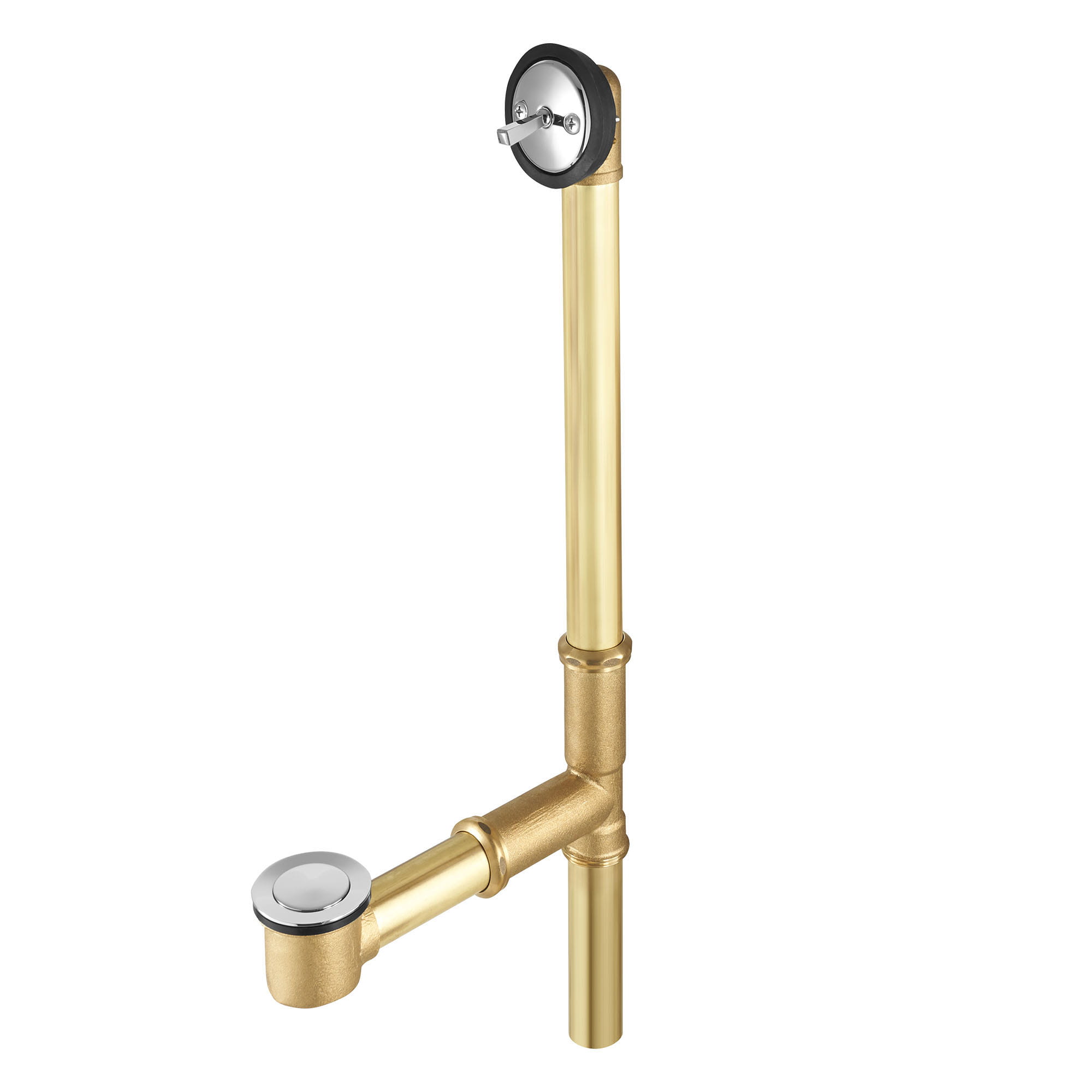

Typically, the tub stub-out is in a box and skim coated over with the concrete. So, this will fit:
